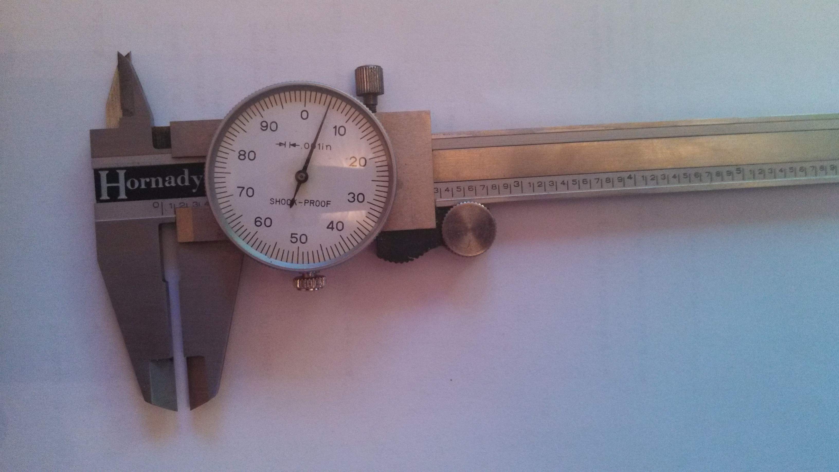

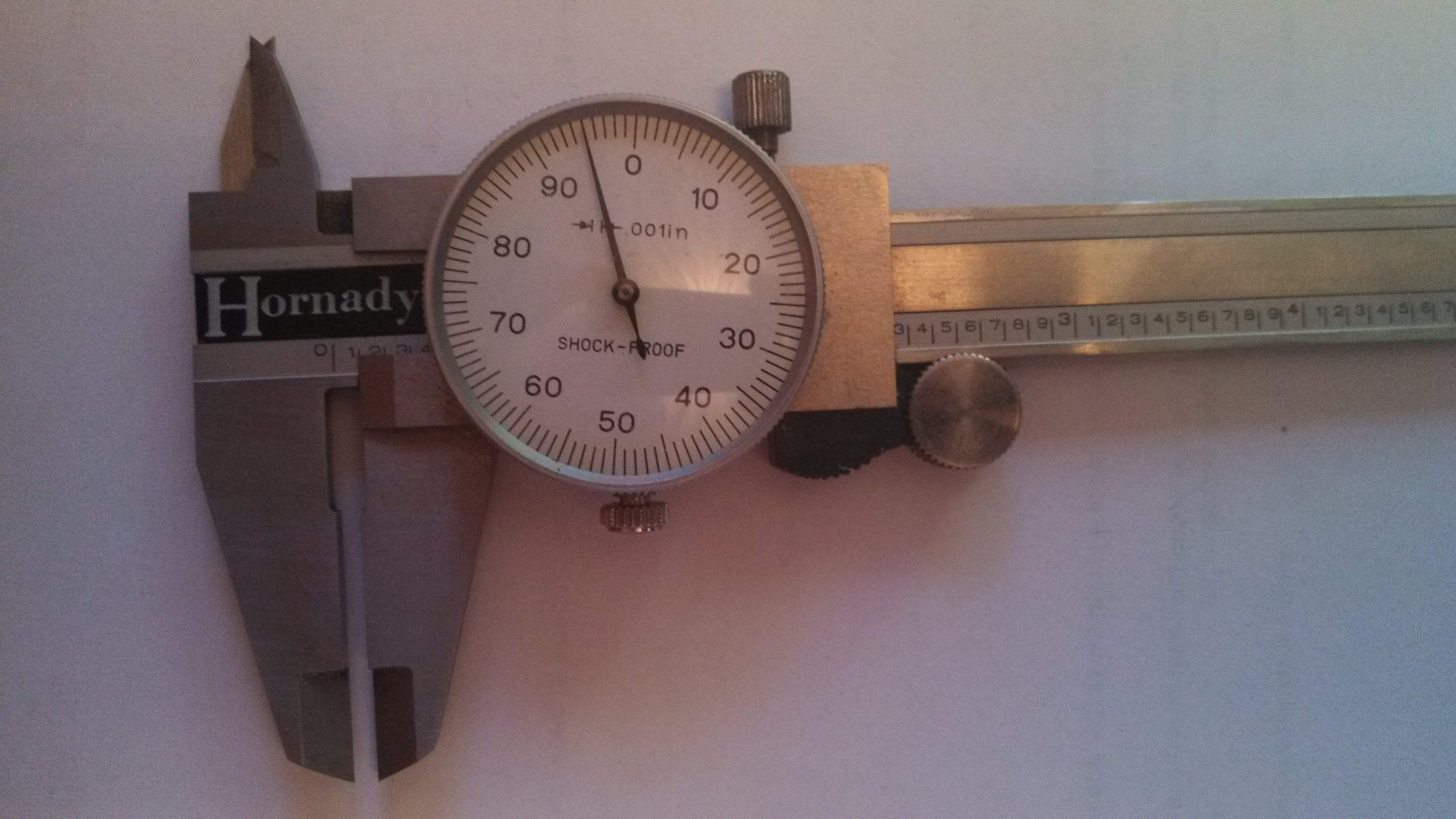

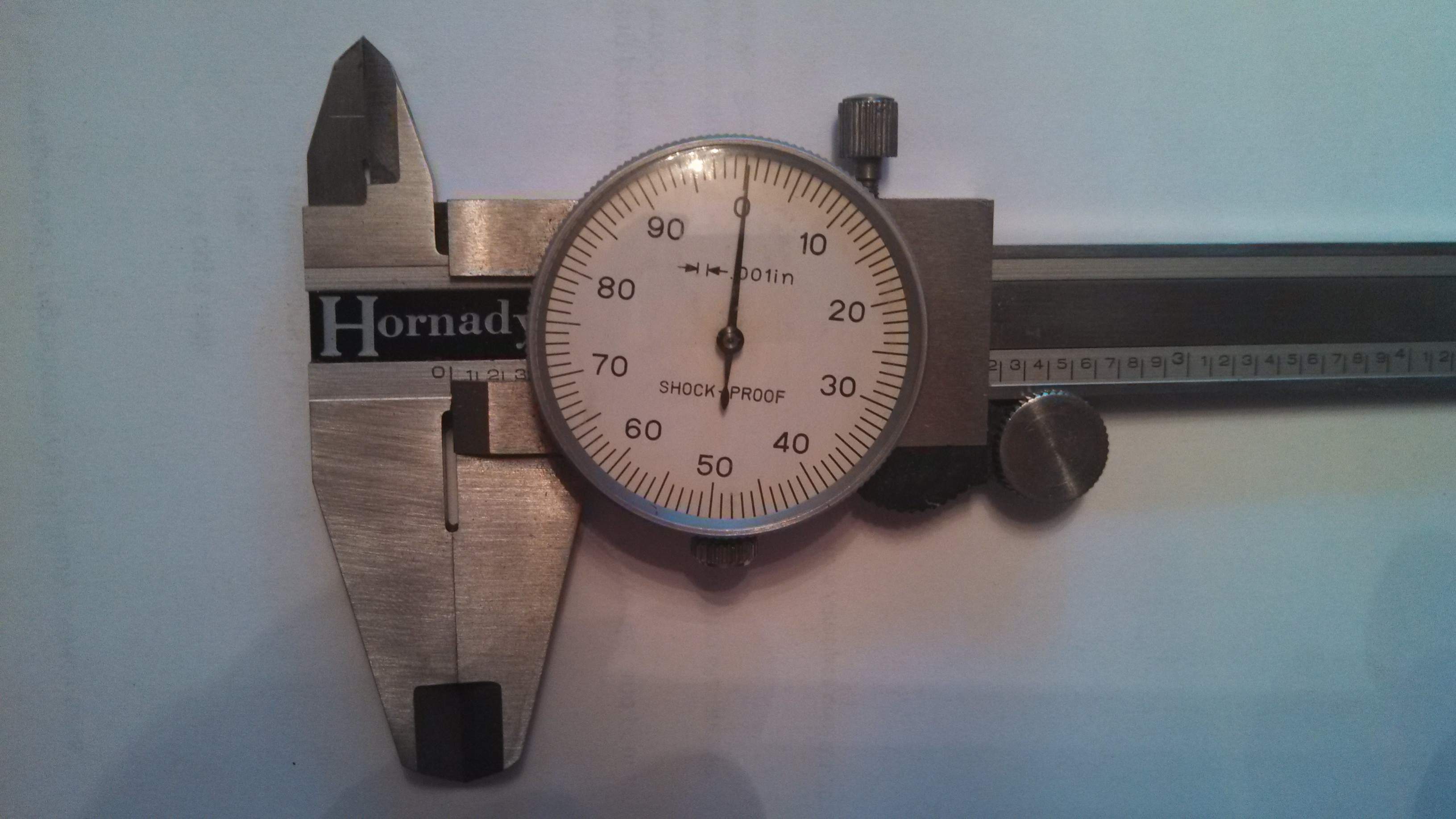

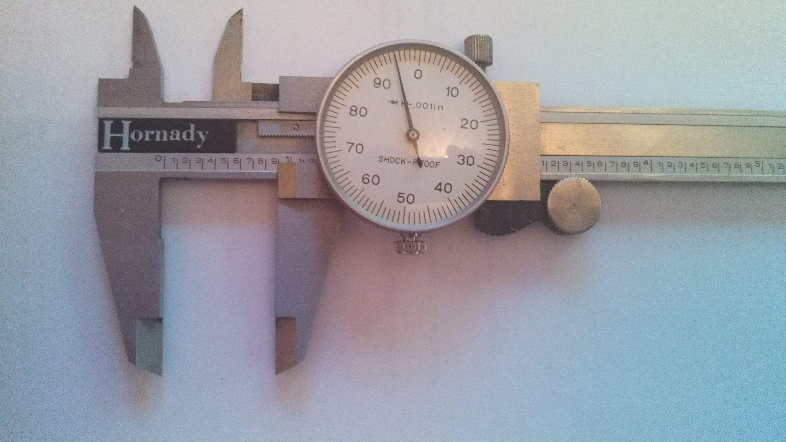

I wont even address the caliper issue, but would like to know if the actual thickness drilled was any where close to the top measurement. I have never seen a tractor FEL bucket with sides that thick. Likely just a wear edge at the top. I would think more along the lines of 1/4" thickness unless this is a bucket off a big front end loader or industrial back hoe.
Same here...I haven't seen buckets that thick either. My bucket does have a strengthening doubler on the lower sides though.
