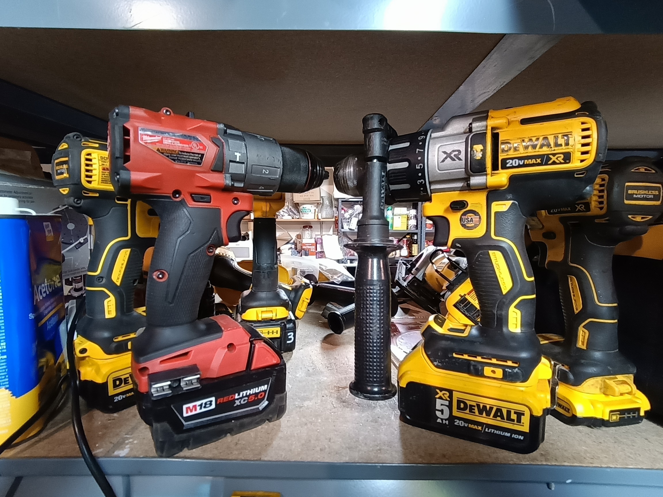

I am specifically looking at this kit:
M18 FUEL™ ½” Hammer Drill Driver | Milwaukee Tool
The street price is ~$350 for it. I need a solid drill for mild steel and other hard uses on a farm. I have been told the M18 batteries are the best in the business. I am not impressed with the DeWalt cordless stuff I have generally. It is great for normal homeowner use but, the batteries die early and have short lifespans. The DeWalt tools I have don't work well on my farm. I am looking to start the conversion process to another brand.
While this drill is not required to be cordless, that is preferred for obvious reasons. I need something reliable and durable though so, I question the expense of owning another cordless drill. I have a 3500W generator so, I can power a big plug-in drill if that is better. The problem for me is that the local options are DeWalt and aren't impressive. There is a ~$160 electric drill at Lowes which might be a reasonable choice.
I am not mixing sheetrock mud or grout for tile floors but, 3/8" holes in 1/4" mild steel or anchors into concrete are not that uncommon either. I have a small drill/driver for light tasks so, I am not worried about using my new drill for simple tasks around the house.
What are my better options in the $200~$400 range for a hard heavy-use hammer drill? I'm thinking "buy once, cry once" here.
TIA,
Sid
you should check out Ryobi,much cheaper, but use the Ryobi 18vt 4.0 lithium batteries,they last a long time on a charge,my batteries ate 7 yrs old and still going strong and the drill is 18 yrs old and I use it to run out nuts & bolts when repairing or maintaining my vehicles
