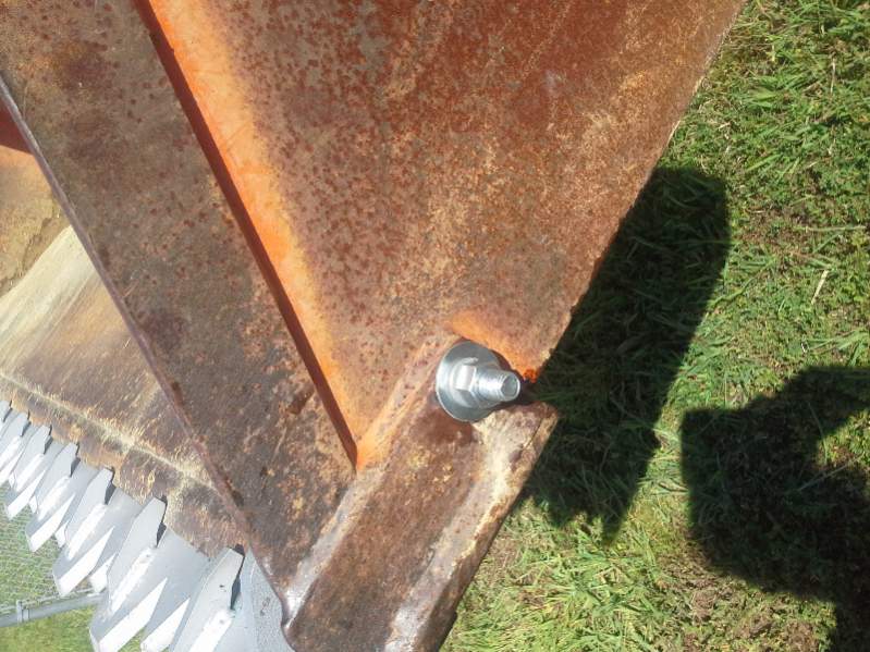

Well it's on.
I ended up drilling 1/8, 5/32, 1/4, 5/16, 3/8, and finally 1/2. Probably overkill but when I tried skipping more it would "grab", so I just used most of them.
After the 1/8 pilot most went thru quickly.
Hopefully this pic shows the buttressing of the side edge.
   / What metal drill bit for putting a Piranha on? #105
Well it's on.
Too late now, but for future reference, I would recommend extending the bracket inside the bucket and drill through the thin side of the bucket.
The extension could even be bolted on to the Piranha, for those without a welder.
I would also turn that bolt around. Put the head on the outside, or after some use, it will be hard to remove the way it is now.

Off subject, but do is see a small crack starting in the weld just under your new bolt.? If so I would put a grinder to that and hit it with a bead of 1/8 inch 7018 at about 125 amps. I could be wrong, but perhaps it is something you should look at.
When I installed mine, I put the nuts on the inside too. I also put an additional nut on each side to protect the threads from damage so it should be easier to remove if necessary. It seems to be working so far.
