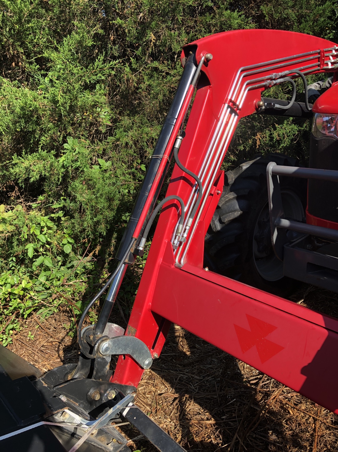

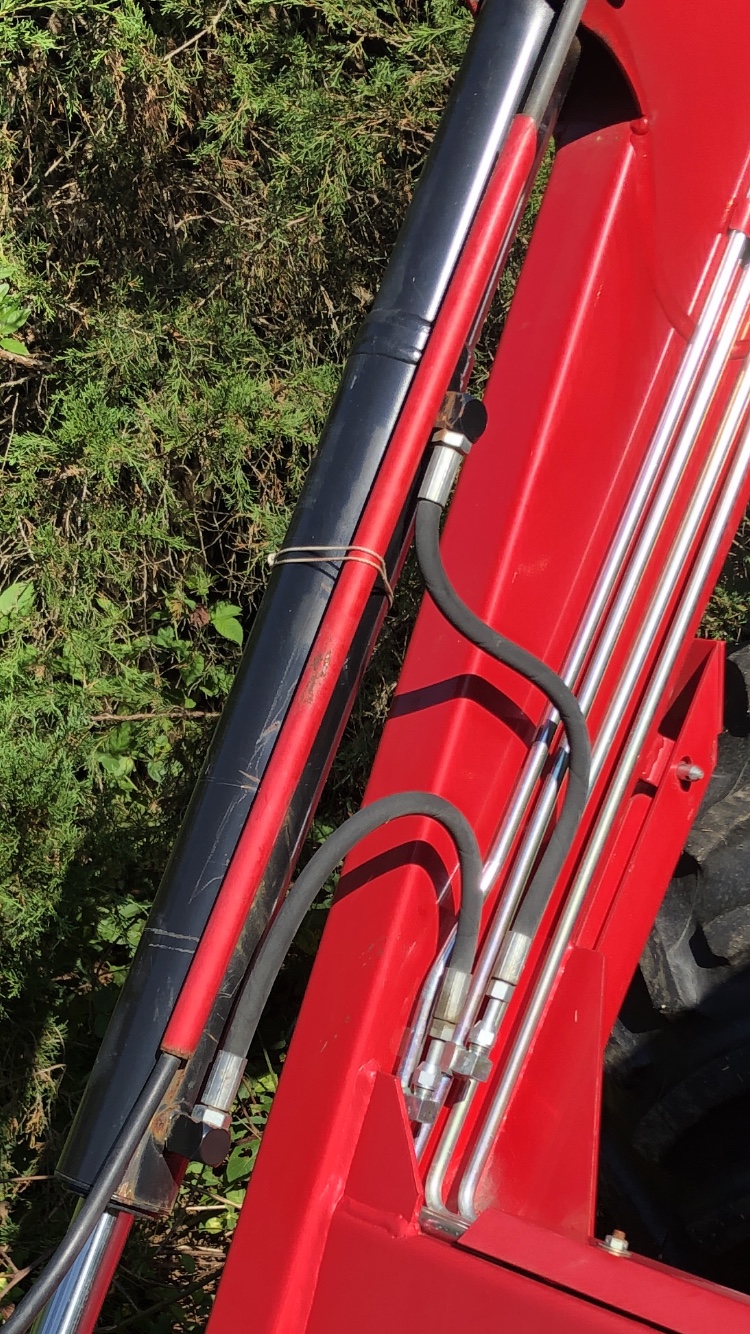

Can anyone enlighten me on what the red tube thing running up along side of the hydraulic cylinder? Looks like it might have broke off at some point as someone used rope to re-attach it.

So what is that? Or should I say what does it do and how does it function? Thanks

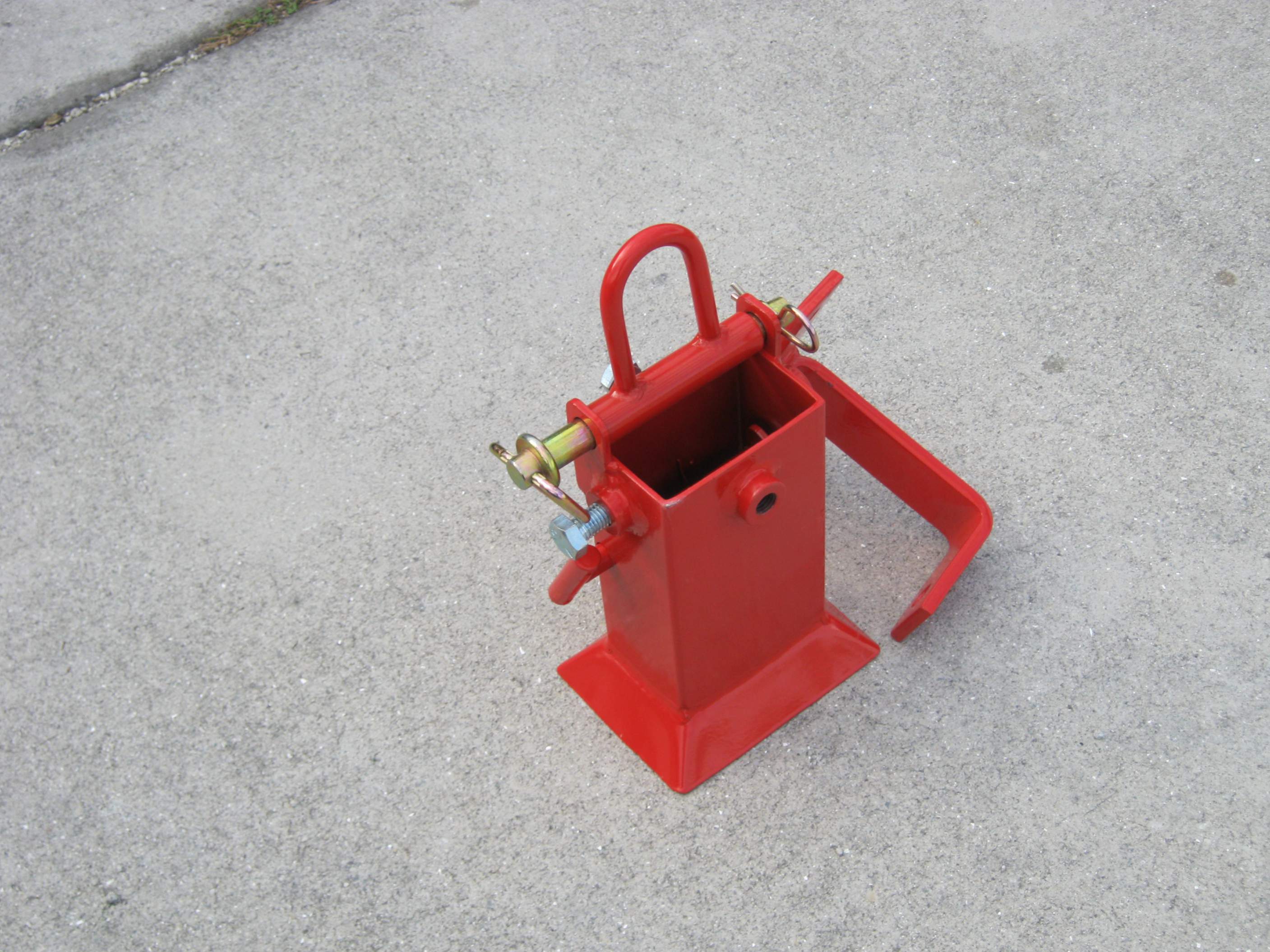

Yes quite possibly or the rope went trough the tube for a FEL bucket fence T post extracter . Heres one i had in stock at one time (2013) . Goes over fence T post and you would pull on rope(s) sitting on tractor , pull out post release on ground and onward to the next one (in theory) . It was sold by Speeco . It retailed for $69.99. I found it new in box at a TSC clearance rack 3 bucks plus tax . I had no use for it so I flipped it . I dont think Speeco sells them anymore the SpeeCo Tractor-Mounted T-Post Puller, Model# was 16110800 . Not sayin thats what they had on there but with that tube same principle .

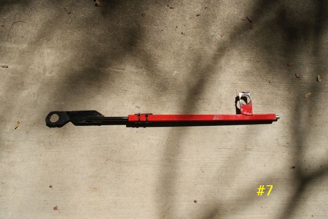

It’s a bucket indicator. When installed correctly the relationship of the rod end to the top of the tube shows the angle of the bucket.
/ What is this? #8
Looks like a shade tree mechanic bucket level indicator

Ok thanks guys. So how would it need to be repaired? I can see that would be beneficial

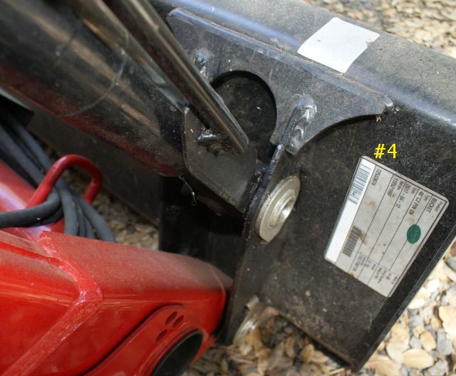

Bucket level indicator when FEL in down position and bottom of bucket parallel to earth, top of indicator shows position...
One in picture seems to be bent out of shape... Rod going through tube should be straight ( at least in my opinion)...
My version...
Somewhere on this site is my build... This may be it...
https://www.tractorbynet.com/forums...c1705-bucket-level-indicator.html#post5111670
Dale

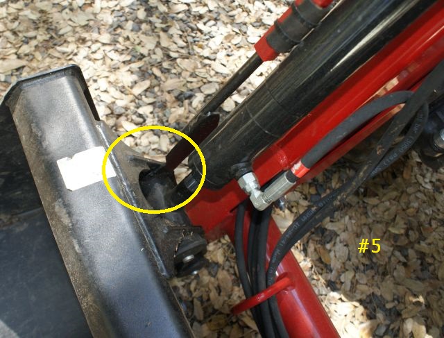

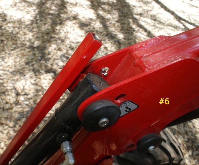

This is what it should look like , not much holds the tube on the cylinder. The rod you may be able to straighten. IMG_1104.jpg
/ What is this?
#13
Perfect. Thank you
