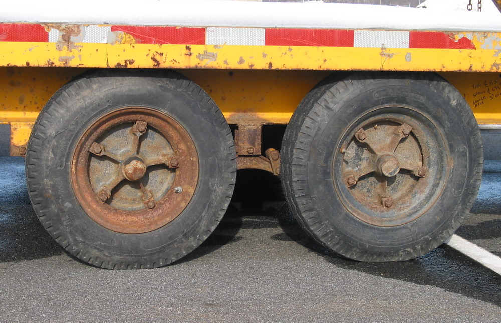

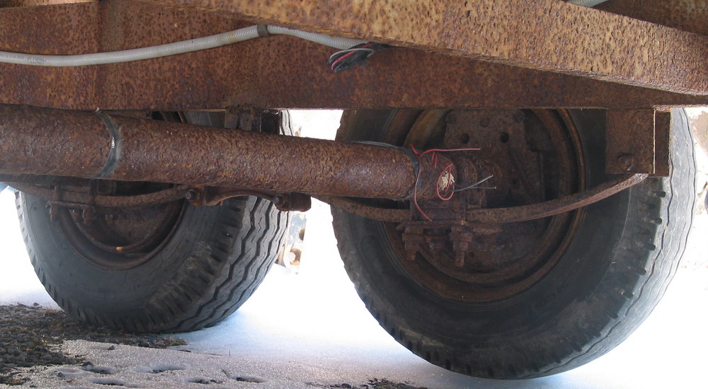

Well, it has certainly took me a long to to get back in touch with the owner, or should I say previous owner, since he accepted my $1000 offer and thus I picked up the trailer today. I now have some more pics and questions with respect to the correct path in getting the trailer road worthy. The new deck is no problem but the wheels, brakes, springs and axles are another issue. It sounds like the general concensus is to upgrade in some form or fashion to non-MH tires/wheels/axles due to the limited supply of them and their inherent problems.
Please take a look at the attached pics and confirm that these are indeed a MH type setup, which they seem to be since the tires are 7.00x14.5. Additionally, you can see from the axle pic that although this may have had brakes all the wiring is cut or no longer attached. So all that being said should I go the route of replacing the entire axle and spring assembly? Who makes a good, resaonably priced axle assemblies, Dexter 7K axles w/12"x2" brakes as mentioned or are there others? Is there a good supplier of trailer parts and accessories in the PA/NY/NJ area? If not who is good outside that area?

definitely MH axle, the monoleaf spring is a dead giveaway and no fully enclosed backing plate (which appears to be welded on.
Could not zoom in enough on the tire to tell, but if the acronym "MH" or "Not DOT Approved" is on the side then you should toss them. You should have 8-14.5 (i believe 14 ply) for that trailer.
The heavy rims have a small protrusion stamped in to prevent the wheel from rotating indepent of the hub when brakes are applied in case the clamps have loosened. The protrusion will be next to the clamp. I do not know if this makes the rim DOT approved or not.
If you plan on keeping the trailer, you will save a lot of headaches by swappiing in 6 or 7k axles, new springs, equalizers brakes 6 or 8 lug drums and wheel tires.

I would say that you are going to need a set of new axels. Be very careful in using any house trailer axels. I have made several trailers using them. And I personally would never rate them at more than 4000 per axel. The tubing is thinner that a regular axel designed for a construction trailer. And be weary of any old axel that appear to be pitted or very rusted like these. A couple of years ago I had a trailer in my shop and the spindle had broken off next to the spring hanger. It happened with a load on it. If they are pitted on the outside, there is a good chance they will be rusted on the inside also. Also most of the tires and rims used on house trailer axels are not as heavy as the ones used for comercial trailers. I have seen alot of new house trailers in route for delivery, sitting along the side of the road, with a collapsed axel, from just hitting a bump in the road. Most of them are made for one time use. I have run into older constructions trailers axels being bent or damaged in off road use and then some one would just pick up a set of these house trailer axels and put back under them. That is like as time bomb wating to happen. From the pick. it looke like the trailer is a decent one. I just bought a Holden 18ft trailer a week ago, rated at 14000. with oil bath axels and brakes, for $1300. It had been jacknifed and bent the tongue. I had to cut the A channel out and replace it. The channel cost me about $70. Plus my time. The bad thing, when they jacknifed it, it destored the vin plate(it was on the tongus) and the person lost it and had no record of numbers to call the mfg. So I since it weighs less than 3000lbs I have to register it as a home built.

As others have said, look closely at the tire sidewalls. If they are mobile home tires they will say for mobile home use and not DOT approved on the sidewall. Another way to check I previously mentioned by pulling and inspecting the brake linings to see if parts are riveted together. There should also be an axle tag ID plate on the axle. If they are regular Dexter axles you can get parts to rebuild them. If they are MH axles you would be better off replacing them. Axle width is measured at the spring centers. Common spring center measurements are 54,62,70,72,74, & 78" with 70" the most common and has an overall length of 93 3/8". Dexter has a website for axles and related parts. Most tractor supply stores only carry 3500lb axles since the ones in NY don't sell double axles trailers any more. Northern Tool has complete spring mount axle kits rated for up to 6K and come complete w/ elec. brakes, drums, and springs. They also have torsion axles up to 7K. Their catalog shows all the axle measurements so get one if you don't have one.

There is nothing wrong with "mobile home" tires or axles. Just like all other parts out there, there are several manufacturers for “mobile home” products. Current DOT reg’s require all mobile home running gear to be DOT certified. Older stuff may or may not be DOT cert. I have three trailer and a total of six axles that all cam from under mobile homes. I have never had a problem with any of them. Are there “mobile home” axle’s and tire’s out there that I would not use?? Sure. But the blanket statement insinuating that “mobile home” running gear is junk is not right.
Heck you can buy complete hub kits from Dexter Dexter Axle - Trailer Axles and Running Gear Components - Wheel-Drum Kit
The Mobile home parts that I would stay away from are any axle that has a welded on backing plate. All the newer one that I have dealt with have the standard 5 bolt 2x12 electric brake backing plate. And any tire that does not have a DOT stamp. For me if it meets those two requirements and is mechanically sound, I would run them within their limits no matter what they used to be under.
