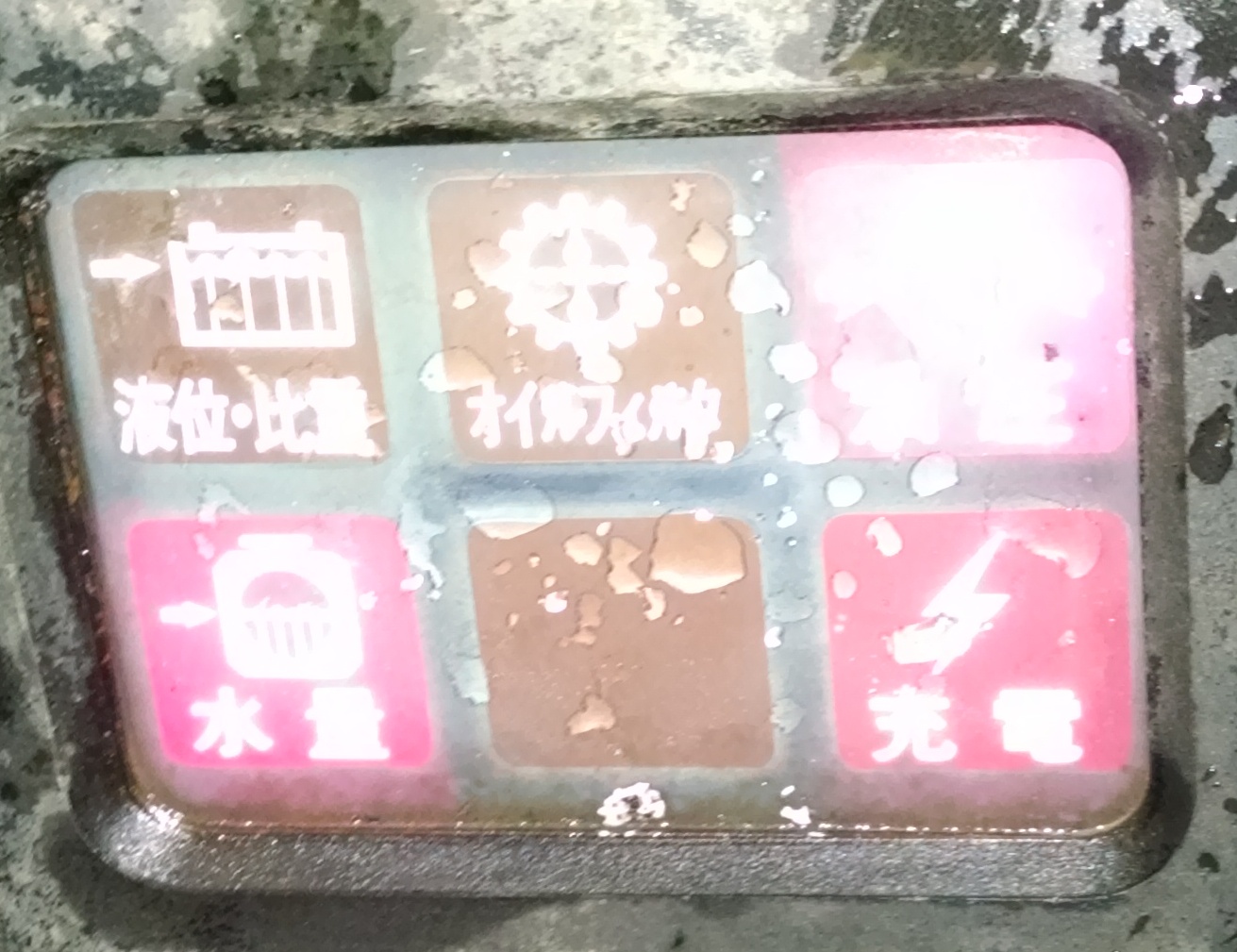

Hello All,
I am a newbie here and also a newbie to the Tractor/Yanmar scene. I just picked up a YM2820D the other day and have already ordered the manuals, but I have an indicator on and do not want to wait for the books to figure it out. Please excuse the quality of the pic, but I need to know what the middle indicator is on the top row (it is not lit in the pic). Any ideas what could be causing it to come on? Any help would be greatly appreciated!

The YM2620 and the YM2820 are related tractors. I've poked around some and have not seen this on the gauges faceplate. Is this located nearby?
The lower left is the radiator. The upper right is not clear in the photo.

Just a WAG - that could be a representation of a gear, so maybe indicates 4x4, PTO, or Creeper gear engaged???

Thanks for the input bmaverick, I took the pic with the key in the on and not started position, so some are lit because of that. I have found compareable gage icons (basically the gear) that reference transmission oil. I have found nothing that is an exact match though. I am fairly certain it wasn't on when I bought it, the low battery fluid level was on for sure, but I put a jumper in so that would no longer stay lit.

Good point, 4x4 didn't work when I got it, but was able to repair the pinion end on the front axle and reset the bearings into the driveshaft. Now that u said that, I first noticed the light after the repair, while riding in 4x4. I will have to check it out tomorrow, thanks for the help!

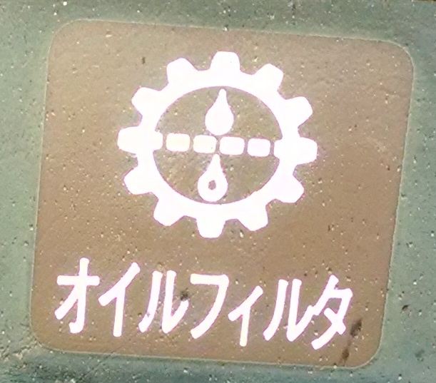

I checked it out today, and the light is still on. Rechecked the oil levels, I engaged and disengaged the 4x4, PTO, in and out of gears, moved around, and no changes.
I did take the time to take a better picture- and if I could read and understand Japanese I don't think I would be having this issue with figuring out what the indicator means LOL...

Sure don't know what it says but the symbol indicates low gear oil. Surely someone will translate it. :thumbsup:

That's what I was thinking, but the trans dipstick shows full, is there a dipstick/ plug I am missing somewhere? I got the front axle and trans dipstick in front of the drivers seat. Anywhere else? If not I guess I'll be chasing wires tomorrow.

That warning light has to be wired to a sender somewhere on the transmission, or ???
I looked all around underneath and did not find anything, so then I pulled the plastic cover off from over the trans below the instrument panel and found a connector with some wires running towards the back underneath the seat panel. Before I pull the instrument panel again (had it off before to check for any hack wiring job and to clean out the hay/mice nests the other day) I may just wait to see what kind of wiring diagrams are in the manuals when they get here. If there is no other place to check oil levels I guess I am safe to use it?
Good question. Not sure if the indicator also tells the condition of the oil or hydraulic pump. So, it's not all that easy to define safe.
