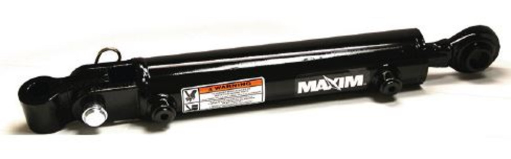

Looking for one of these but don't know what it's called.
Thanks,

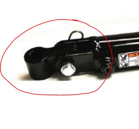

I ordered a new hydraulic cylinder that has the clevis pin on both ends and it won't fit. The old cylinder that I am replacing (as shown in photo) had a adapter that connected to the cylinder and then slid into the bracket on the rear of the tractor. The area circled in red is the part I am looking for.

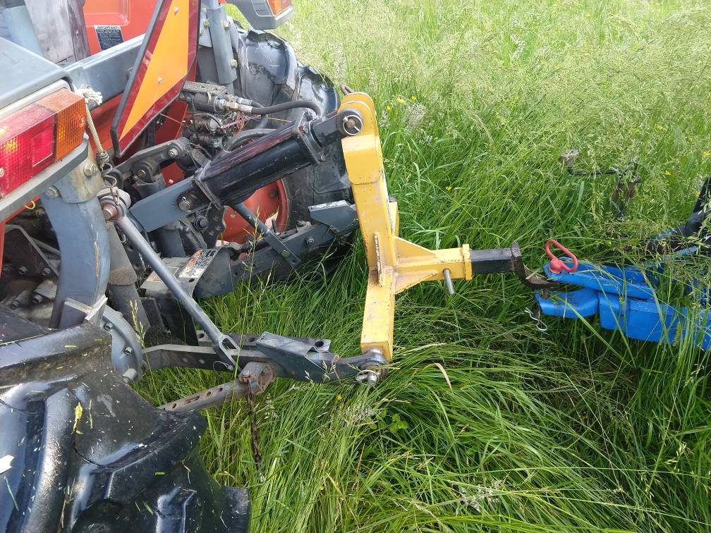

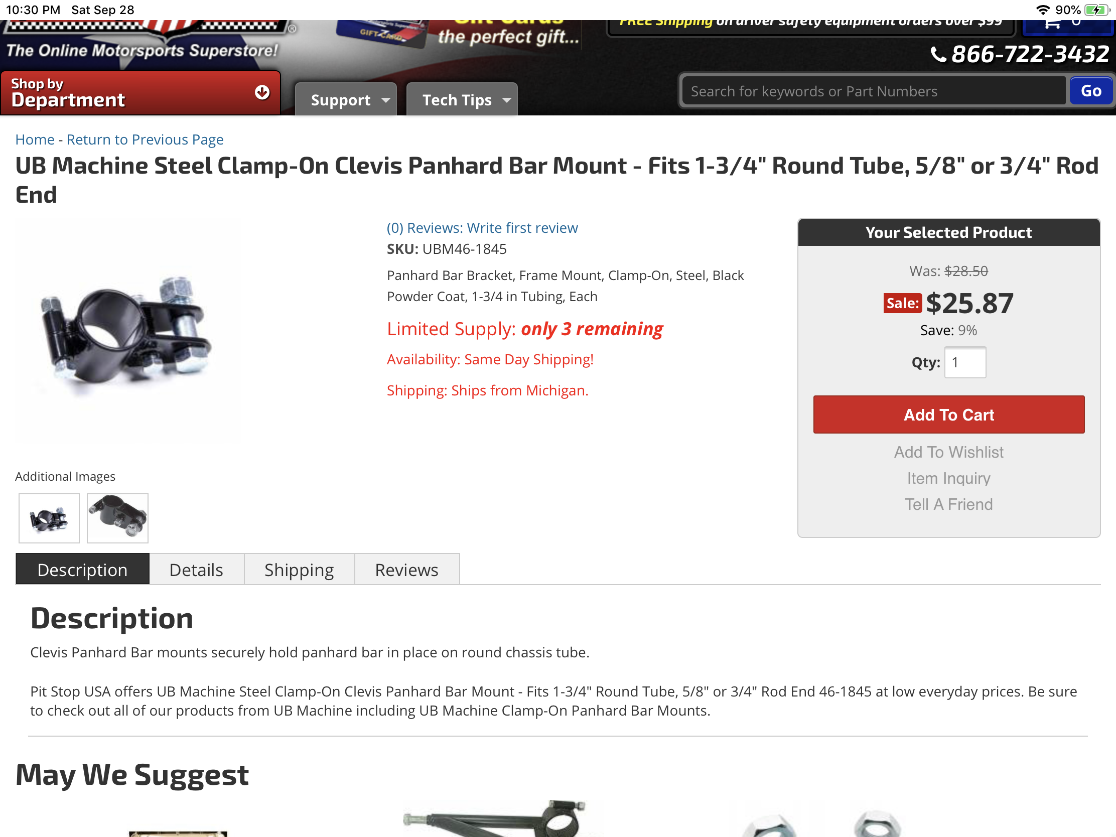

Kinda like what your looking for, just trying to help, Clevis panhard bar mount.

I will have to take it off the old cylinder and add another if I am going to use the new one. It will make the length a couple inches longer than the old one which should be okay. The photo of the cylinder on the Majester website looked it was the same as the old one. Clevis on one side and eye on the other but it had the Clevis on both.

Thanks Imold-
That is the same concept. Now I have a name for something similar which may help me search for it. The bolts and mounting holes will keep this from working.
May have to just send the new cylinder back if possible and get a new one.

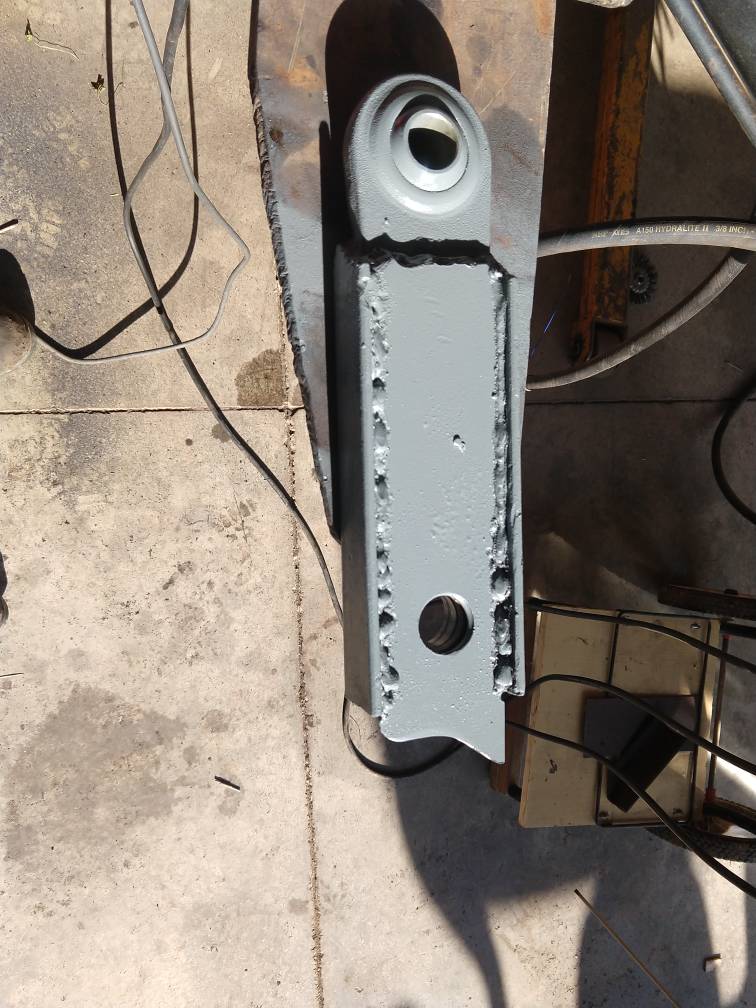

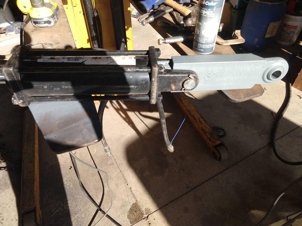

I made something to do something similar from a weld on 3 point lower link and some scrap steel:
