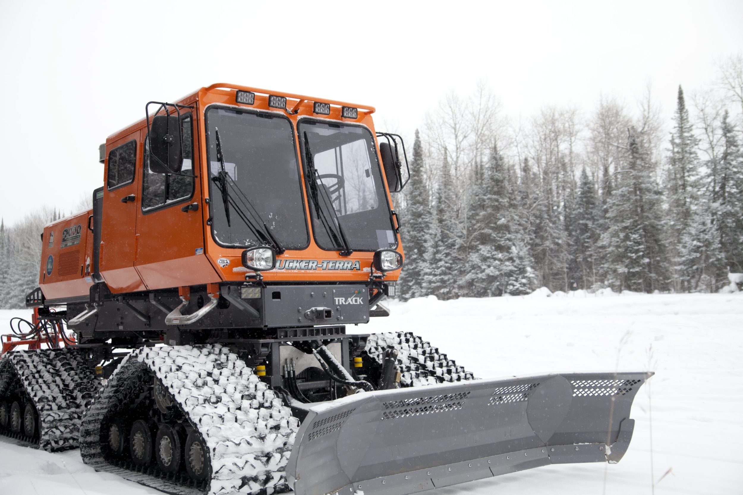

I operated one of these, some years ago.
