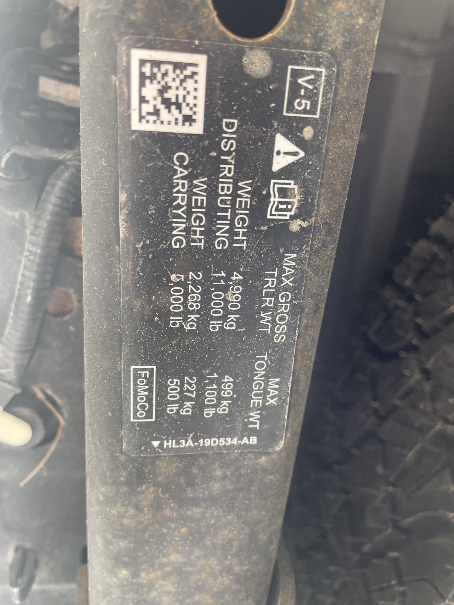

Since you have a Class V hitch I wouldn’t add anything to your truck. Just make sure it really is a Class V, they take a bigger shank but many have an adapter. It’s confusing because most class IV hitches have a V on them, which has something to do with the steel in them. A picture of mine which has a V5 on it but is not a class V.
