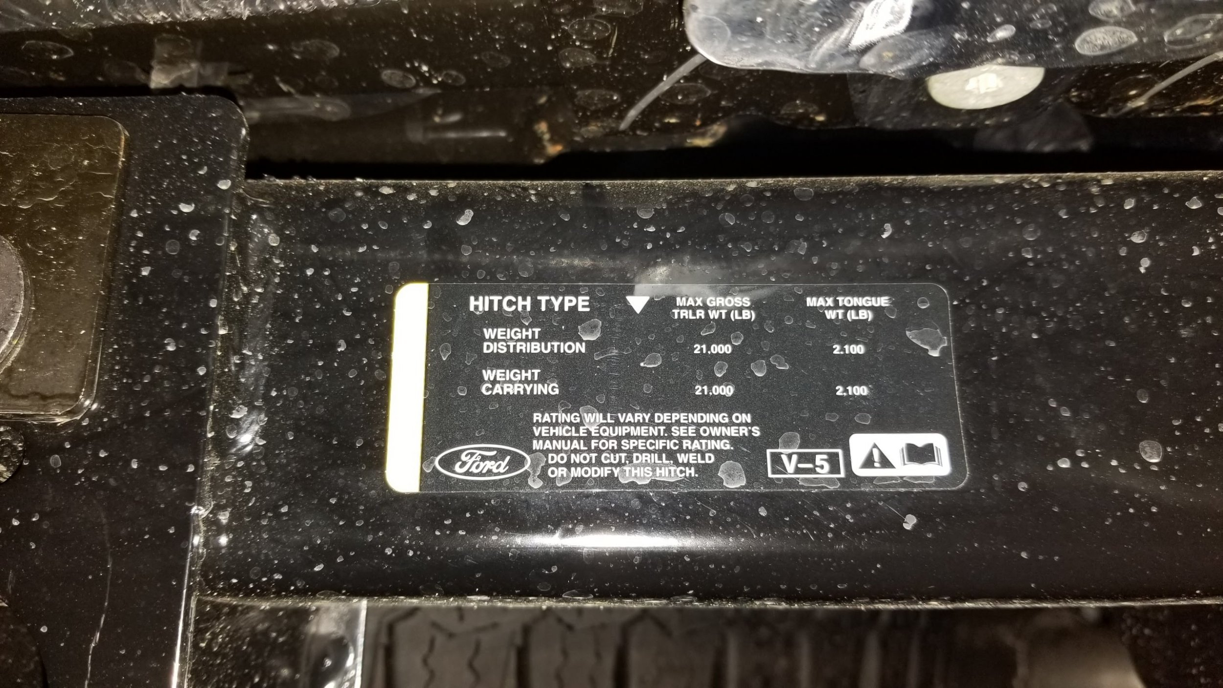

My receiver is 2-1/2" square, I do have an insert for a 2" receiver. Tag on receiver shows a max 1500lbs tongue weight with a max of 13,000 towing weight. No mention of a weight distributing hitch.
   / What is the best way to level truck when towing? #36
Best check your manual. Some manufacturers use the same hitch on different trucks and the hitch rating may be for a heavier duty truck than yours. My F350 SRW has a 3" receiver that is also used on the F350 DRW and the F450 (I believe) so the hitch numbers are higher than the SRW F350's actual capacity (18K) .
   / What is the best way to level truck when towing? #37
The sticker I showed above for my F150 for the hitch exceeds the tow rating of my truck by something like 1500 or 2000 pounds so yes, the sticker is just for the hitch, not the truck.
In theory I’d say a WDH could make the rear end to light but I’d think it would take some serious effort to make that happen. I personally have never used one.
   / What is the best way to level truck when towing? #38
FYI, V-5 does not mean class 5 hitch. V-5 means the hitch complies with VESC-5 regulation from 1968.
