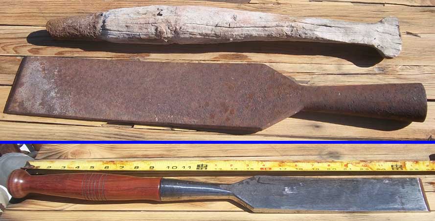

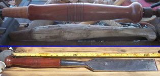

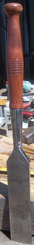

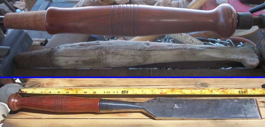

#1 Yes I know what it is called or named. And you hot shots hold off a little while as it may be fun to see what some folks think it is.
Yes its a type of chisel that is or was used in timber framing. As you can see by the pictures it was in pretty bad condition. A lot of sanding, square the cutting edge and a new handle. Not as good as new as some of the pitting was too deep to sand out. The new handle is about 1.5" shorter than the original, but it is still 25" overall.
I do not know what type of wood the handle is turned out of. When first turned it is a bright red. With in a day it oxidizes into a brown. The finish is 2 coats of linseed oil, then 2 coats of "Hut" white wax. Even with an almost instant finish it still turned brown.

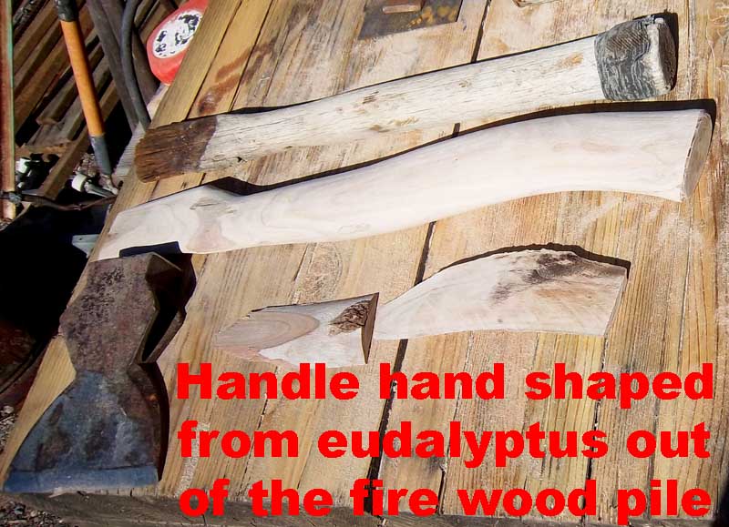

I have tried to find the proper name for this hand ax. I looked on the net for over and hour and most everyone has a different name for it. It was used by the ancient Romans and Greeks in truing up beams while ship building. What was their name for it? The cutting edge is sharpened like a chisel and the handle is offset to the right. Tried to show the offset in the picture but it is hard to see. This one may be a little more modern than the Greek or Roman ones, as it was made by "Plumb" on the side. A little hard to see is my grand fathers brand on 1 side. "A" "+" That is "A Cross" and he quickly corrected folks that called it "A plus".

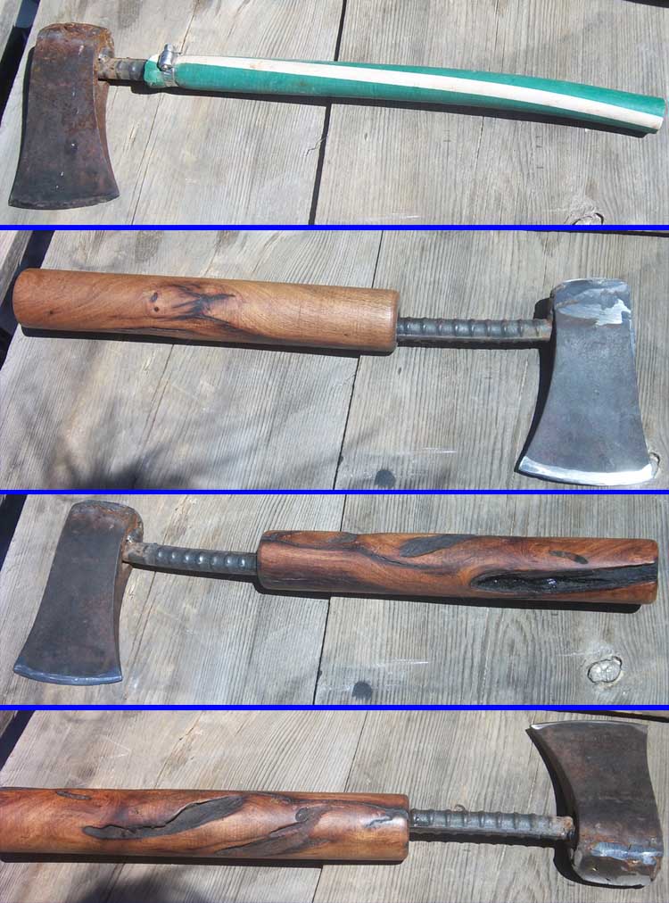

This was a hatchet that I was using for splitting wood, before building a splitter. It split across the top. I put the handle on another old hatchet, then decided to weld up the crack. While at it weld in a hunk of rebar. Not a great welder but it did stay together. Was mostly having fun turning a piece of distressed Mesquite for a handle. Since it will rarely be used and then mostly for kindling it should hold up. If not "OH Well".:thumbsup:

Witherby, Stinson, James Swan, Reliance, Eli, Greenlee, or Underhill to name a few. The other is commonly called a "broad axe". Last is just a common hand ax.

Yep last was just and Ugly Old, Broken Hatchet. Just fixed it up and added it in for the fun of it.:thumbsup::thumbsup:

First is a slick for timber framing, second is a goosewing axe and third is ugly but functional.

First is a socket chisel. I would disagree that it was only meant to be used by hand. Usually the steel socket was for a chisel that was to be pounded on. Given the size, I would assign it the task of 'clean up' for moritse and tennon joints. Or, put a 3' handle on it to clean the bark off of logs.
Second is a broad axe. The handle of which would originaly be offset (curved) to keep your knuckles away from the timber being shaped. Been there, done that. Snap a chalkline the length of the timber. Chop in every foot to the depth of the chalkline. Use the broad axe (with offset handle) to remove the stock down to the line to square up the timber.
#3 is just an ugly hatchet.

#1 Is a "Slick" and is used to finish smoothing beams. No Hammering as the handle was not designed for that. That (improper use) may be what split the top of the original handle. See the picture of a wooden handled chisel meant to be hammered on.
#2 Not a true axe although most modern names include Axe. It is more of a chisel with an offset handle. Goose wing is the name of a German tool used for the same purpose. It is used for the same job as the "Slick." Some modern names are Carpenter axe, Right Wing, & Finishing Axe. A true Broad axe is sharpened on both sides and most have a curved blade
#3 Everyone got that one right. :D But it is fun to turn junk into something useful. The wood handle was turned from distressed ( Worm holes, lighting strike) wood on purpose.

Nice handle on the broad axe. Its shape follows the grain of the wood, making for a much stronger handle.

Most slicks are off set like this.
I am sticking with framing chisel. You can put different handles on them.
There is a stamp on your chisel, can you read anything on it. or is the name of the chisel stamped on the other side?
Can you take a picture of your chisel sideways?

The Broad Axe has one side flat for facing logs and comes in different sizes see attached. My father use to call that hatchet head style a Swedish Axe, go figure, and I am sticking with the timber framing chisel, ;)
