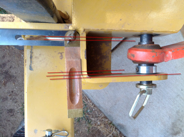

It does bind a bit as you are getting at. The cat1 lower link pin is 7/8". The implement hole is drilled 0.050" overbore, but the wall thickness of the ear is a hefty 3/8" so it takes a bit of persuasion to get the pin installed. Yes, it can be frustrating when it is cold and windy out. :laughing:
The ears are about 7.5% narrower on that side which is right at the limit of being able to install the pin without enlarging the mounting holes in the implement, whereas the good side slips right in. It does require me to use a stack of washers instead of a 7/8" x 1/2" shaft collar to space the stock 2" bushing on my 3PH to the width of the mount point. It looks rather stupid.
Really....7.5% out. OMG. Return it. You pay the shipping back to them. (Return shipping isn't free) than you can go buy a full price one locally and inspect it before you pay for it. That way it will meet your quality control. Or you can realize its 92.5% correct( probably better than most of us did on our last test) and live with it.

As I see it, the ear was bent after the construction. You can see this in the way the paint is chipped in two places: at the 90 degree bend and at the center of the box section. Maybe happened during or after shipping? (After use ? :eek: ) Either way, the rod end on the tractor link is designed to accomodate this type of off-axis pin.
You did notice that the side stabilizer link on the draft arm is out of angular travel, right? When that hapens, it puts a bending moment on the attachement lift pin. That by itself would bend and shift the outer pin location. That maybe why the paint chipped off.
I realize this is all just armchair quarterbacking, but I can't see how that is true. You can see that the weld at the bottom of the ear is not parallel with the frame. Nothing could make that weld be out of true except that the piece was mis-aligned at the time it was welded.
I have marked up what I see in the above image. The lines indicate the top and bottom of each weld bead, both on the frame side and the ear side, and the top of the ear itself. You can see that the ear-side bead lines up with the top of the ear, and both are out-of-true relative to the frame-side bead.
If you go back to post 1 of this thread, you can see photos that show that the ear itself is not malformed in any way. It is perfectly flat and ninety degrees relative to itself. This, combined with the alignment of the ear-side bead, convinces me that this is a fitup error.
