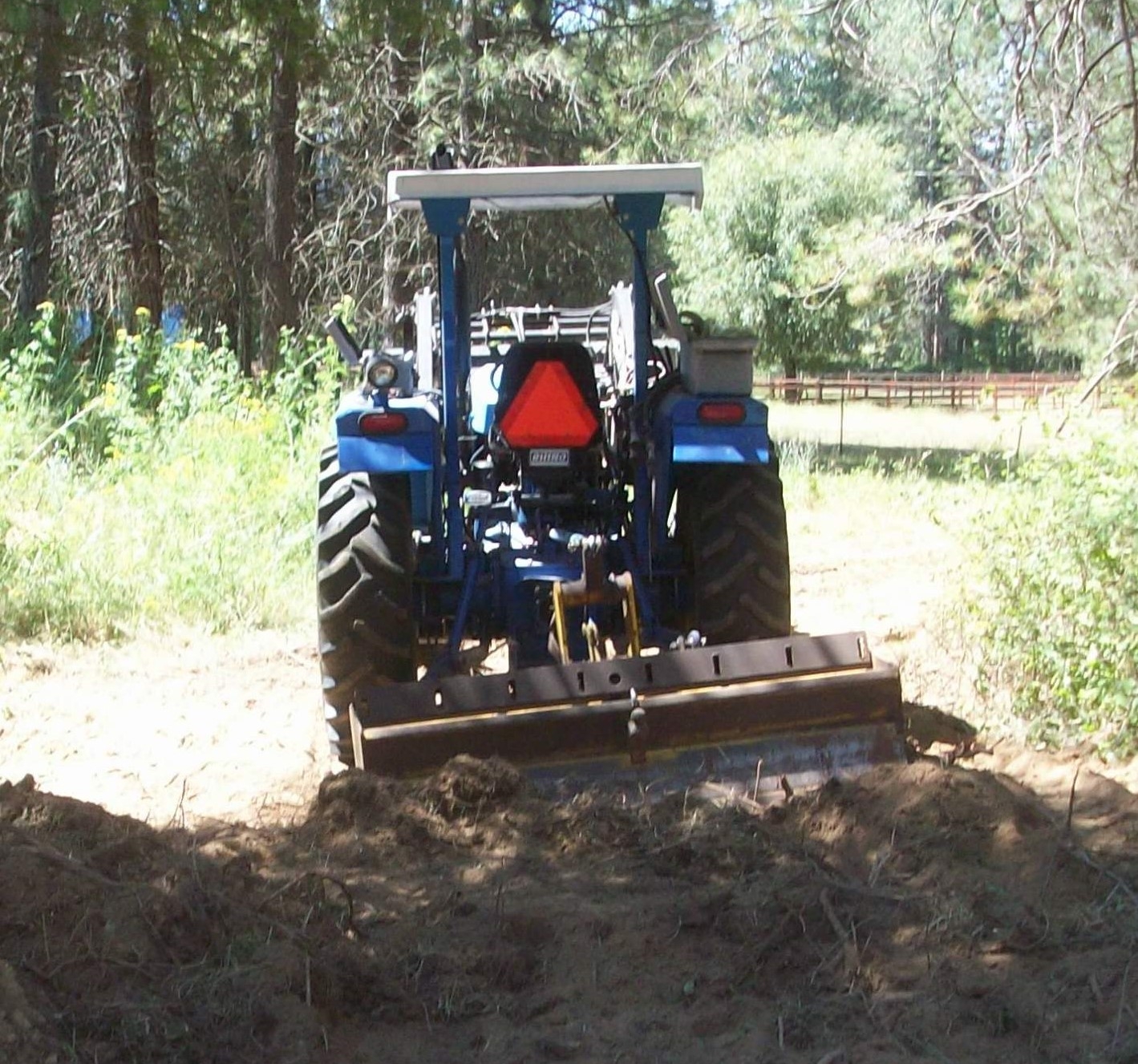

I also push dirt in reverse with it and got a bit to physical with the tractor and managed to completely tear a lower 3 point mount off of the modified, by PO box.
When the mount tore off I literally started backing the tractors rear left tire Over the box blade.
Puts the tractor at almost a Roll over condition with high pucker factor as well.
Pic after driving down off of the boxblade.
Left lower 3 point arm is against the rear wheel.
Some 3 points loose side to side clearance as they raise up and it can bend metal and or damage things if there is no clearance at the highest point..
I agree with the poster that said check for side to side free play as you lift the box.
