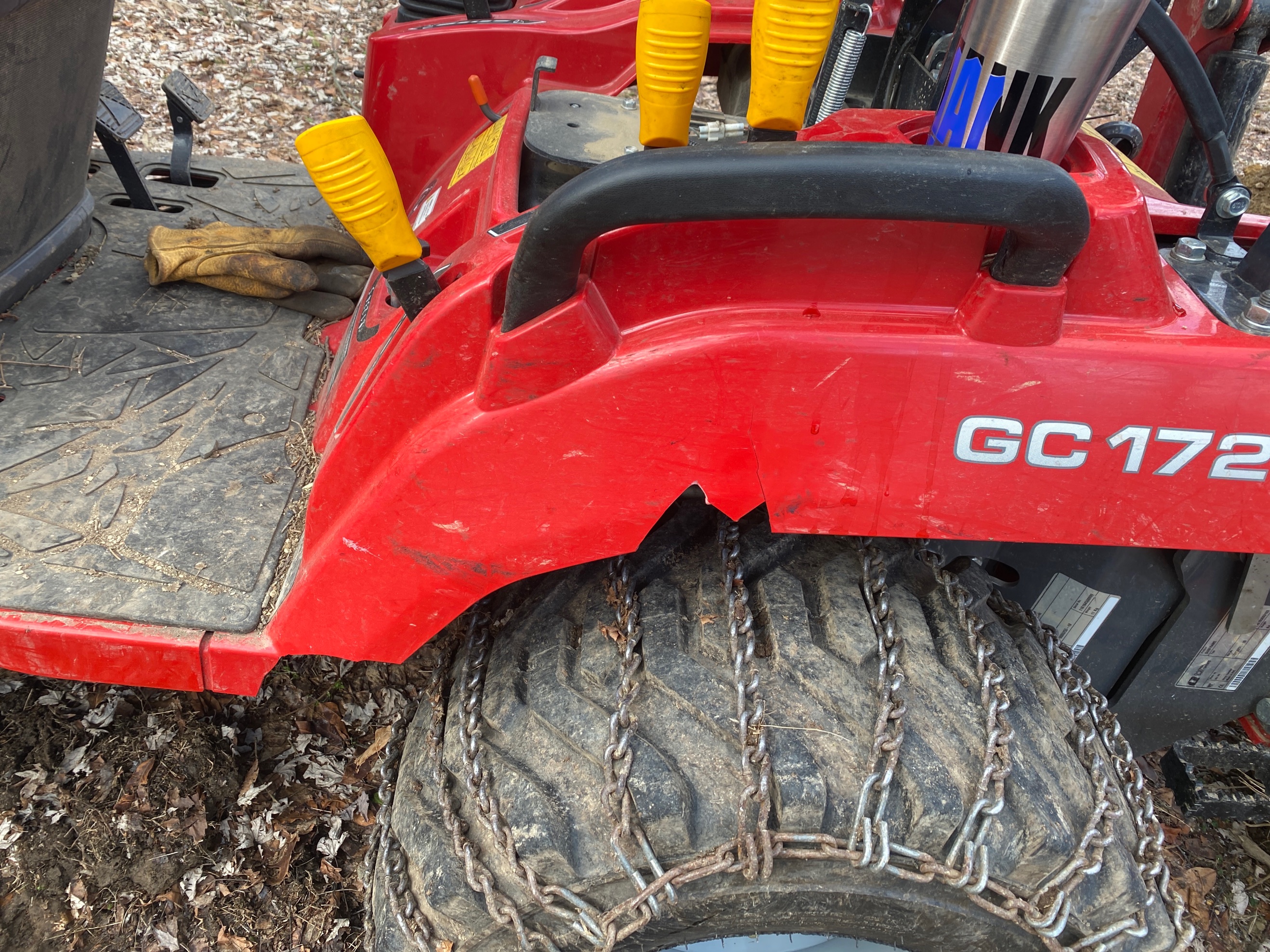

Broke the fender! More beauty marks, lol
   / What have you done with/to your GC Series 2300, 2400, 1700 Tractor TODAY #766
What happened MoMower?
   / What have you done with/to your GC Series 2300, 2400, 1700 Tractor TODAY #767
Clearing trails, I think something got caught in the chains and came up against it. Took a chunk out at the bottom where it meets the floor board and just in front of the gas tank.
I’ll get a price for one, but I’ll probably just patch it.

If it were me I'd probably purchase a 12" x 12" red anodized aluminum about 0.032" or 0.040" thick and cut a patch for both the inside and outside and use long pop rivets to sandwich your missing chunk fender.
Also the aluminum could easily be formed to match any shape on the fender that is not flat.
It looks like you have a vertical crack in your fiberglass fender, if so I'd drill about a 3/16" diameter hole at the top of the crack so that the tractor vibration does not extend the crack.
Good luck,
KC

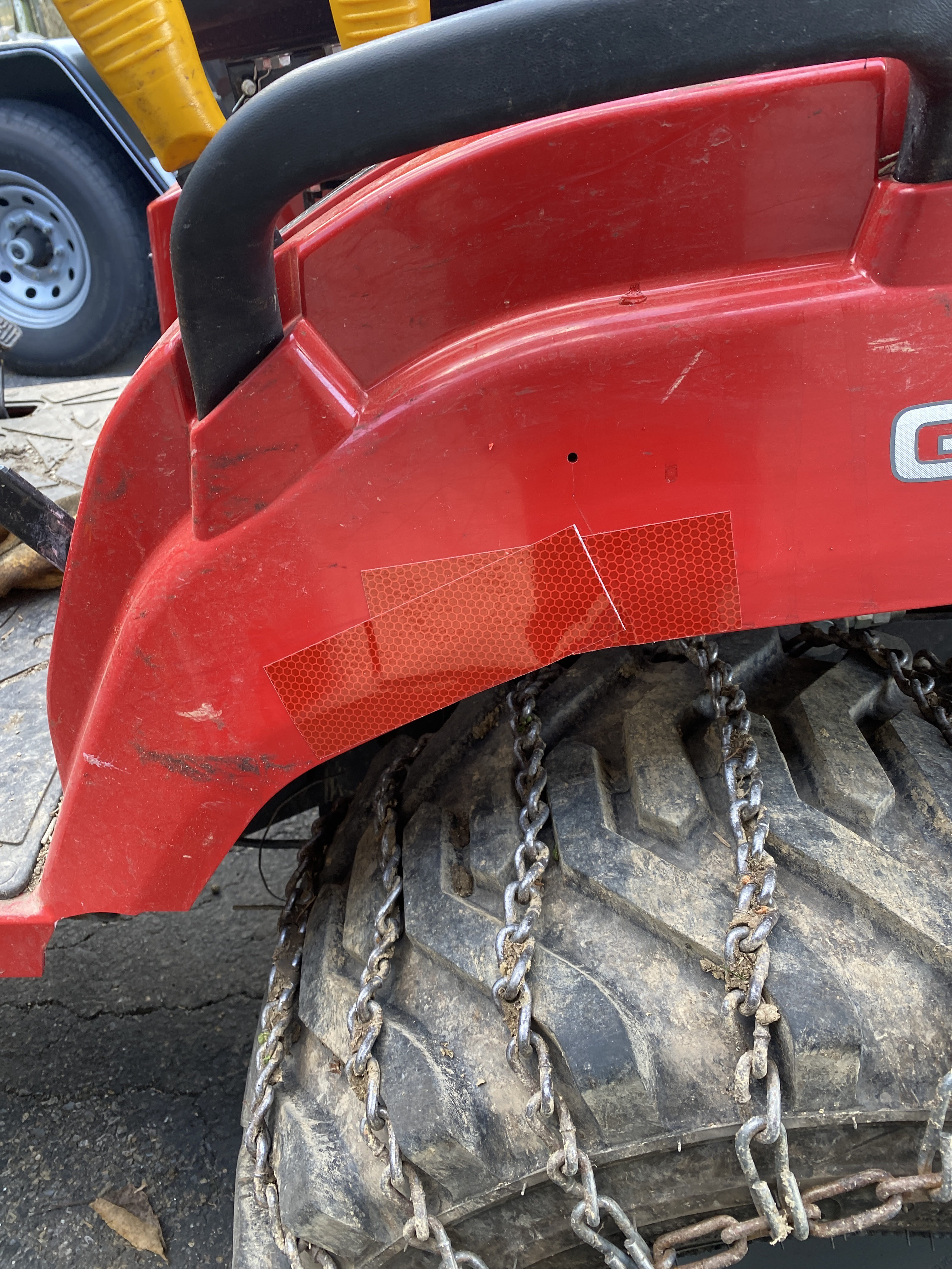

Temp fix
Not worried about the bottom (no cracking)
When I get roundtuit I’ll plate it with aluminum and rivit it in place.
