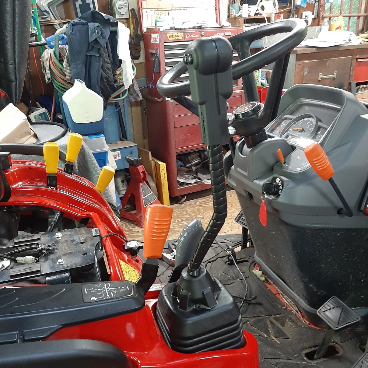

Finally working on the 3rd function kit as time allows. Hoping to put together a YT video for it as I don't see one anywhere.

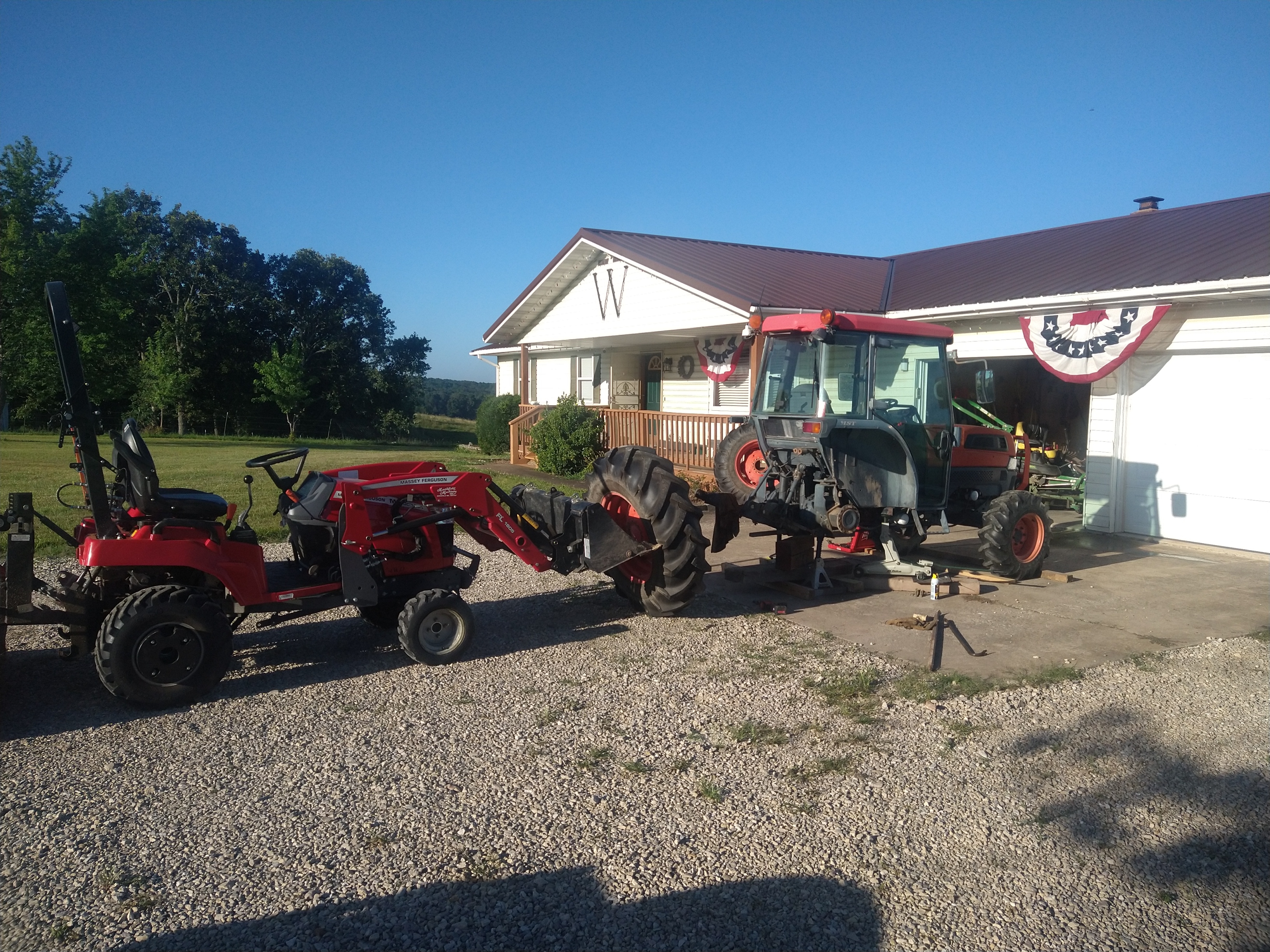

I used my Little Baby Fergie to help bring over some blocking and hold up up the tire/wheels while I increased the spacing on them ...

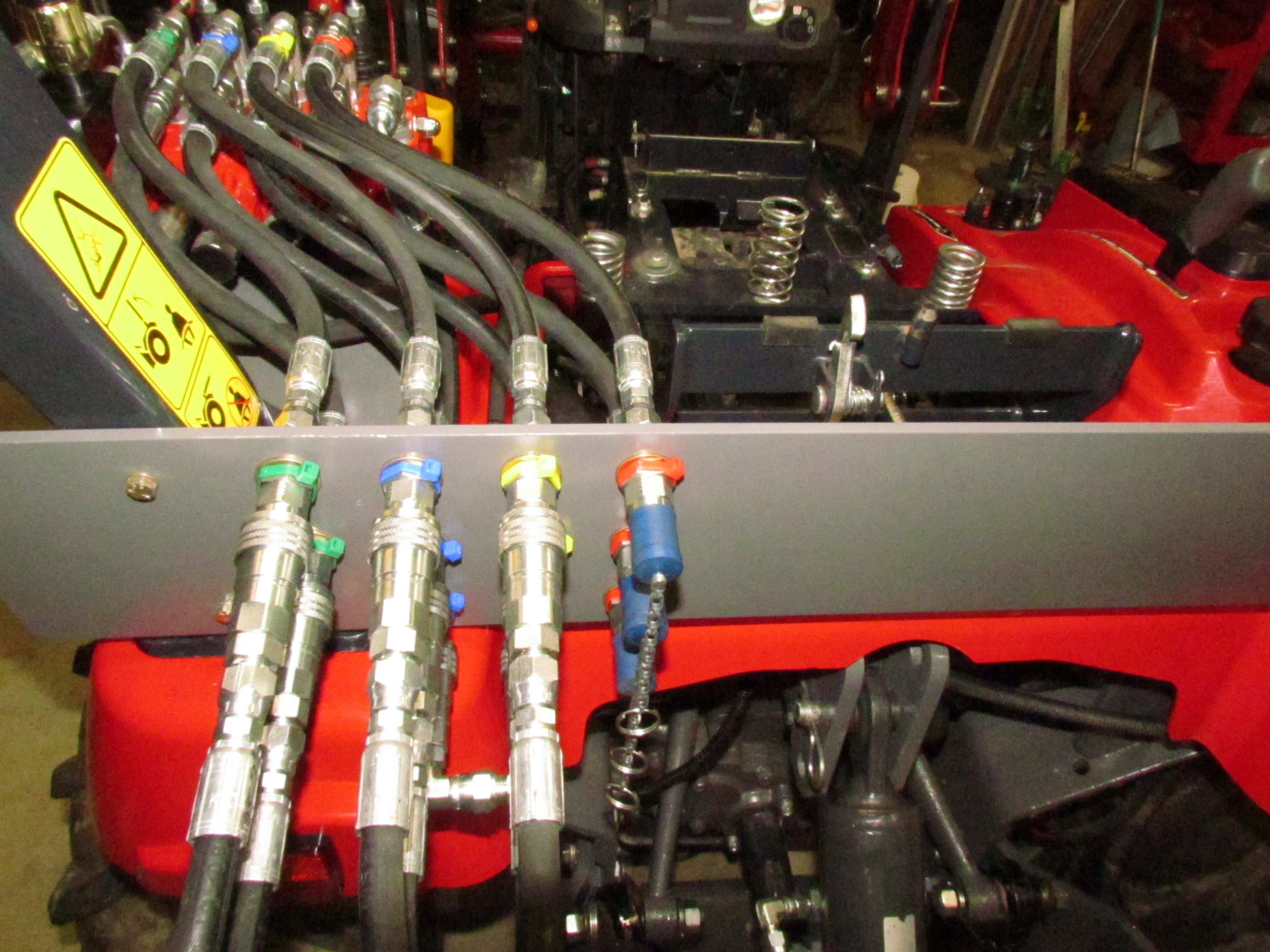

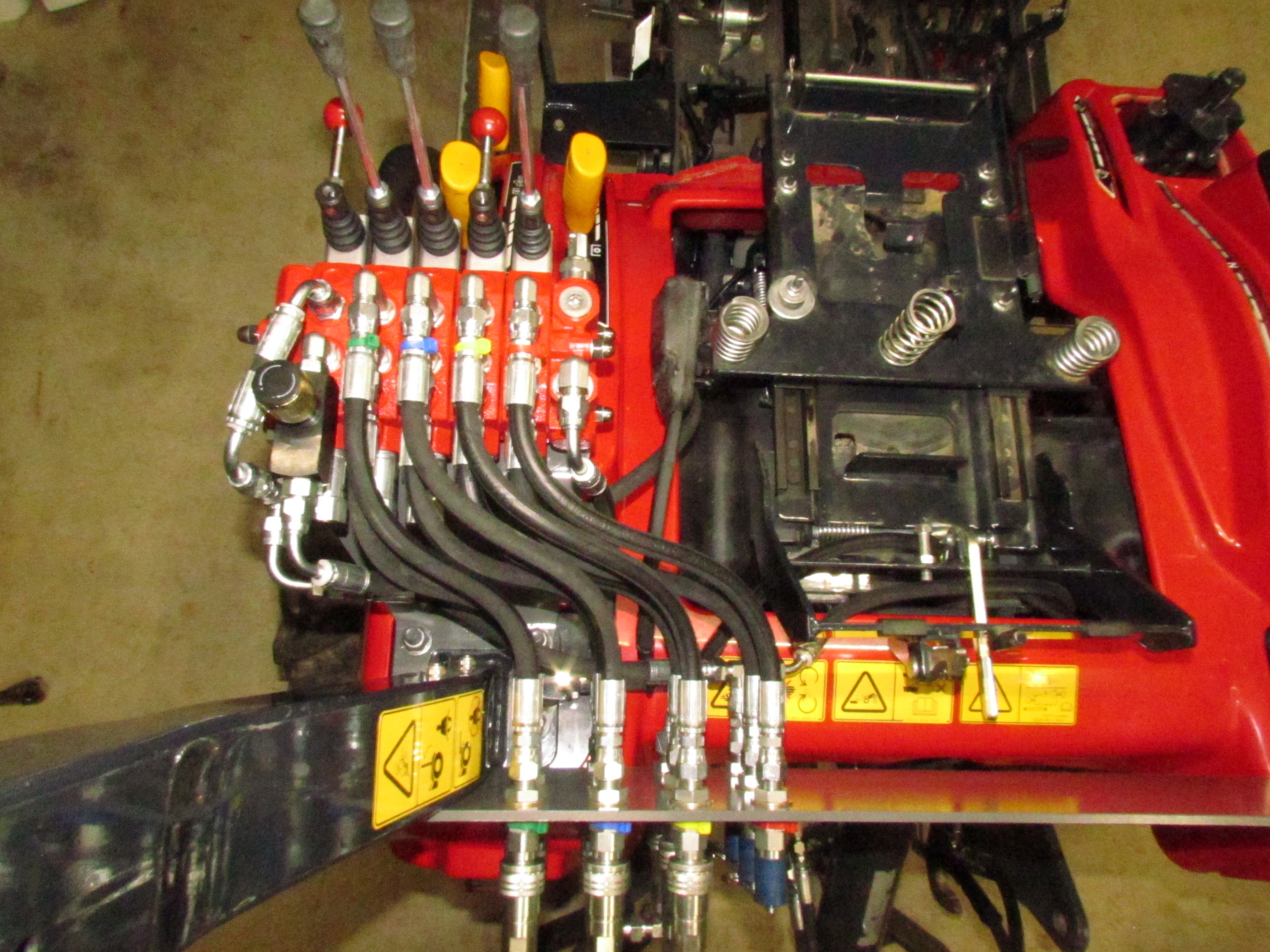

After lots of work, I finally have my "rear remotes & 3-point valve" operational. It is a 5-spools Bucher valve.
Four spools are hooked up to quick connects so that it could be used in many applications. Normally:
- spool 1 operates the rotation of my Land Pride RB1660 back blade
- spool 2 operates the 3-point hydraulic top link
- spool 3 operates the 3-point right hand hydraulic side link and has detented float
- spool 4 operates the 3-point left hand hydraulic side link and has detented float
What is spool 5 for? It is "permanently hooked up" to operate the stock 3-point lift cylinder. Why? Because the stock valve handle is so far forward it is hard to reach AND it doesn't have a detented float. It makes my back ache when using float for a long time which I often do with the back blade. Spool 5 replaces the function of the original with a detented float. The needle valve next to spool 5 is the 3-point slow-drop valve.
Here is a teaser photo:
A shout out to @kennyd at BoltOn Hooks for making all the custom hoses.

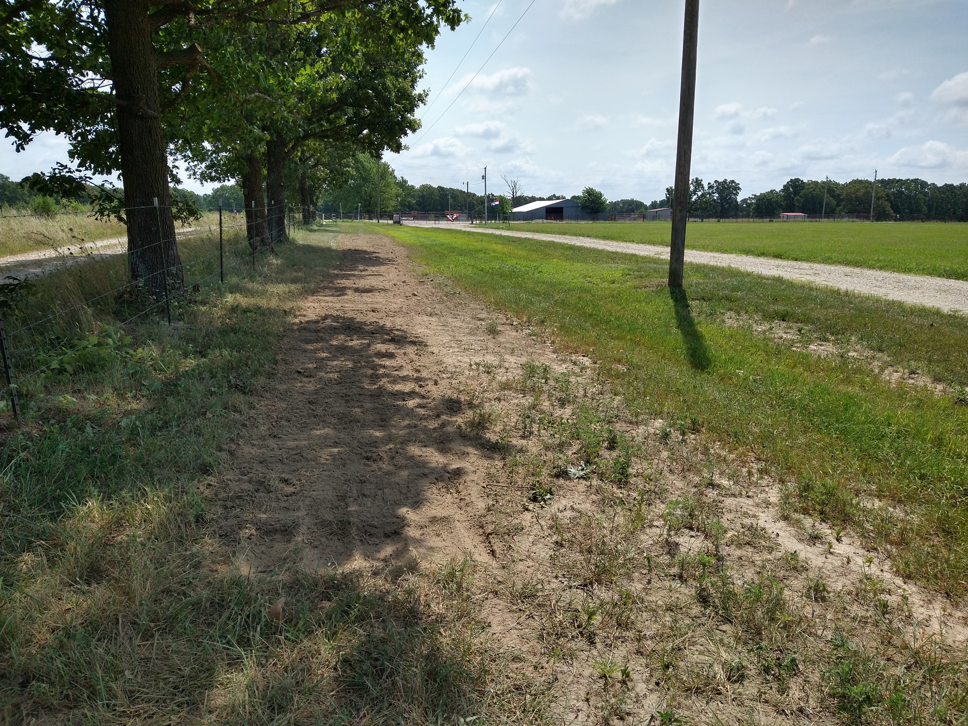

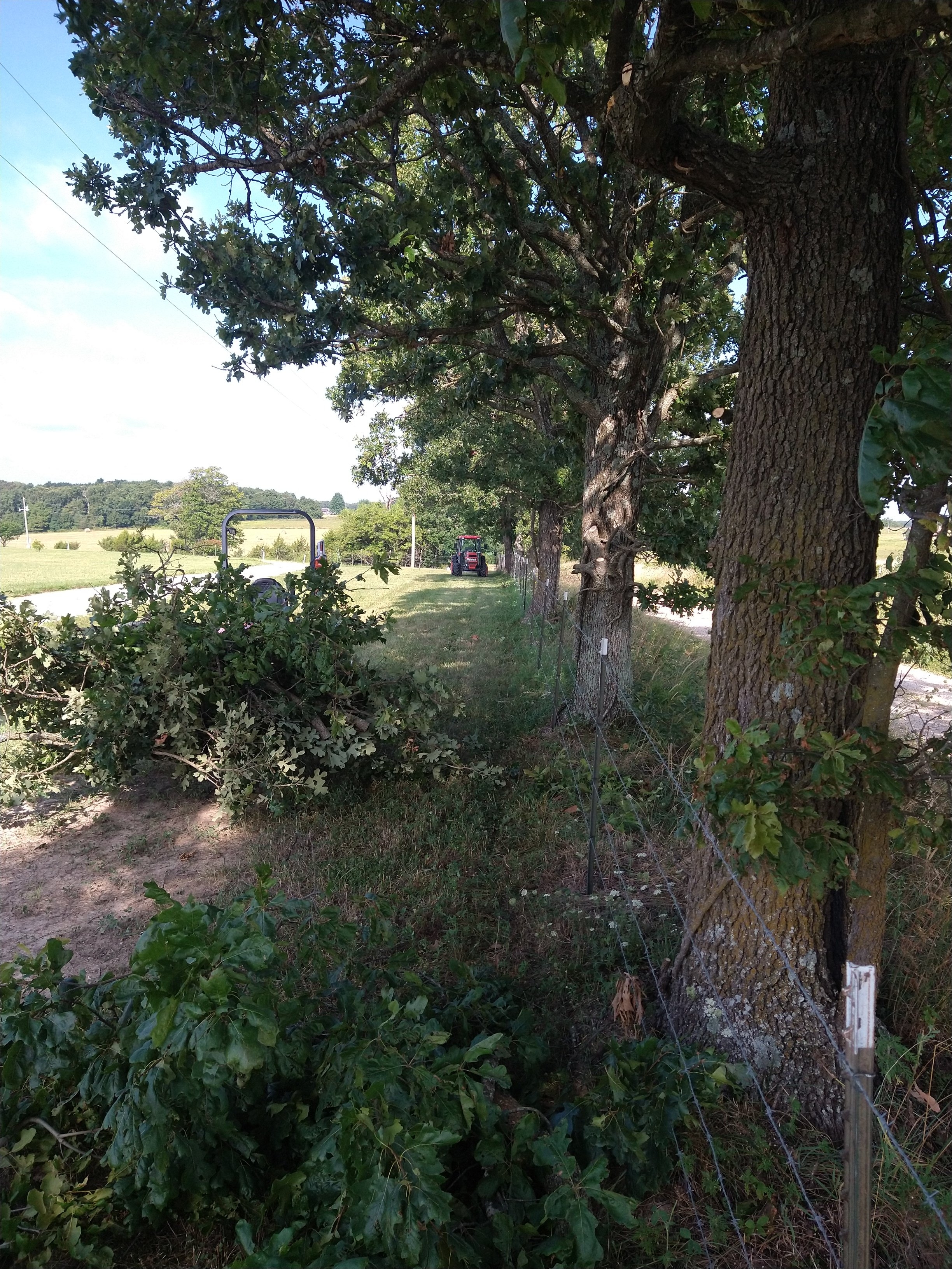

I put My Little Baby Fergie to work today started out with the brush hog and cleared the "future garden area"!
Once done, got the forks on, grabbed a step ladder, strapped on the little chainsaw, and went to trimming back the neighbors trees hanging over my fence ...
Carried two loads of branches to the brush pile ...

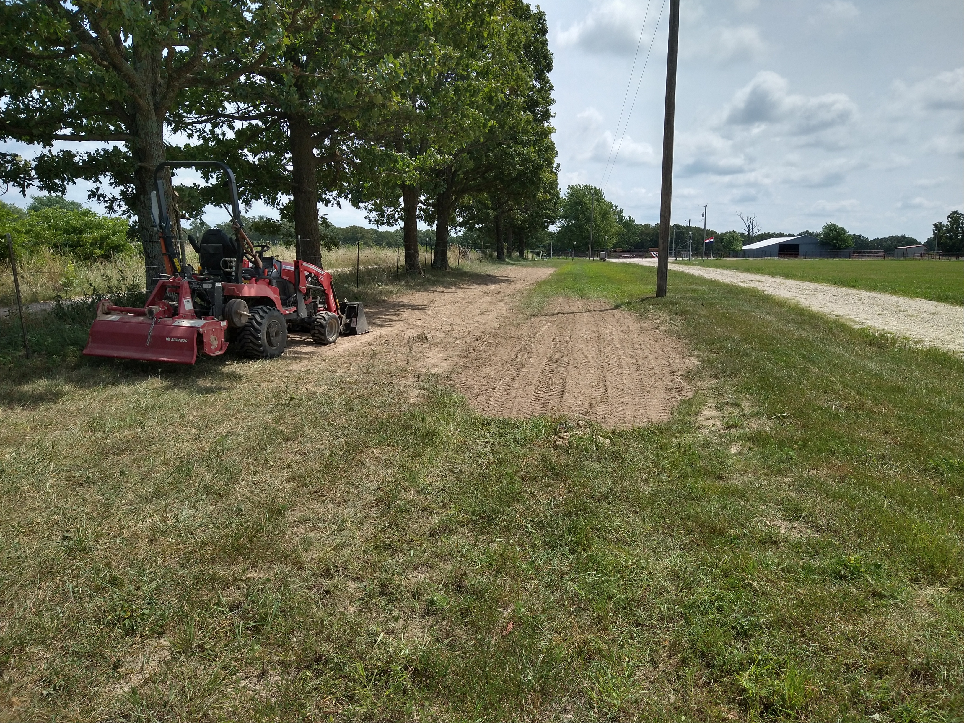

Then got the pallet down with the rototiller on it, and rototilled the garden area!

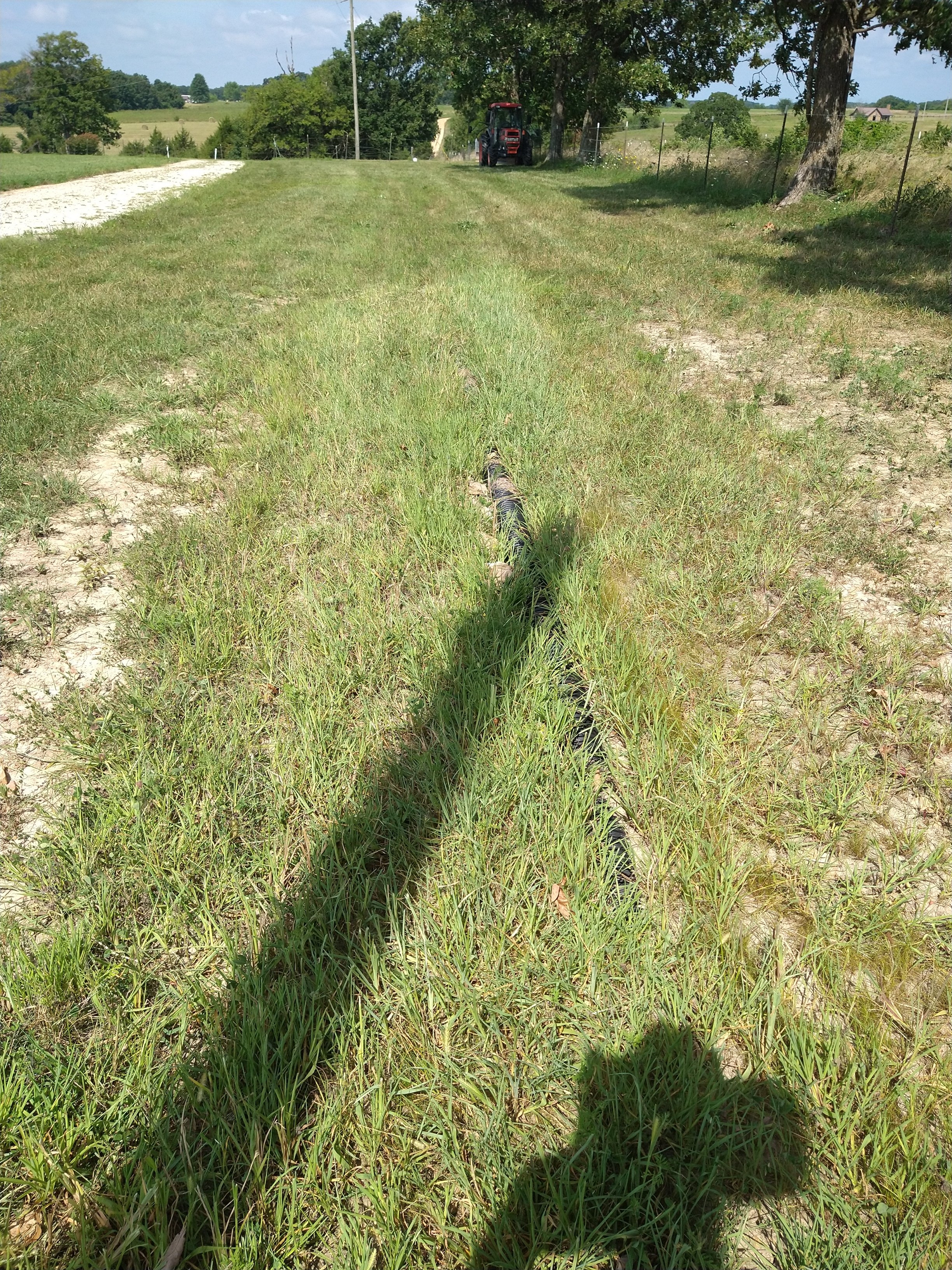

Then went back to the fence area, and rototilled to reduce the angle to the "ditch" and aquire more dirt to cover the exposed piping I had "mostly buried" back in the spring ...
Here's a 15 dusty video of chewing up the hard clay "soil"!
Rototiller virgin ground
Used the Kubota and the 6' rear blade I found out back in the weeds when I bought this place to stack it in a row so I could scoop it up with the bucket, and dump it on the piping!
Just back dragged it with the bucket, good enough!

Here's what the rear remotes look like. The rest of the huge bracket will be used for a toolbox, carrying spares, and signage (need to remount the slow-moving vehicle sign and maybe I'll hang the old and tattered "NOT FOR HIRE" sign I found lying along the road on a bike ride last year.)
Also note the 3-position bracket for the top link.

Fantastic job @dicktill , that sure came out nice!

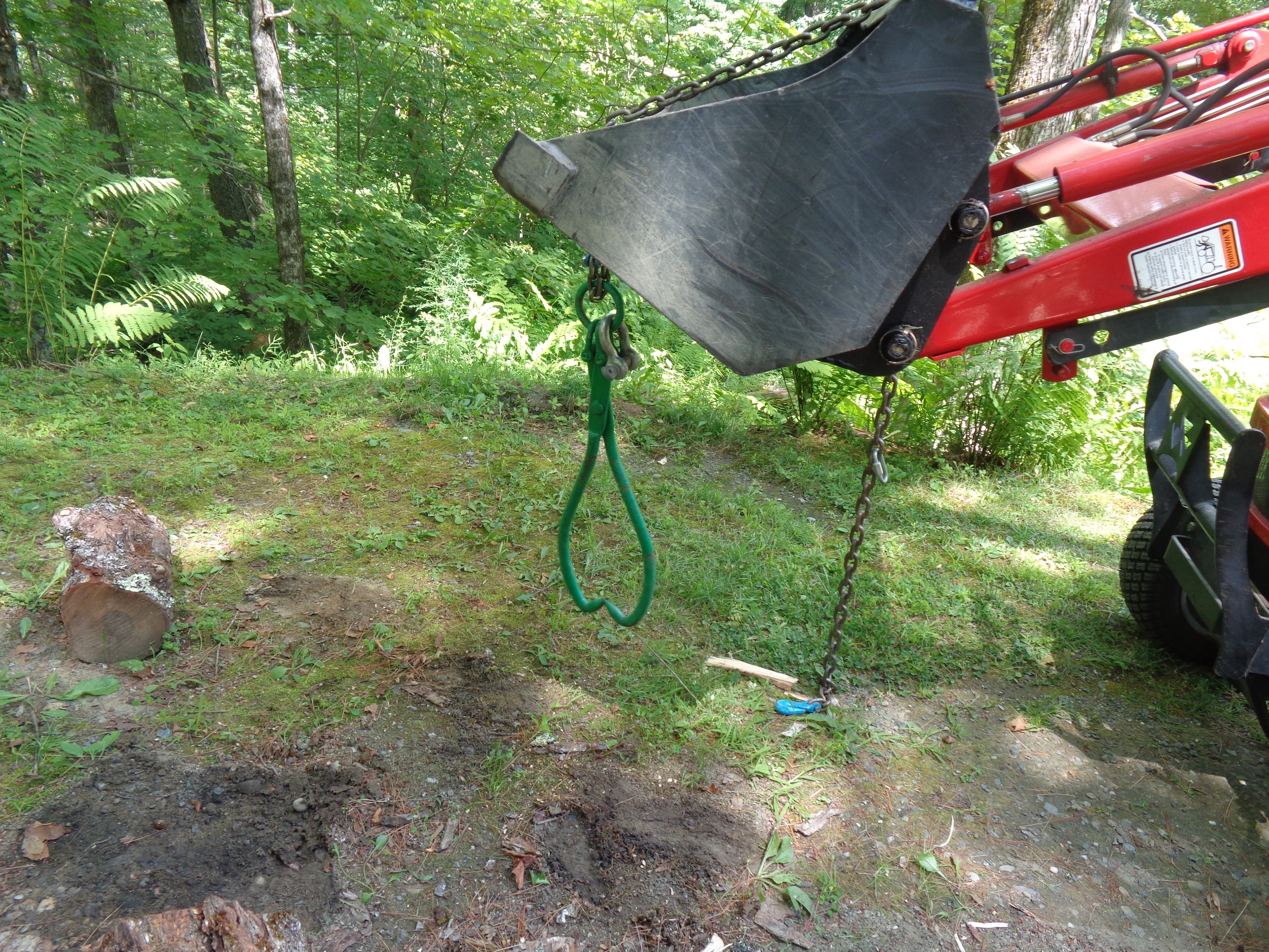

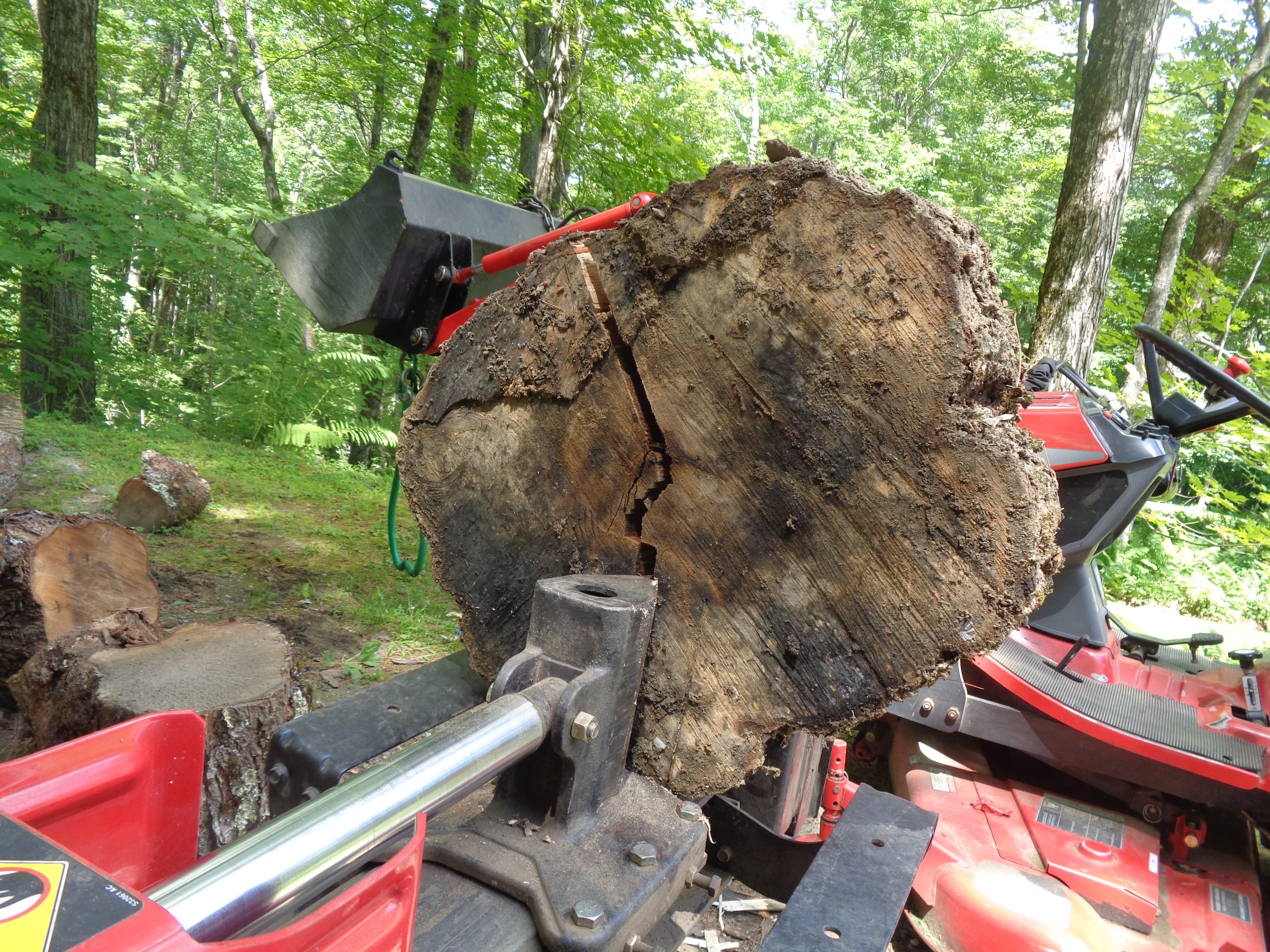

You guys are making me feel lazy!
Other than mowing duty (which my GC does very well), I've been using the FEL plus a log fork(is that what it's called?) to lift up 100-lb rounds to place on a log splitter. These machines sure a great to have around to help with heavy lifting! I'd never be able to do this myself otherwise. Love my GC!
Thank you very much @kennyd! That is a huge compliment coming from as experienced a mechanic/manufacturer/guru (and fellow OCD guy) as you.
Thanks again for all your help along the long journey.
