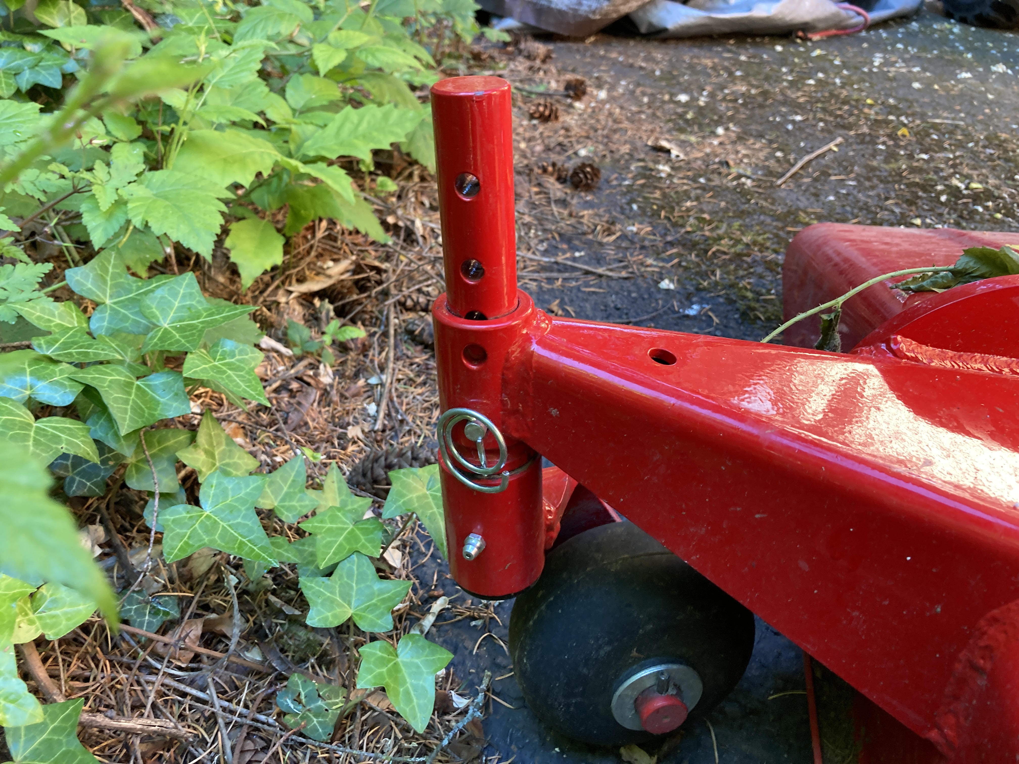

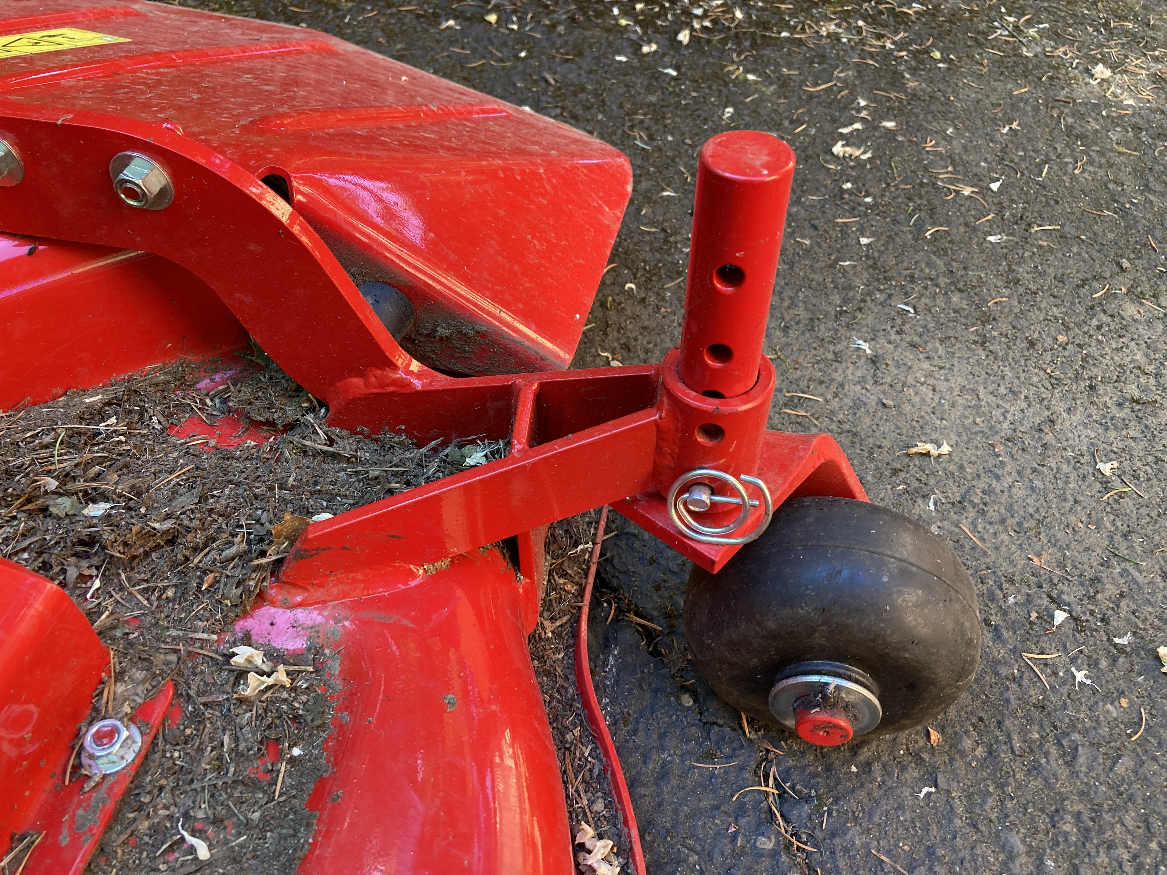

MF or my dealer may be aware of the clip problem. My brand new mower has the clips on the inside.
   / What have you done with/to your GC Series 2300, 2400, 1700 Tractor TODAY #2,802
I think I had mine on the inside when it yanked out. But then again I was using my mower deck like a brush hog.

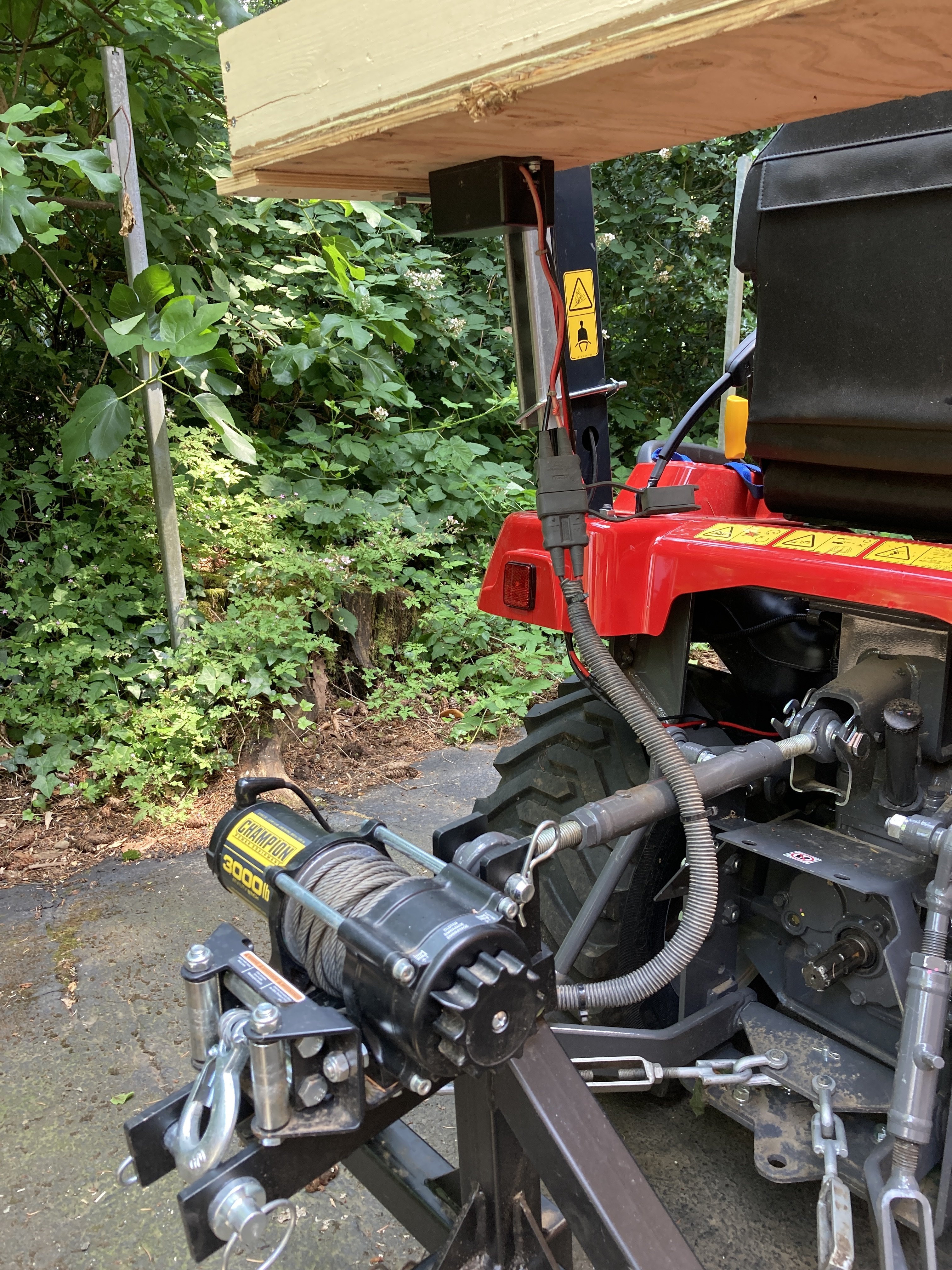

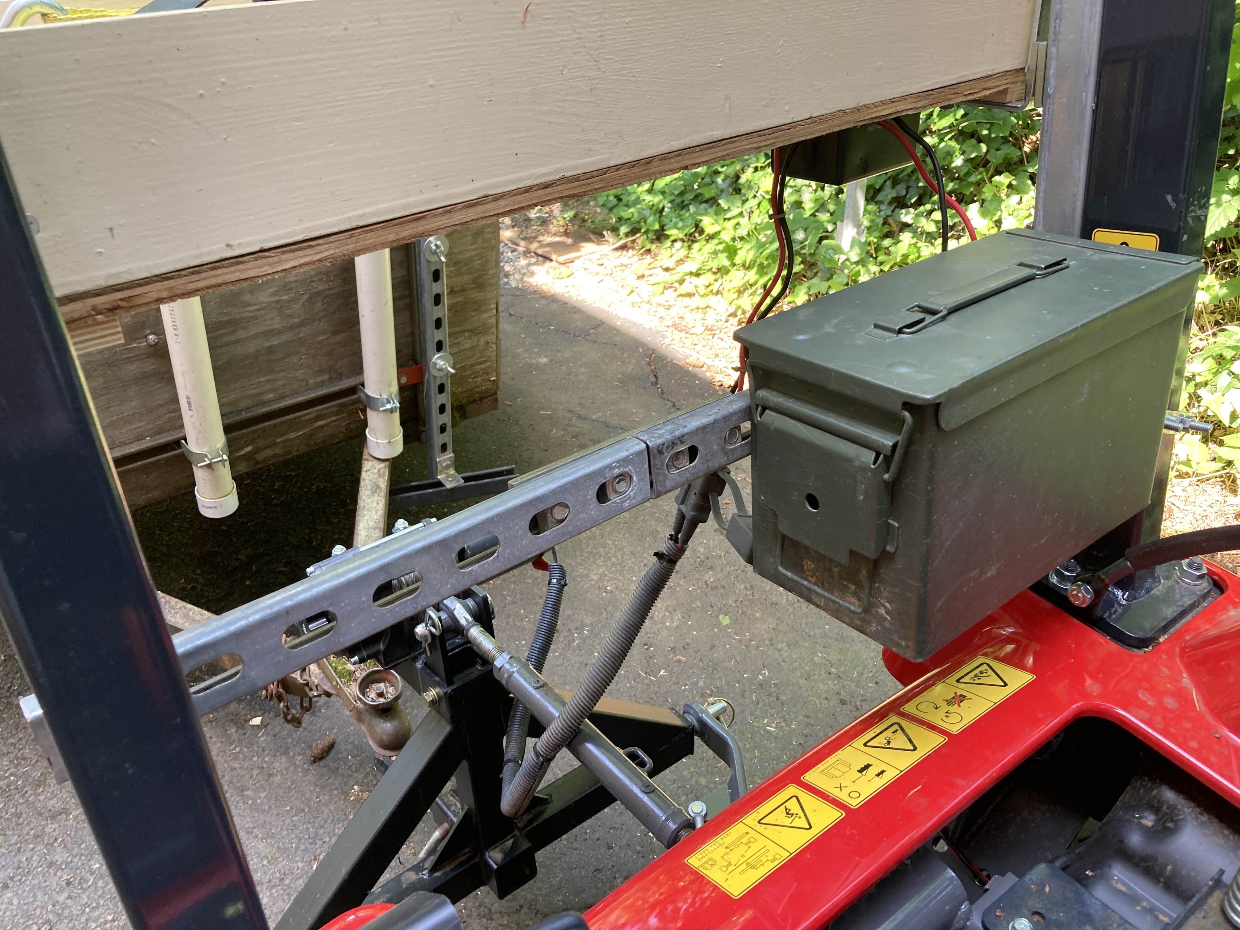

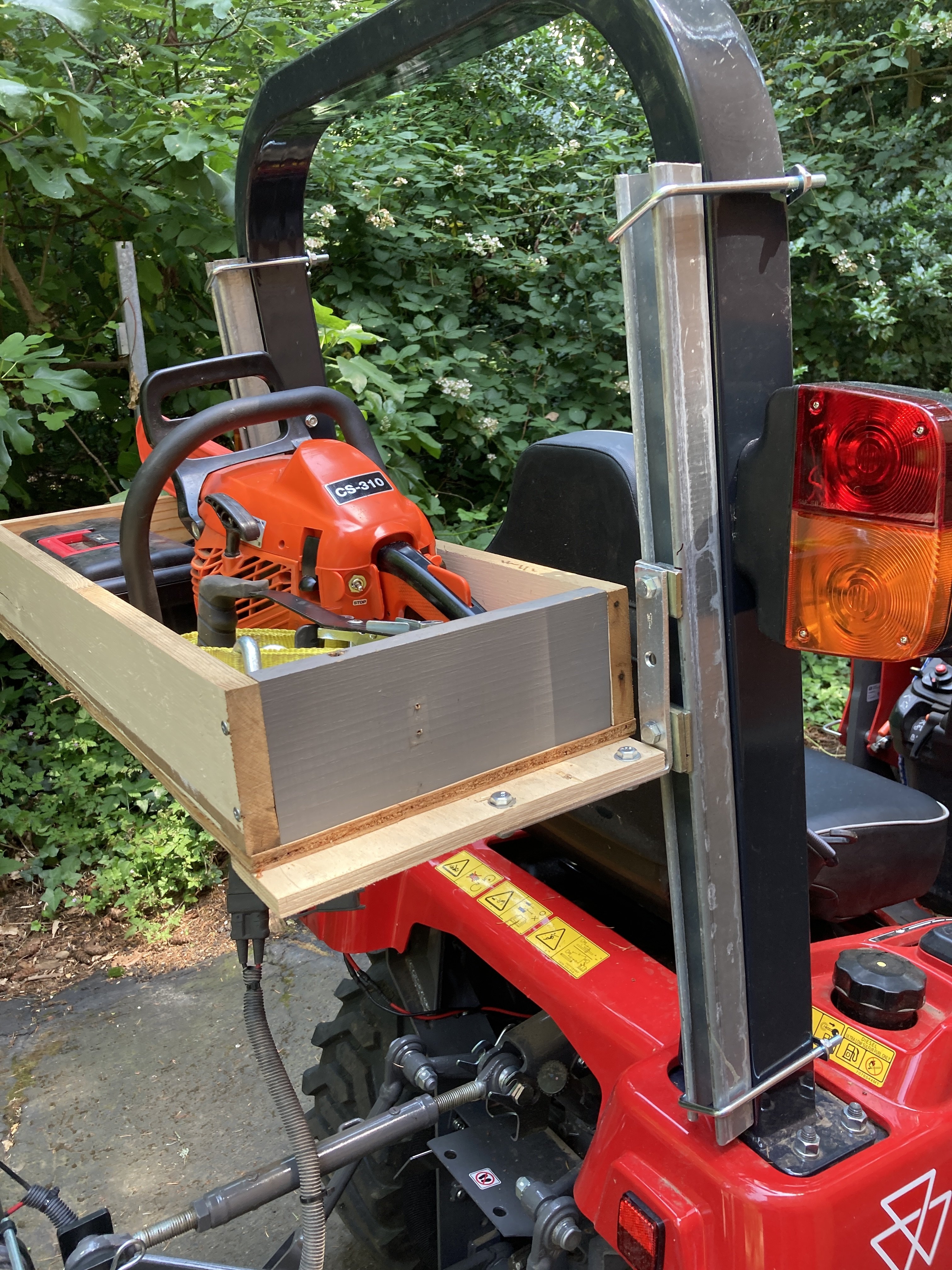

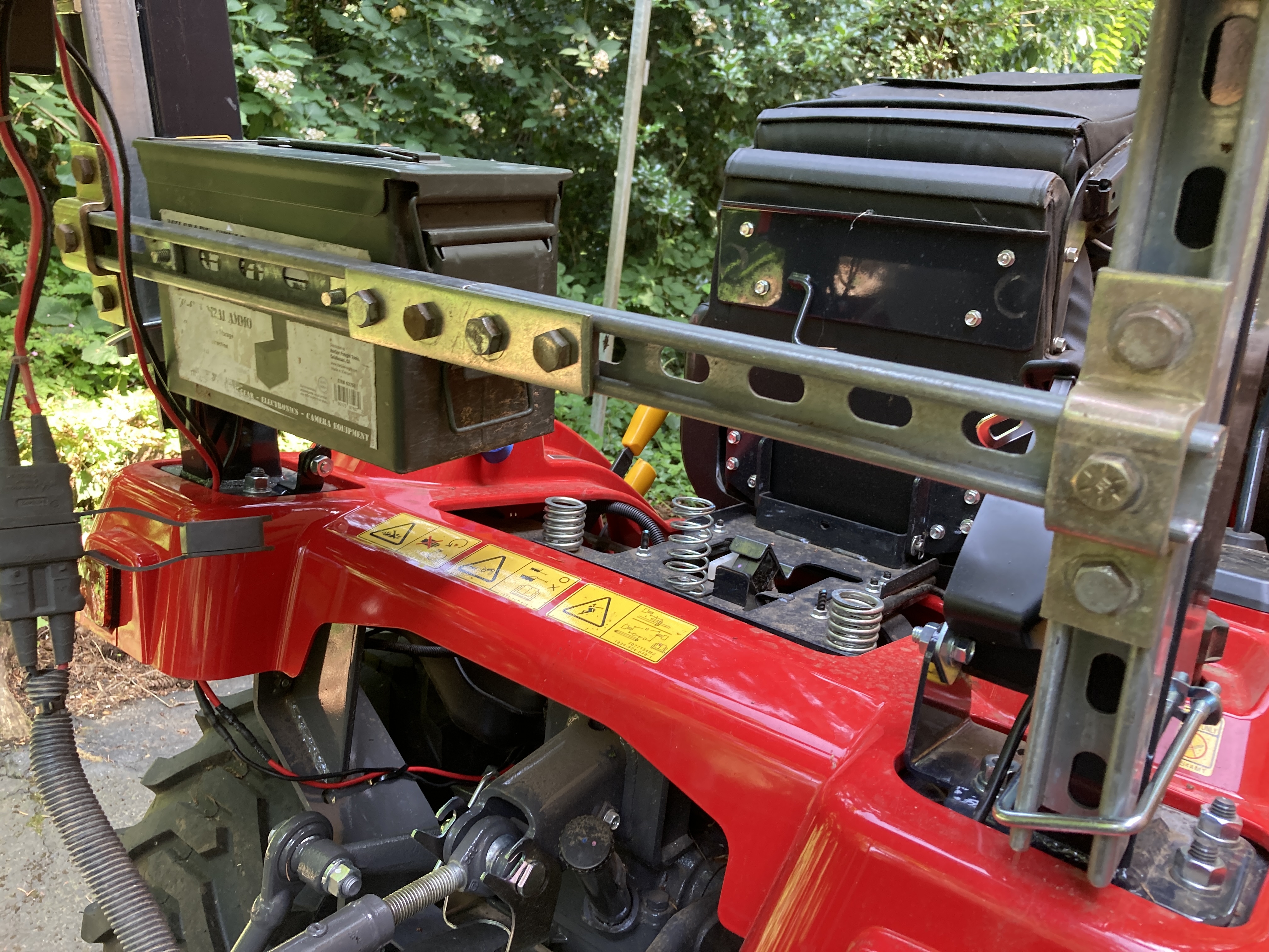

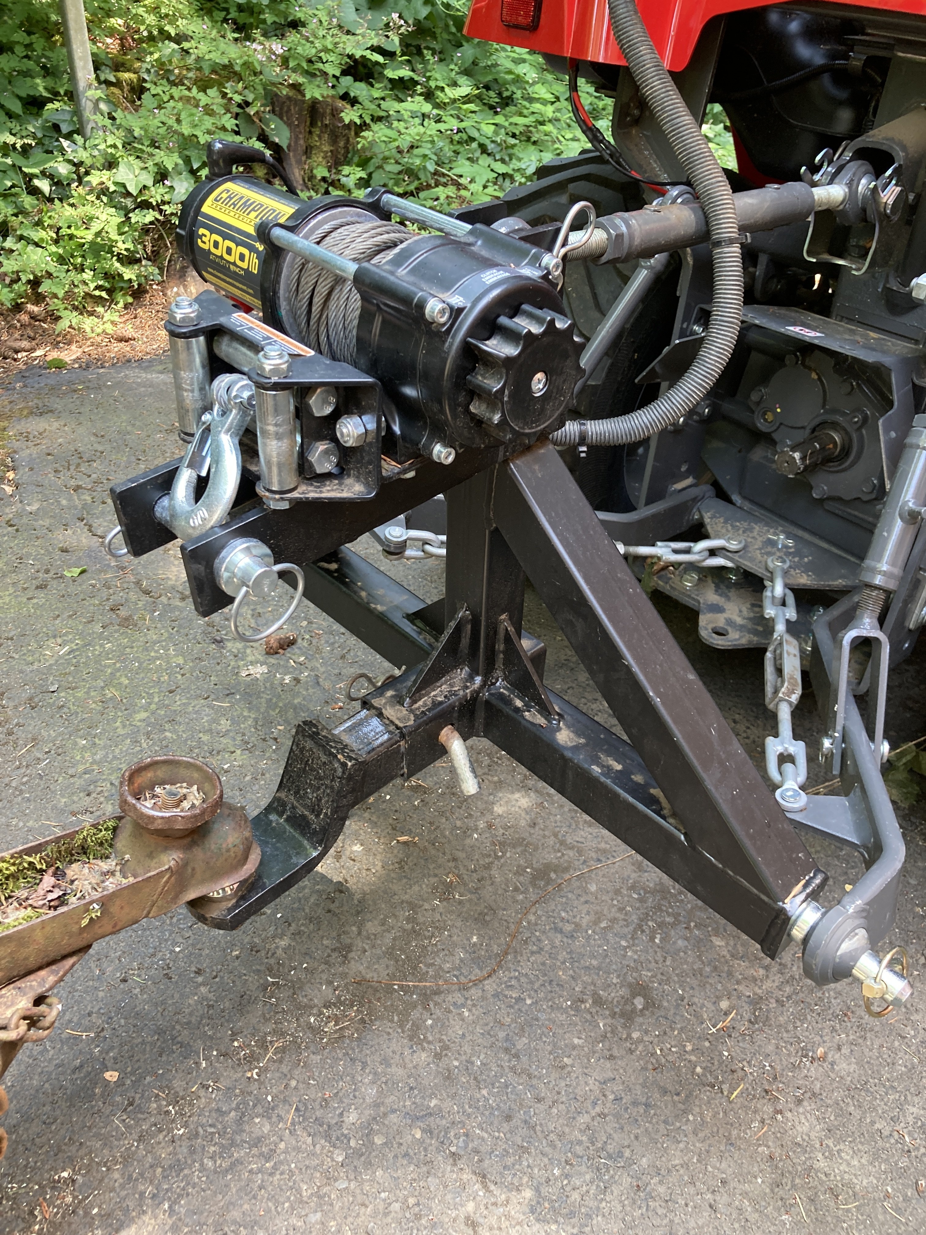

Over the past few weeks have gone through several iterations of my tool storage issues and think that I have it dialed in. Also got my winch mounted.
Attached some metal channel framing (strut), AKA Unistrut or Superstrut, to the ROPS with some long U-bolts that I got from the Bolt Depot. Then built a wooden tray and mounted it to the strut with angle braces.
Next I got my winch attached to the top of the 3 point trailer hitch.
The wireless controller of the winch is mounted under the tool tray. I used Anderson connectors to be able to disconnect the winch from the controller.
Next I mounted a strut crossmember to the vertical strut and then attached an ammo can to use as a tool box to the strut. It fits nicely behind the seat and is easily accessible.

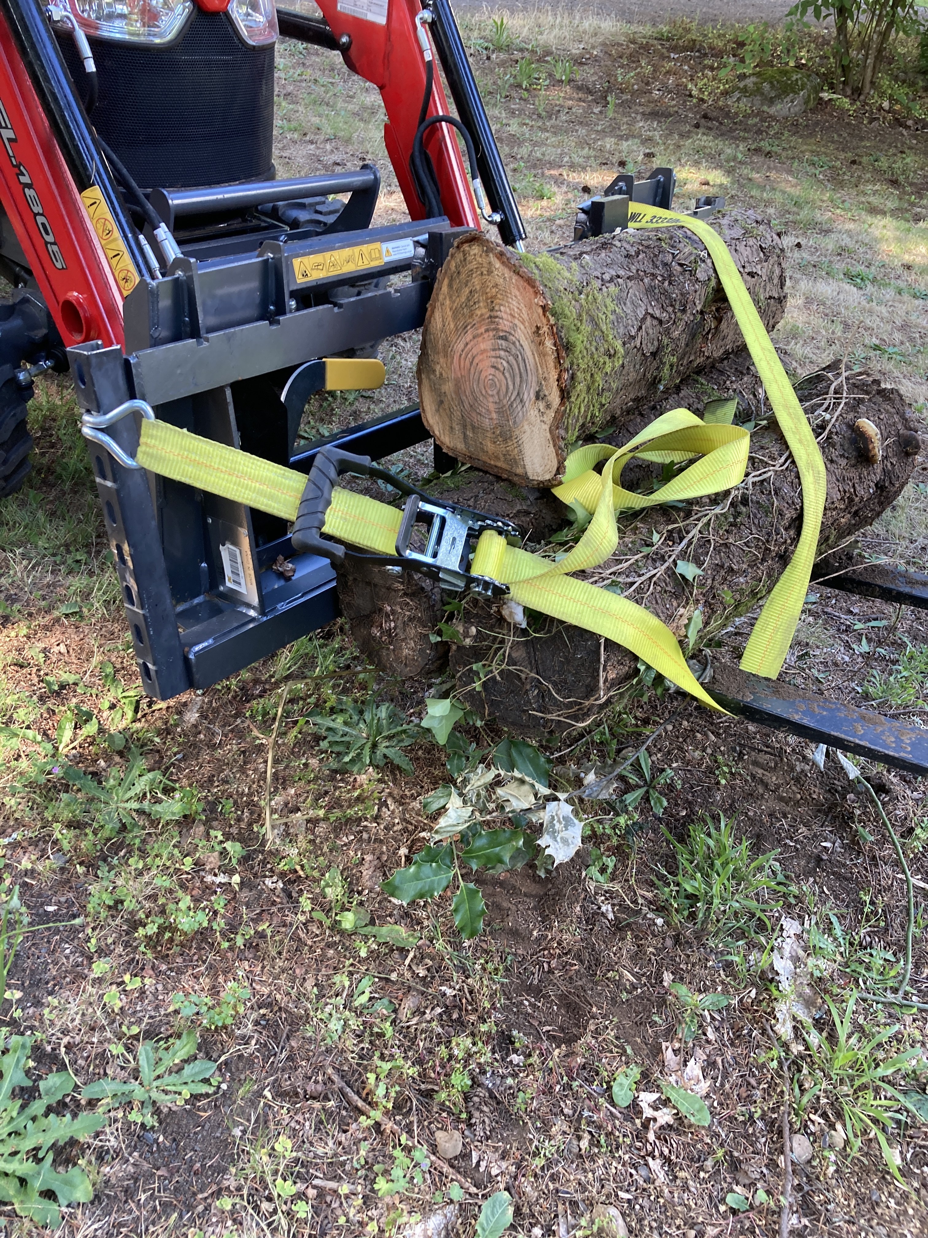

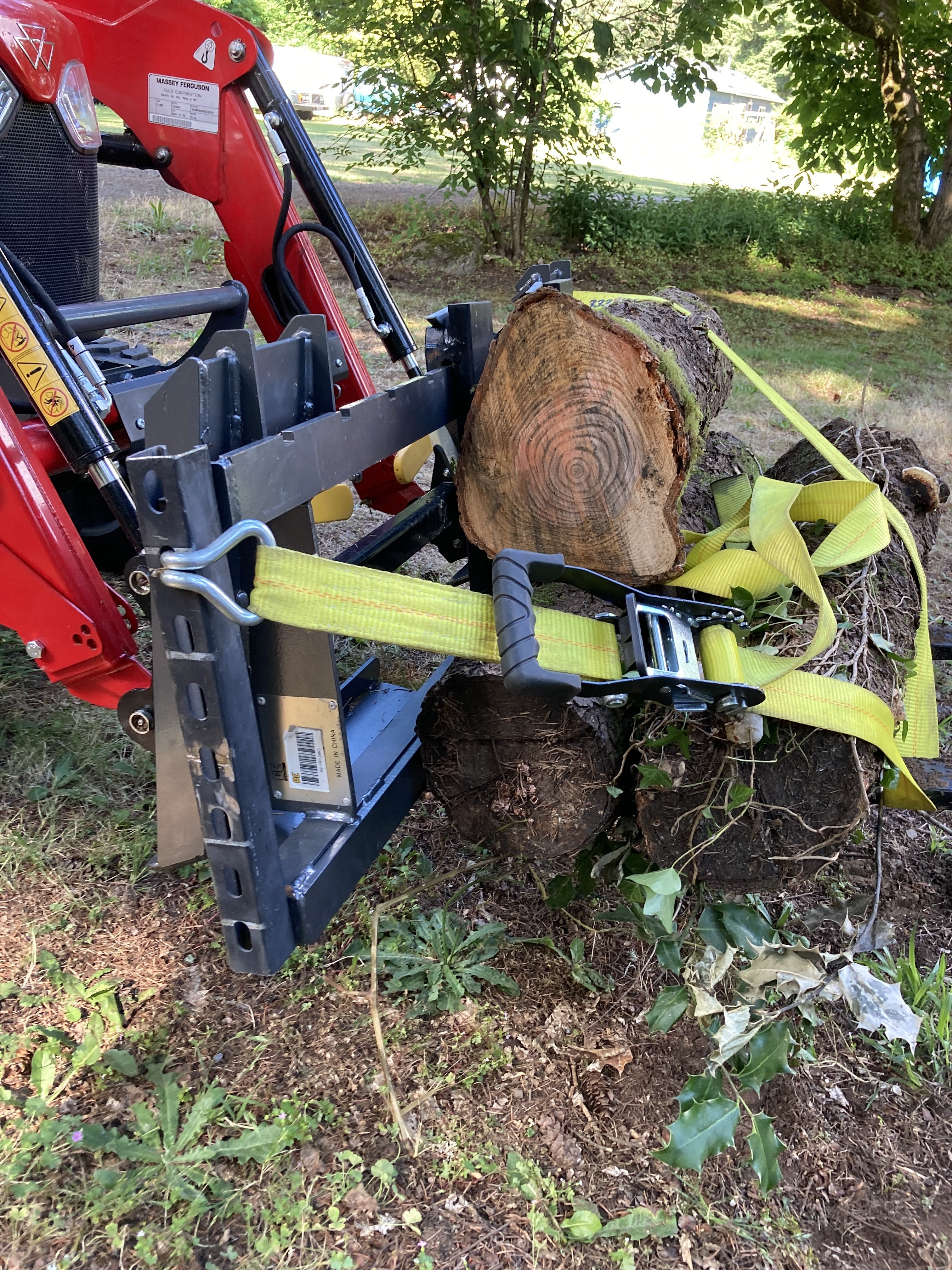

Added some metal channel framing to the side of my forks so that there is something to attach the ratchet strap to. The straps help keep the logs in place where they are being moved from the lower field to the pile near the house.
