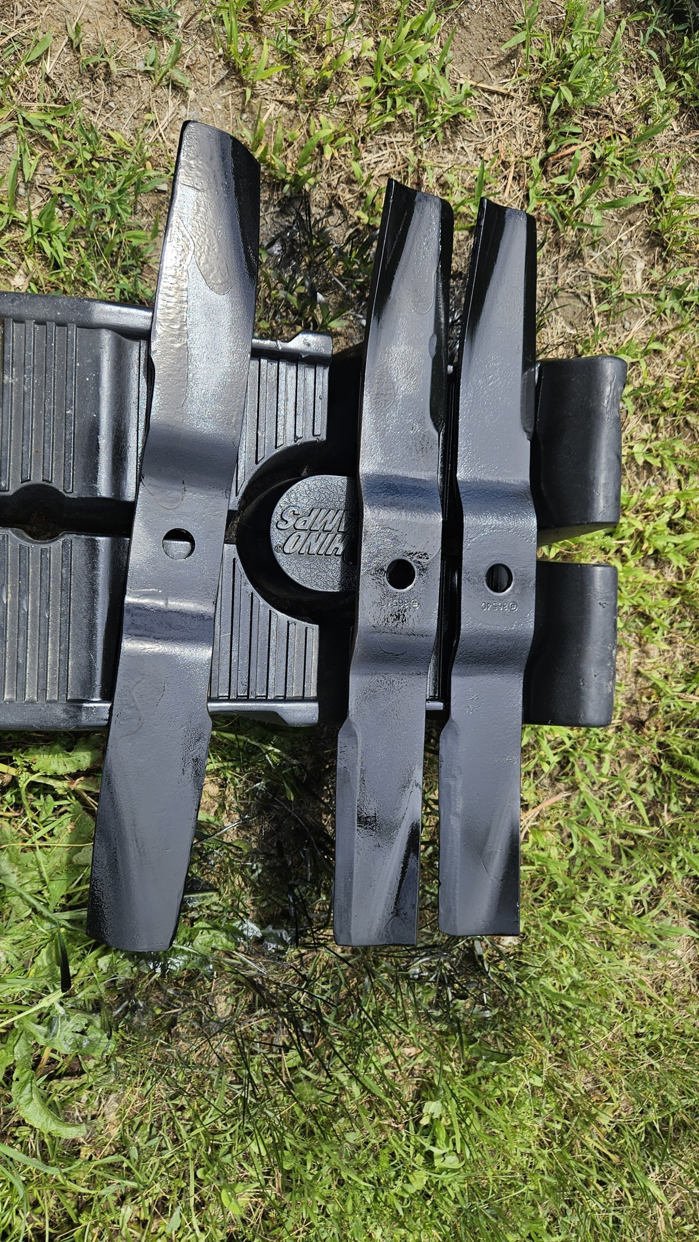

the DL100 FEL on the GC2400 makes a GREAT tool (along with a c-clamp) to clean 2326 MMM blades on.
3 blades, only showing 1 blade.
rusty.
wire brush on 4" grinder. only hit my hand/fingers once with grinder.
all cleaned and painted and I will sharpen in few hours.
these 3 blades were bought 5-21-2021 and have over 70 hours usage on them.
every time mower is due service I put fresh blades on.
was one time I had to service unplanned when I broke left rear gauge wheel holder after servicing 2 hours prior. bent it back (torches used) and welded it into place and ....yup...it was off.... blade swap. hard enough getting these things on and off, if in doubt do a blade swap.
thats if you have a fresh set of blades always on hand. I always have fresh set on hand. I have 2 blades from original purchase in 2020, they are not painted but they are good to go. so at ANY time I have 5 blades ready to go. with the lead time on this crap and fact nobody makes aftermarket blades...i'm good and my field (notice I did not say lawn) will get knocked down often.

blade service time
3 of best tools ever made. tractor with bucket, c-clamps, grinder that takes different heads.
the 3 in rotation already done and waiting for paint, these 2 are hot swap spares, original from 2020 when I got the 2326 deck.
