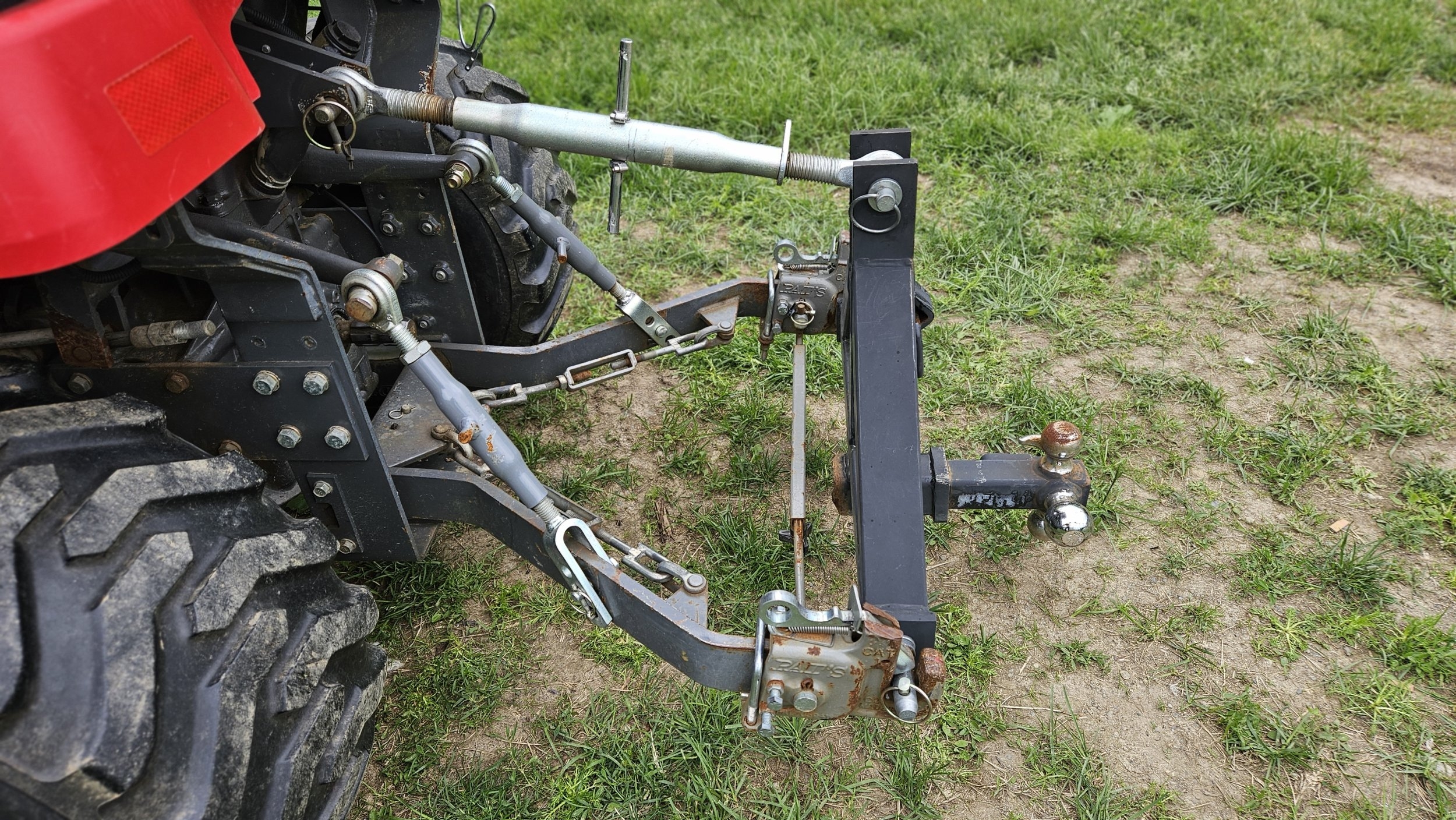

installed QH
edit: excuse the blurry images, my hands shake
Forgot to add, I have to go out and buy a new top link. The one that came with the tractor is 2" short fully extended to hook up my snow blower. Have not tried the tiller, I figure I'll go out and pick up a couple different length links from TS in the next couple of days.
I use this on gc2400 with pats and works fine on tiller (woods 48.30) blower (blizzard 54") countyline 7ft grader blade a BB20-60 5tine box blade and a heavy hitch H2TBD cultivator\bedder\hiller with s-tines and row maker
with that being said my stock link did also, only reason I replaced it was due to end being bent and when needing to place the 7ft grader at a VERY non-aggressive angle I could not, it would bind. but this one from tractor supply has more adjustability in it. make sme wonder if top links on non backhoe GC units are different than backhoe units. never looked.
only issue I had was the adjusting rod has the 2 "slots" on it while the hole in link did not. yup no adjust. so I turned one side of rod down (ground off the 2 raised slot tangs) inserted rod and used two 1/4" hose clamps, one on each side, to permanently mount the adjust rod.
edit: TS has one slightly longer that is 5$ cheaper but I needed to collapse to 19 inches, this one collapses to 18".
this is with 2 kubota side link leveling links. I needed ability to maintain lift height at lowest point on one side with ability to have other side higher for road grade.
at same thread length as org ONE massey adjustable link the bottom hole on link come very close to massey length. and is 75$ cheaper. so I bought 2 trimmed the turnbuckle handles so can adjust at full height then ran (same thread length) in middle slot. lot more height and lot more adjustability.

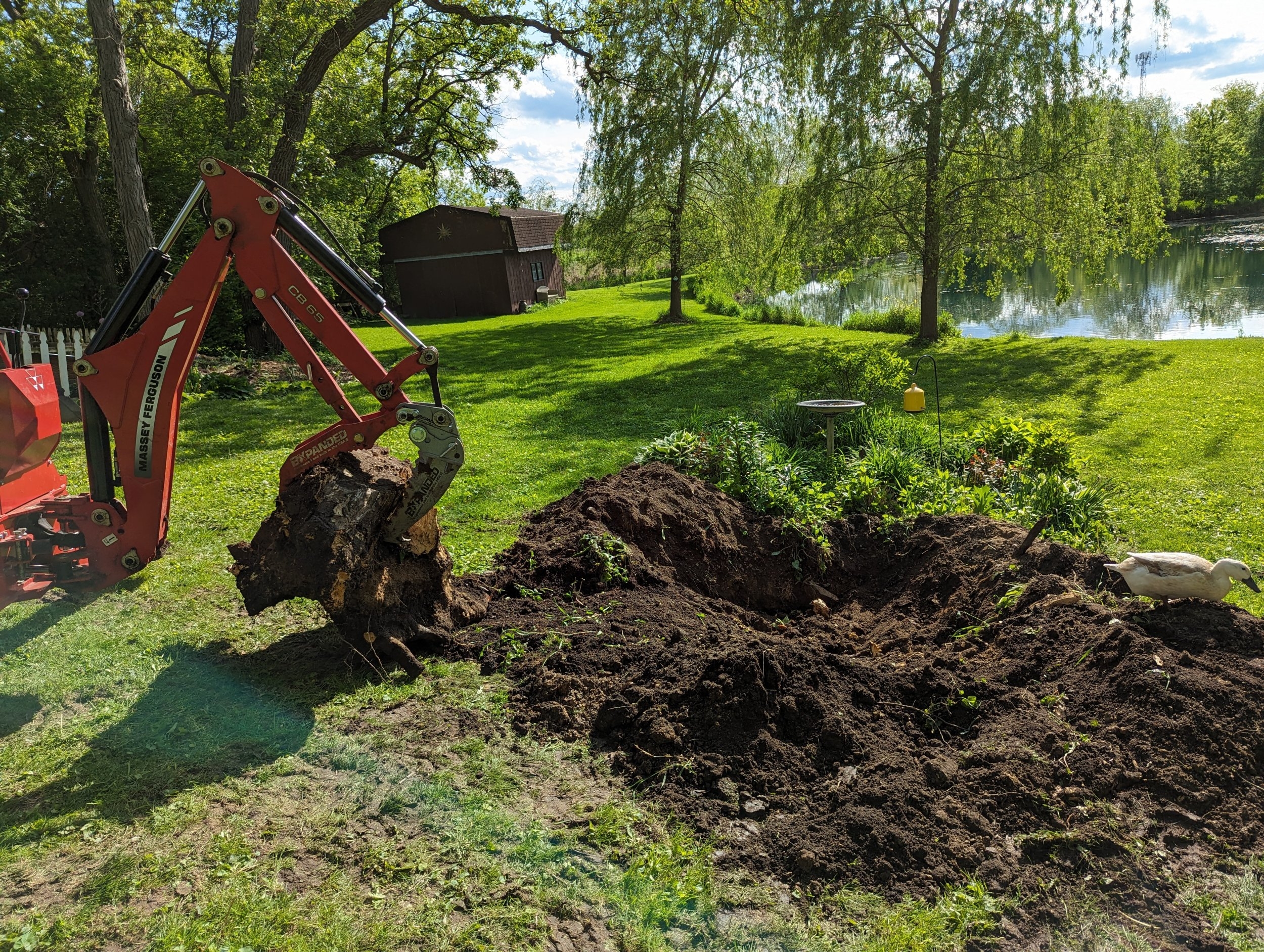

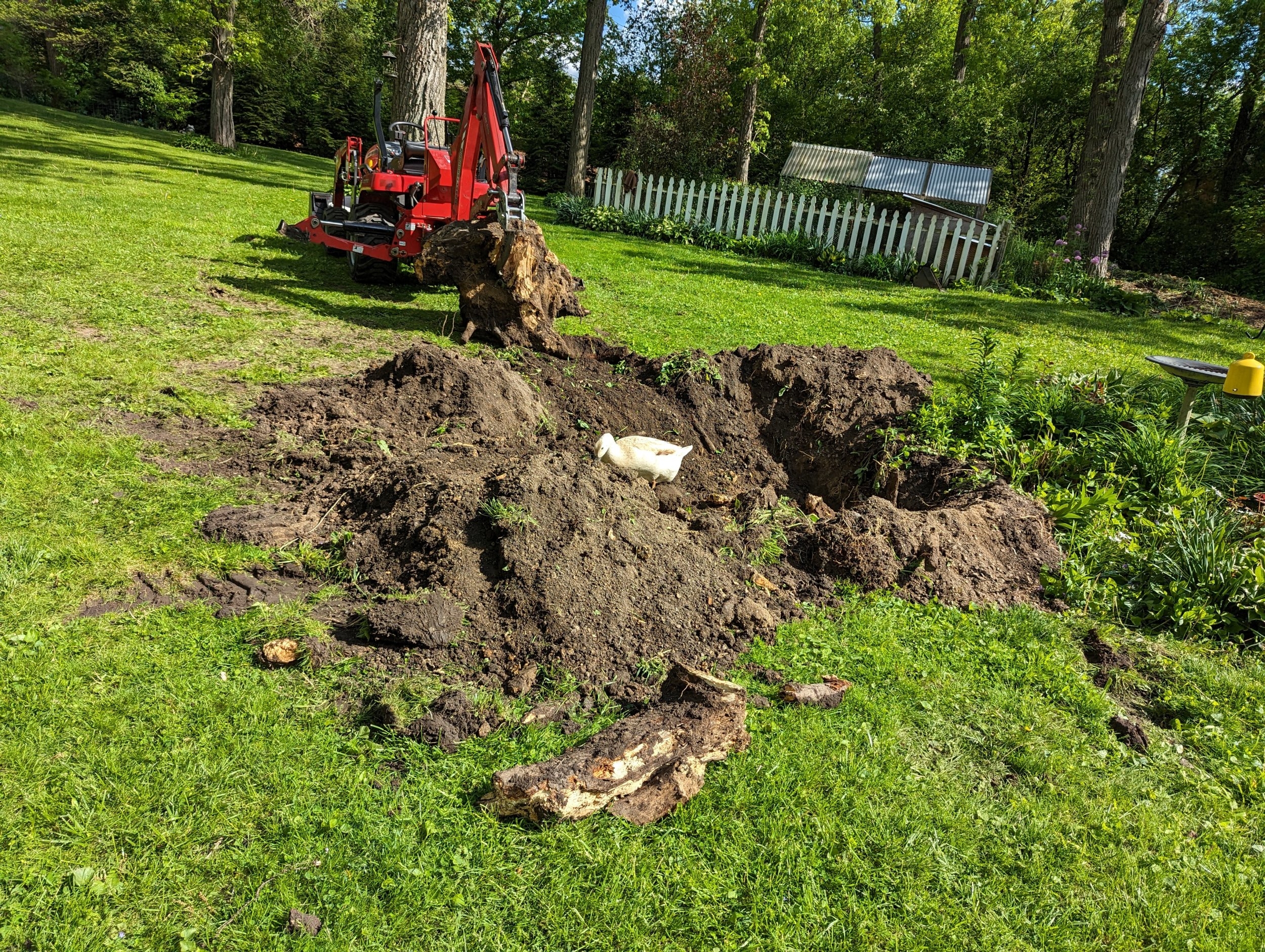

I've been slacking on this TBN, this was from a few weeks ago.
PXL_20240511_170840211.jpg PXL_20240511_213706570.jpg PXL_20240511_213657405.jpg
