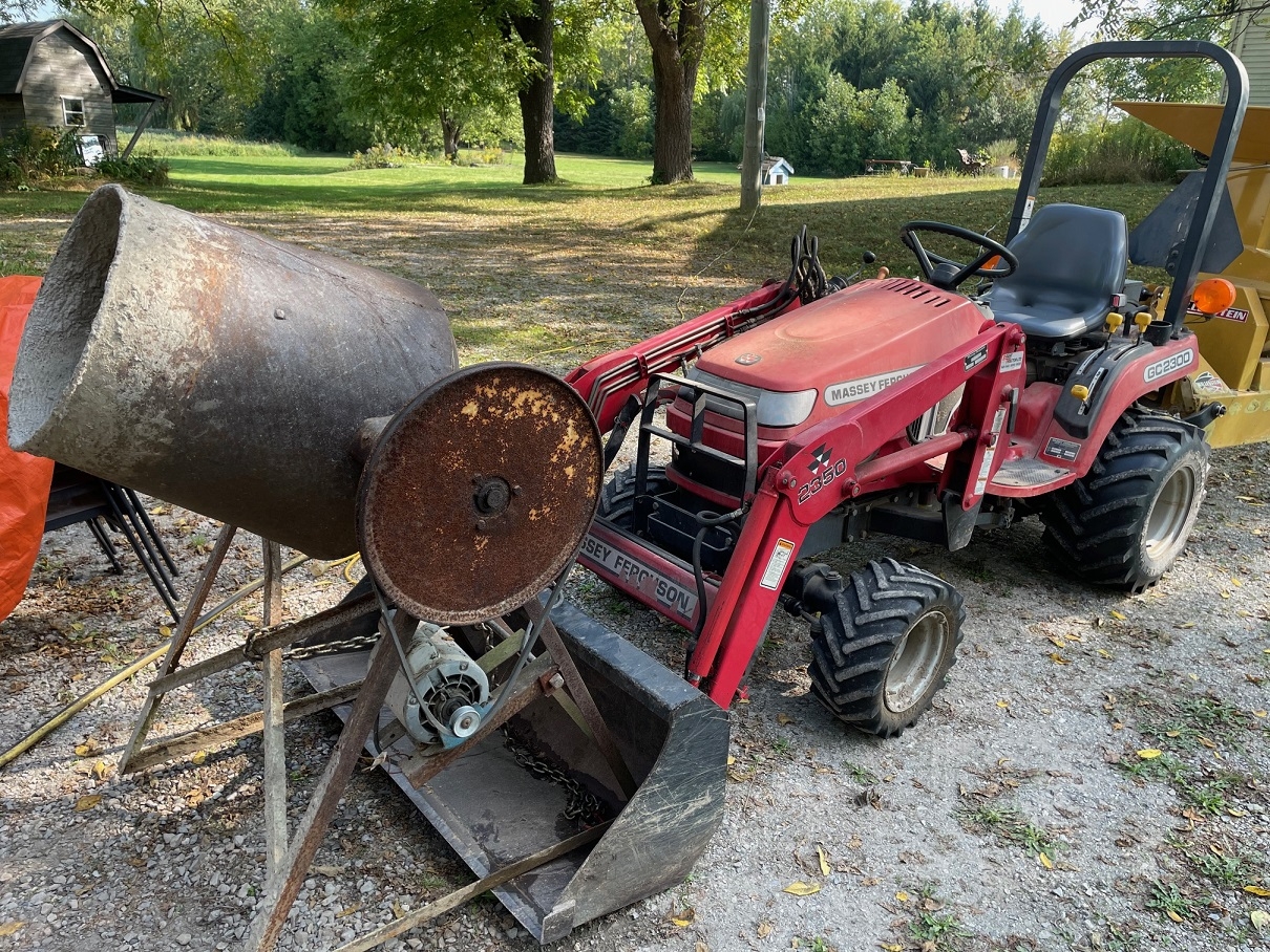

Got the mixer out to pour some cement pads in an old gravel floor shop. A lot nicer mixing it outside than inside the building.
