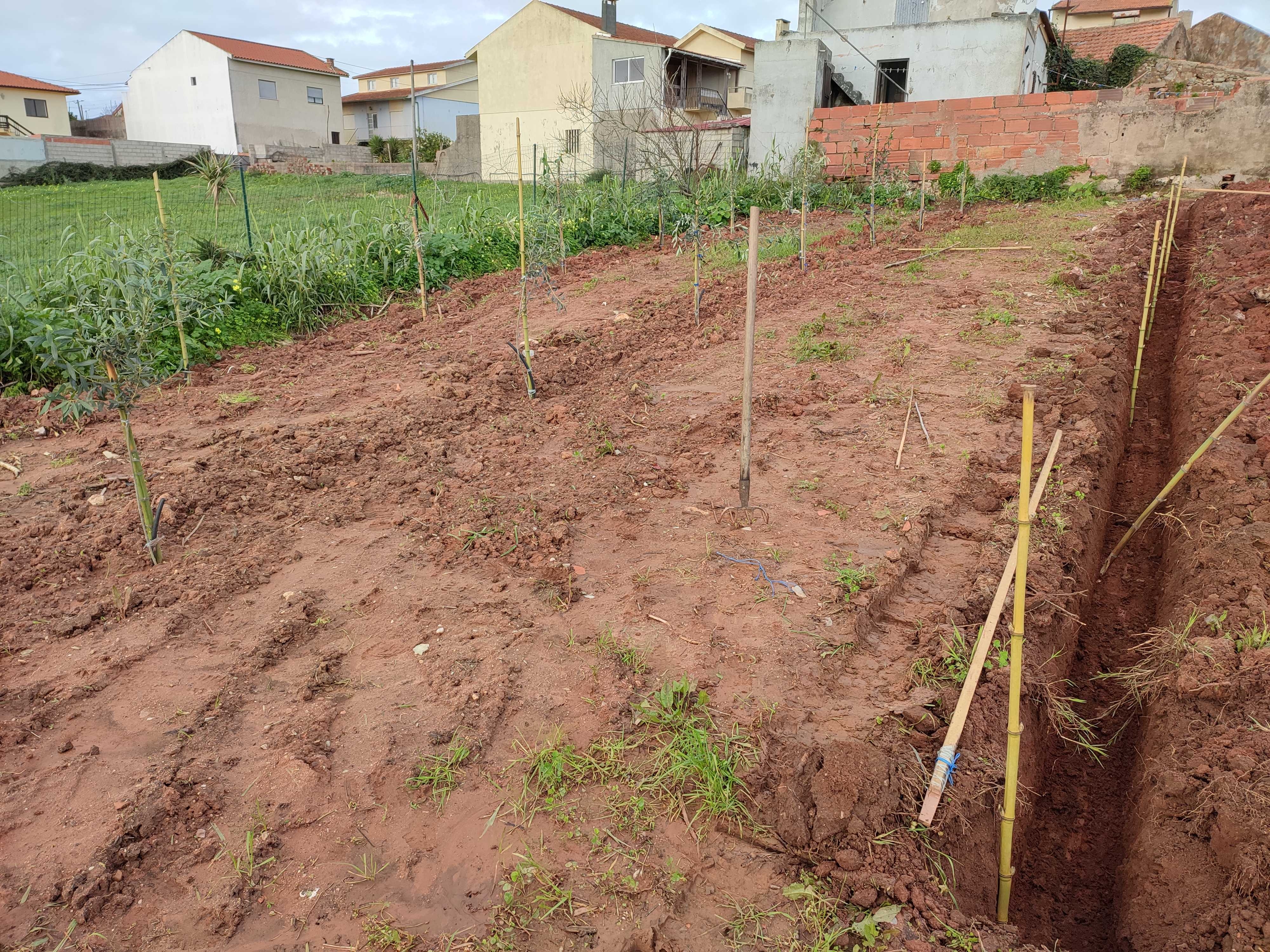

This was the beginning of the olive tree orchard we did about about 2 years ago. A trench more or less straight about 60 cm deep, deep enough to not have an issues with the subsoiler, then we put those bamboo canes where the tree is going. We then placed the pipe with the T fittings and emitters. Put a layer of dirt on top of that so the trees wouldn't sit so deep and finally we put the trees in and covered everything.
I do have plans to extend this orchard out by 2 more rows, make it about 40 olive trees in total. Then I another section of the land, I'm planning on a new olive tree orchard with about 70 trees.
