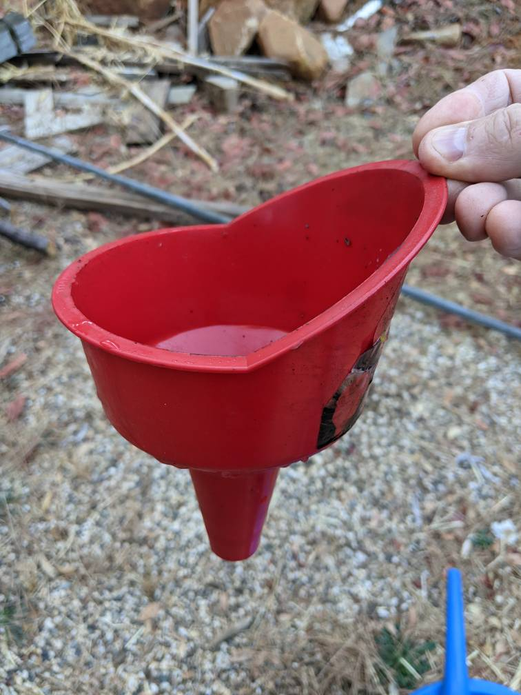

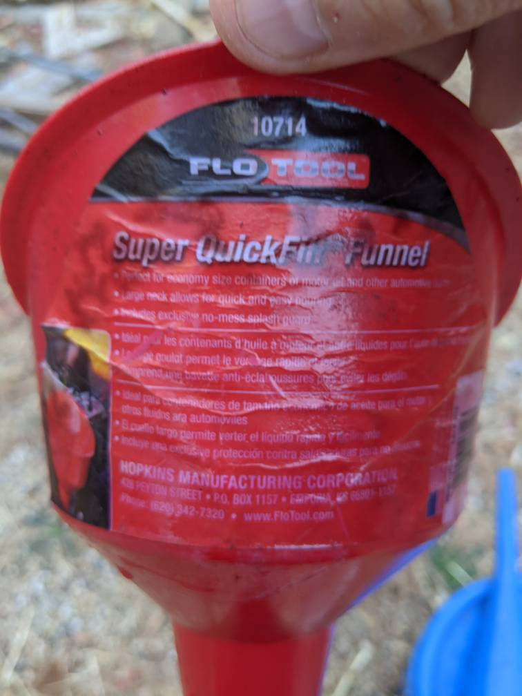

I have a bucket pump that I used the first time I swapped my hydraulic fluid, but this time (a few weeks ago) I found this funnel in my shop (idk where it came from as I don't remember buying it) and realized what you (probably) already know that the cap on the 5 gallon buckets pulls up just like on the old olive oil tins so you can actually pour from it accurately.
This funnel sat really nicely in the filler tube on my 3520h, and it was almost tripod-stabilized by the 3ph:
Glug glug poured in superbly and only overfilled slightly - assisted by using some red dye this time so I could actually see it!
With the short wide funnel spout it's also really easy to clean.
(AFAIK, no harm will come from overfilling as the tank isn't a sealed reservoir; worst case you get a mess coming up and out the filter tube.)
