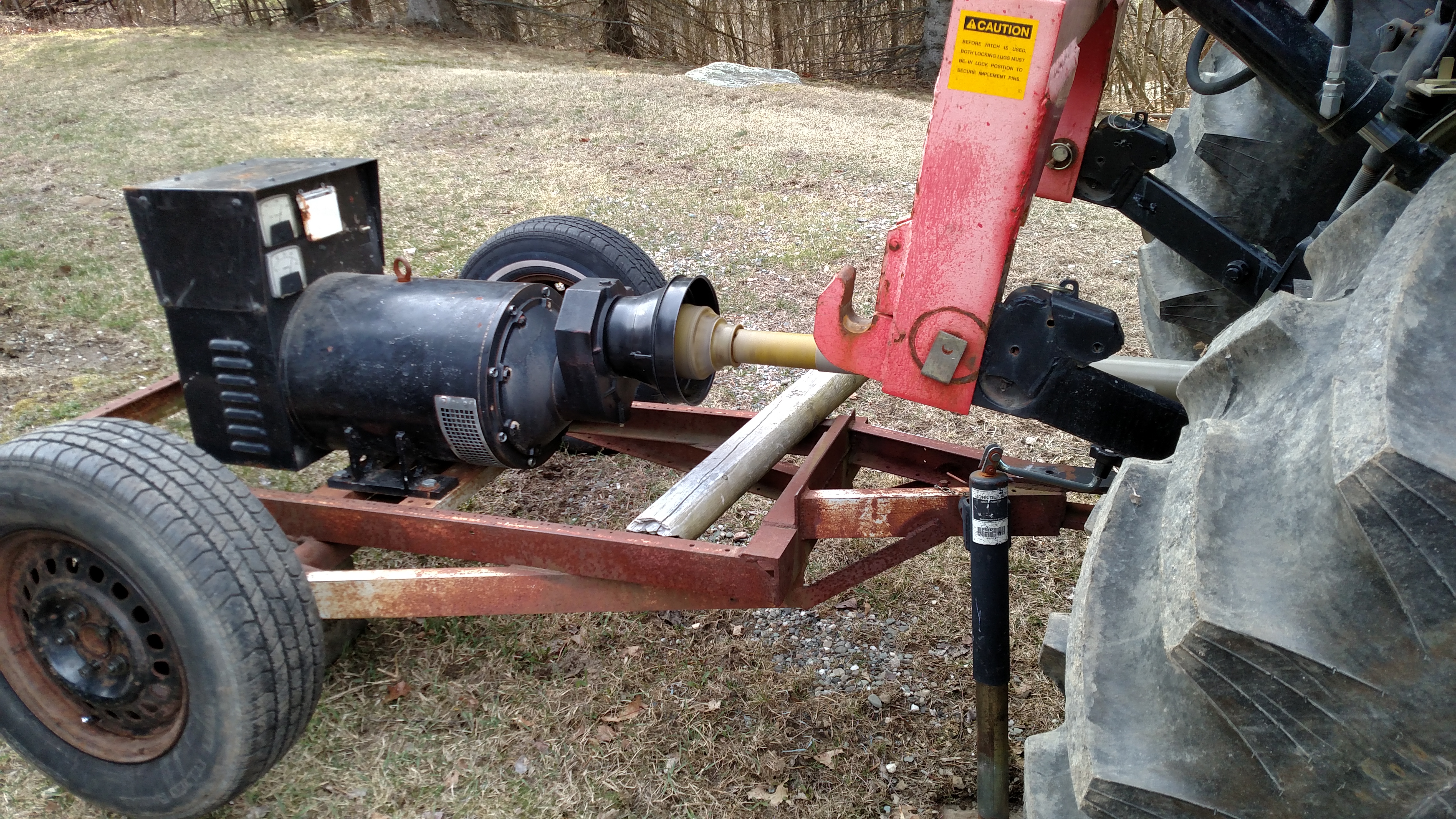

I feel for you too, Lou. I am always amazed at how I hear of new ways that people use their tractor. Tell us about your PTO mounted generator, I've never seen one.
   / What have you done to your Branson today? #462

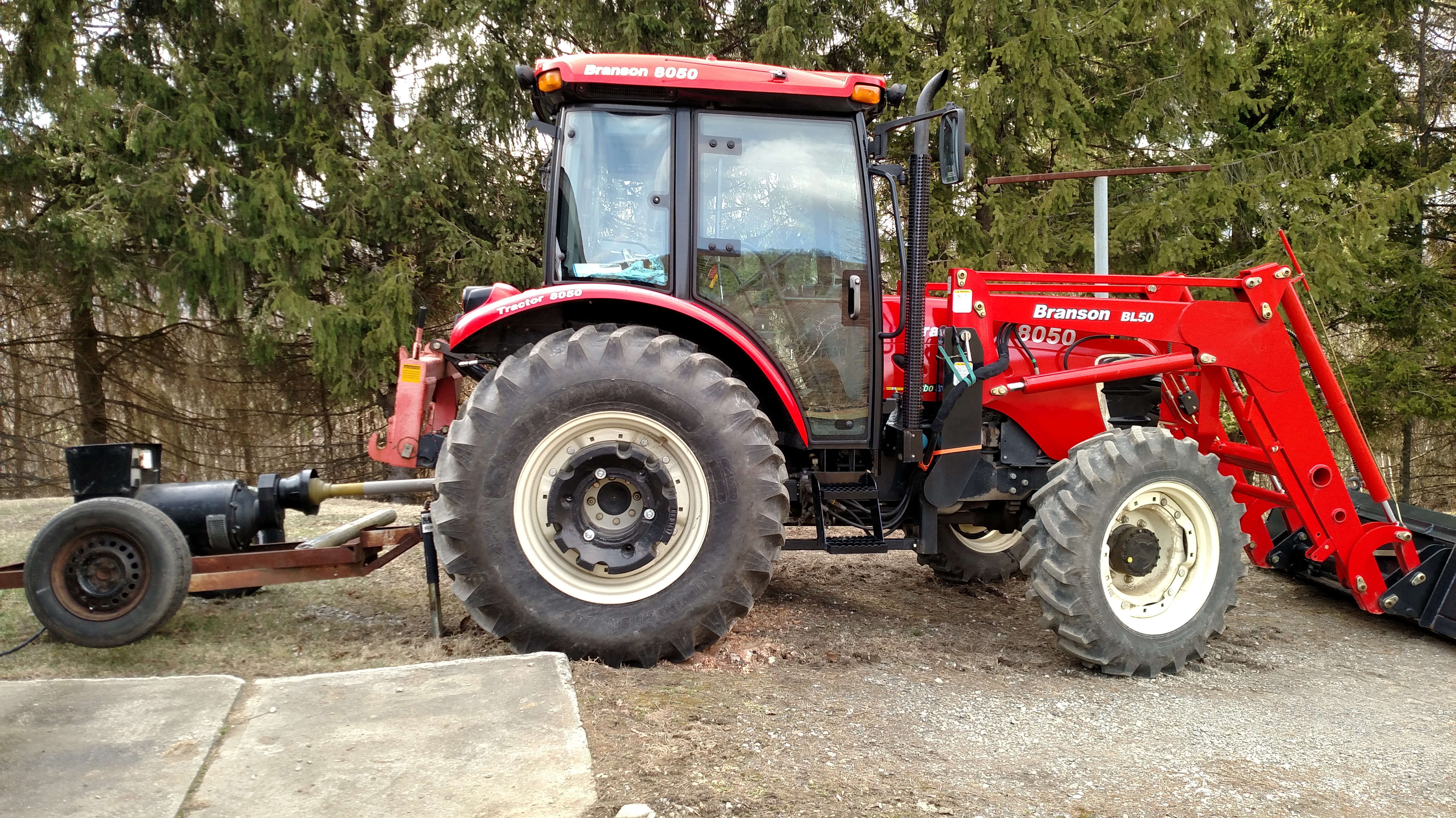

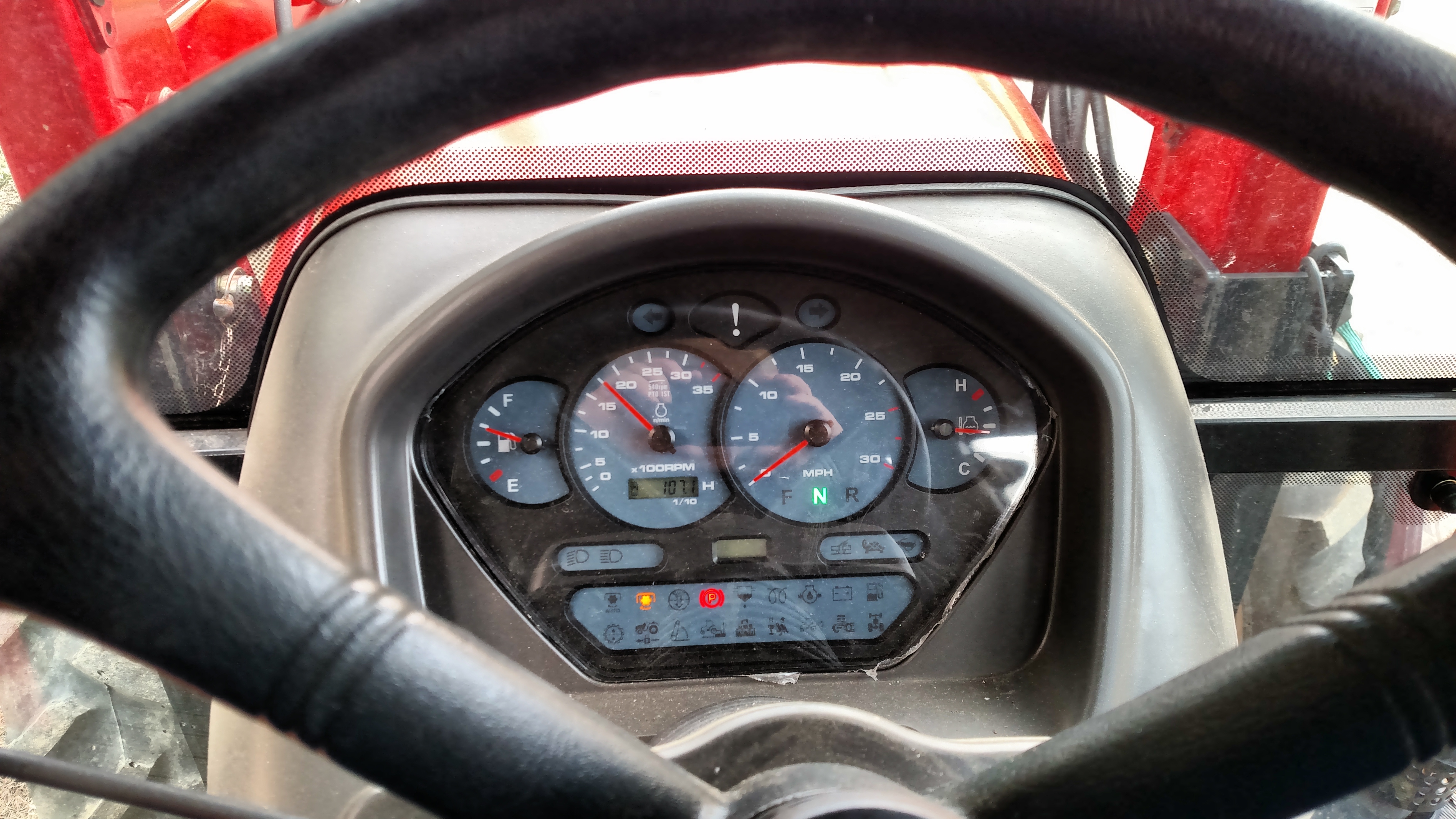

Here are a couple of pictures of it from back in 2016;
in the interior picture you can see the engine rpm required for the economy mode to output 540 pto rpm which provides 60 Hz power.
IMG_20160321_170856851.jpg IMG_20160321_170926996.jpg IMG_20160321_170935614.jpg IMG_20160321_171000162.jpg

Nice rig Lou!
Does it bog at all in 540E under load? How many hours do you have on that beast now?
   / What have you done to your Branson today? #464
No noticeable bog with any load changes, I am not gentle with it when I put it on line.
I don't go thru the house breakers and turn everything off then bring them on one at a time,
I just flip the transfer on to generator with what ever wants power at that time, have never seen more then a 1 hz change for a second or so.
That is a 25KW generator but my normal load is usually less then 10 or 15KW.
I'm around 800 hours or so on her, maybe a bit more.

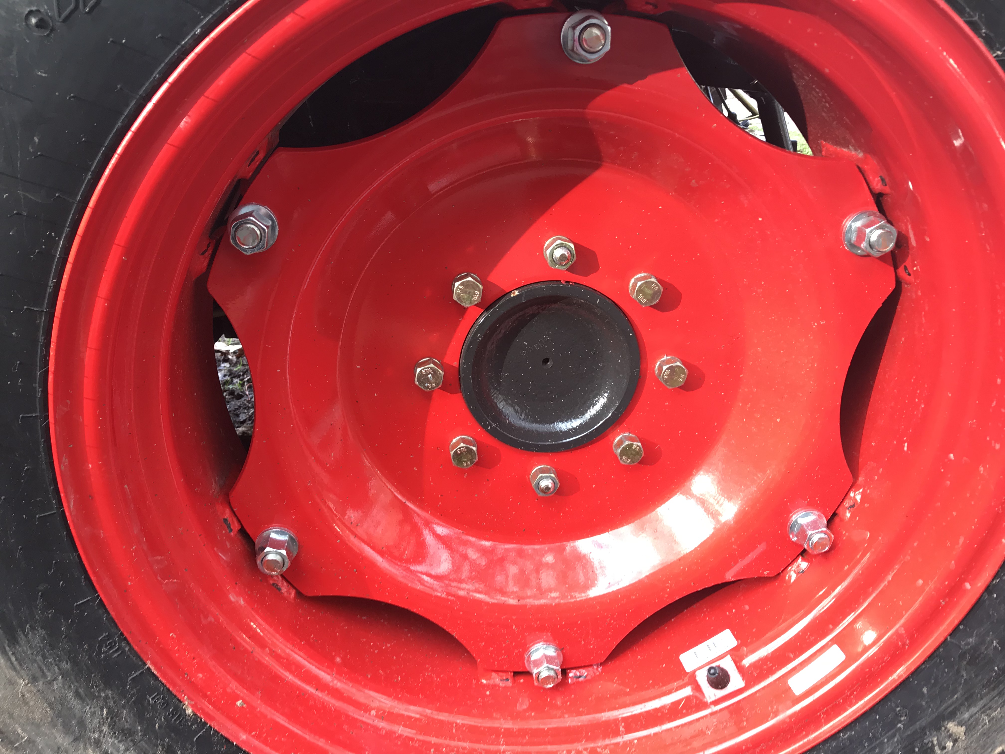

Thanks for the information. I think I know why the don't list the 15 series, at least if my rim is like the others. No bolt holes for wheel weights. I would have to drill holes so for now, I am going to make sure the tires are as full as possible then look at building a ballast box.
   / What have you done to your Branson today? #470
Interesting. The older white wheels, had the holes pre-drilled for the counter weights. Looks like the new wheels don't have the holes.
