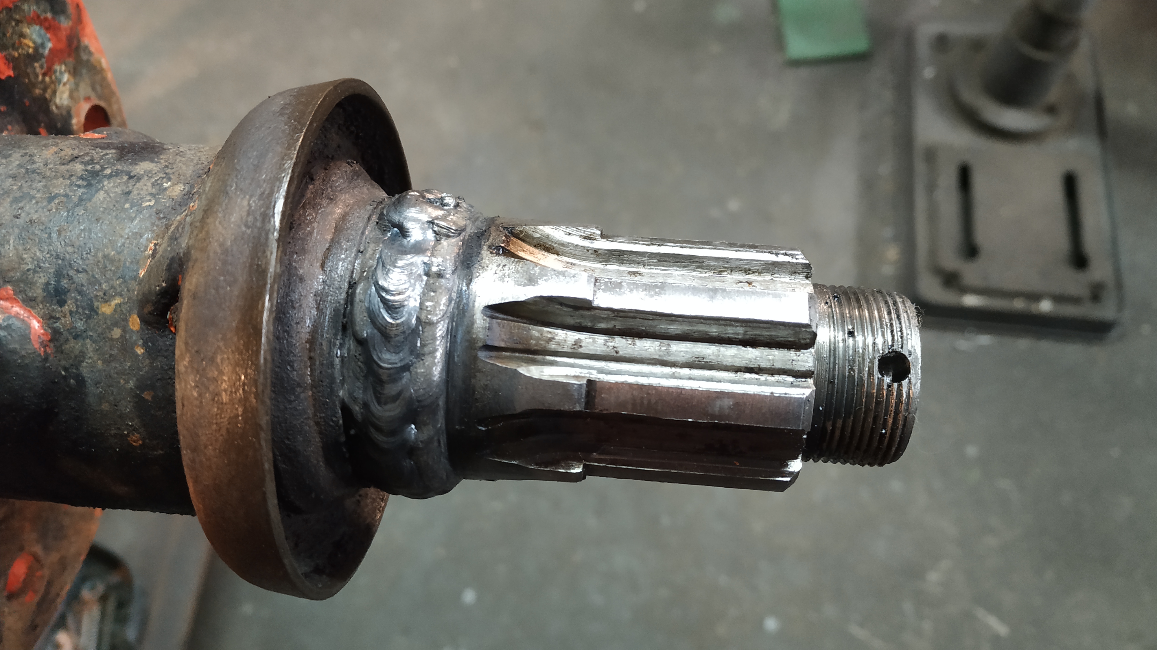

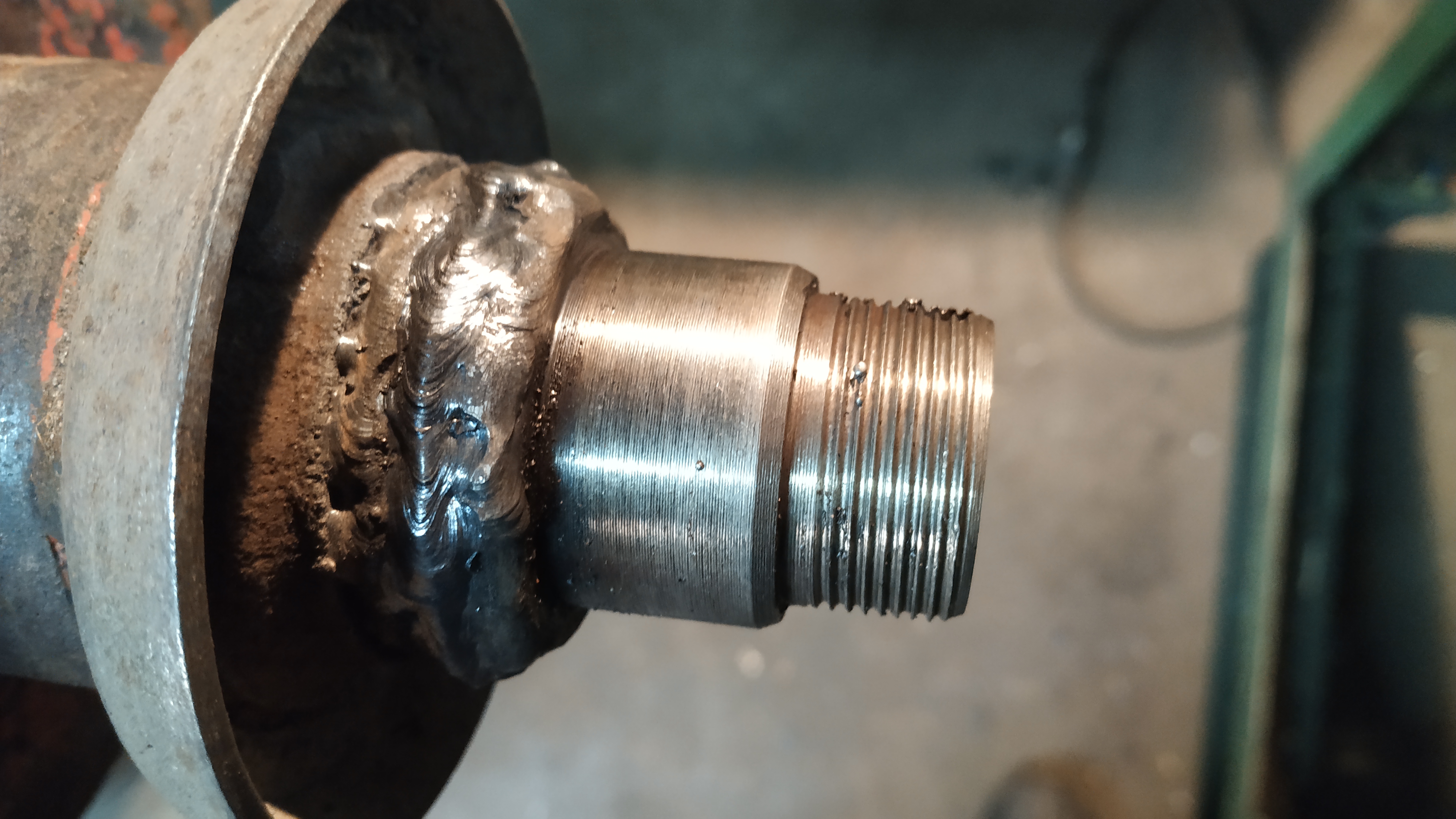

Finished the rototiller today and it's back up and running again.
Some pictures:

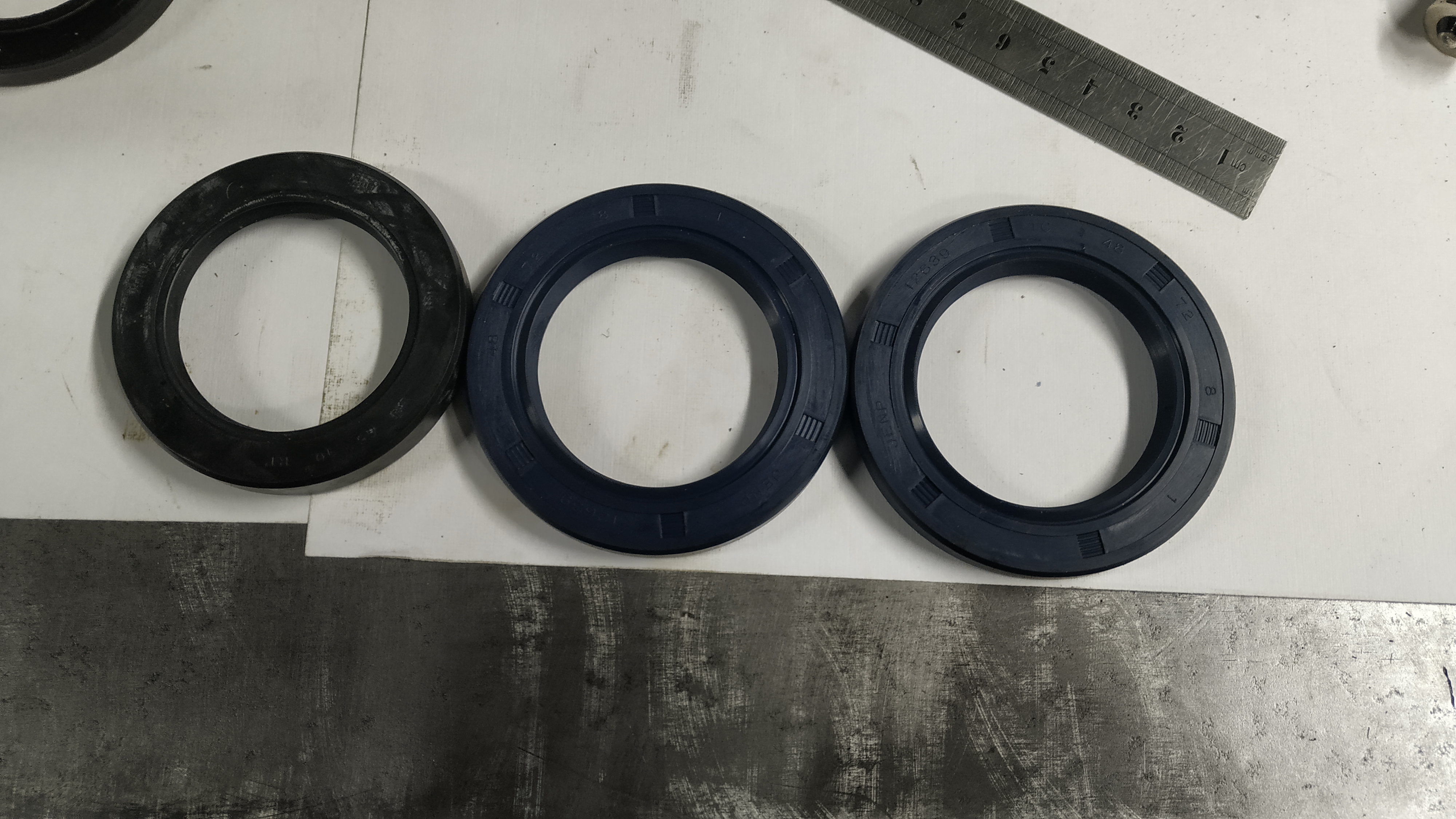

Both seal journals all welded up and read to get machined with the new seals ready to go in:
View attachment 643791View attachment 643790View attachment 643795

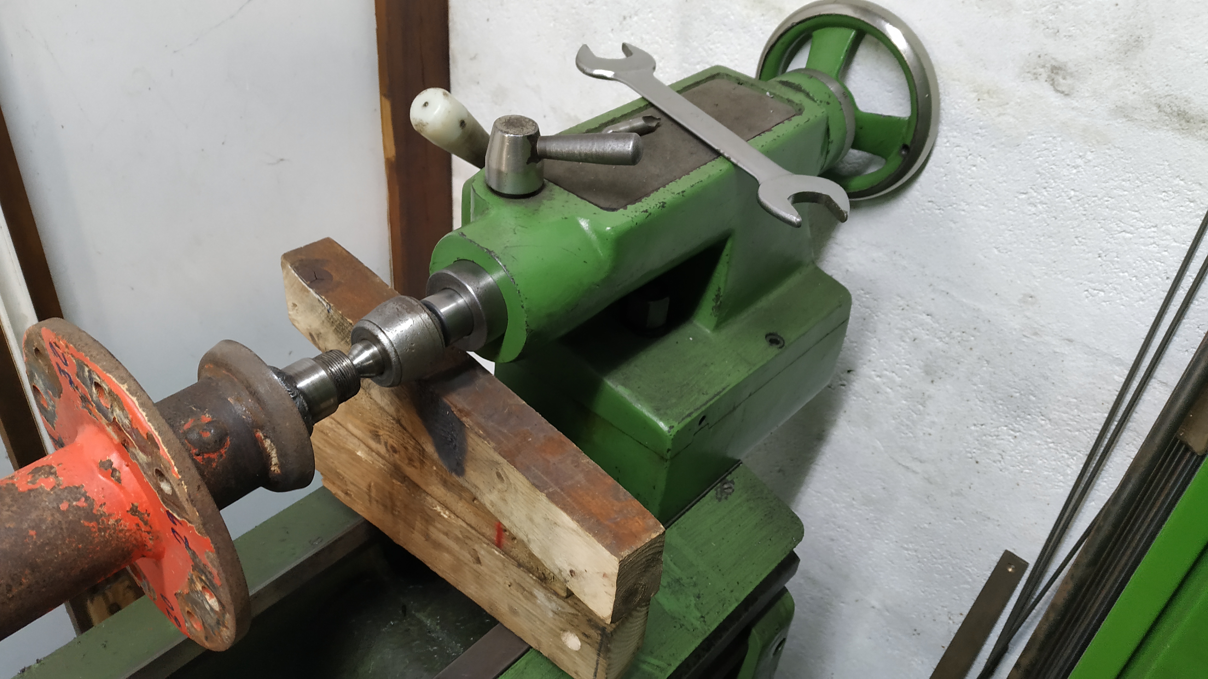

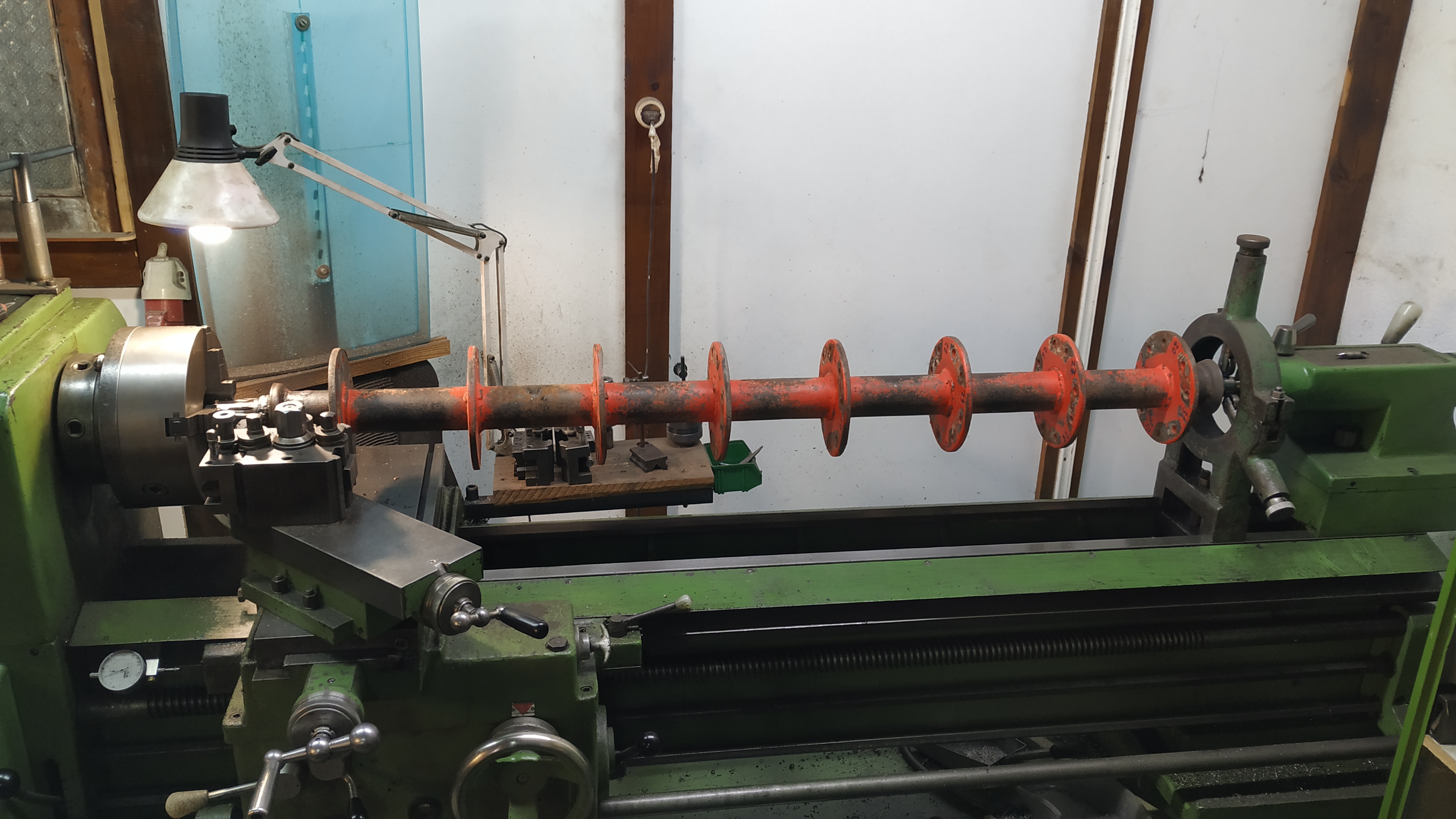

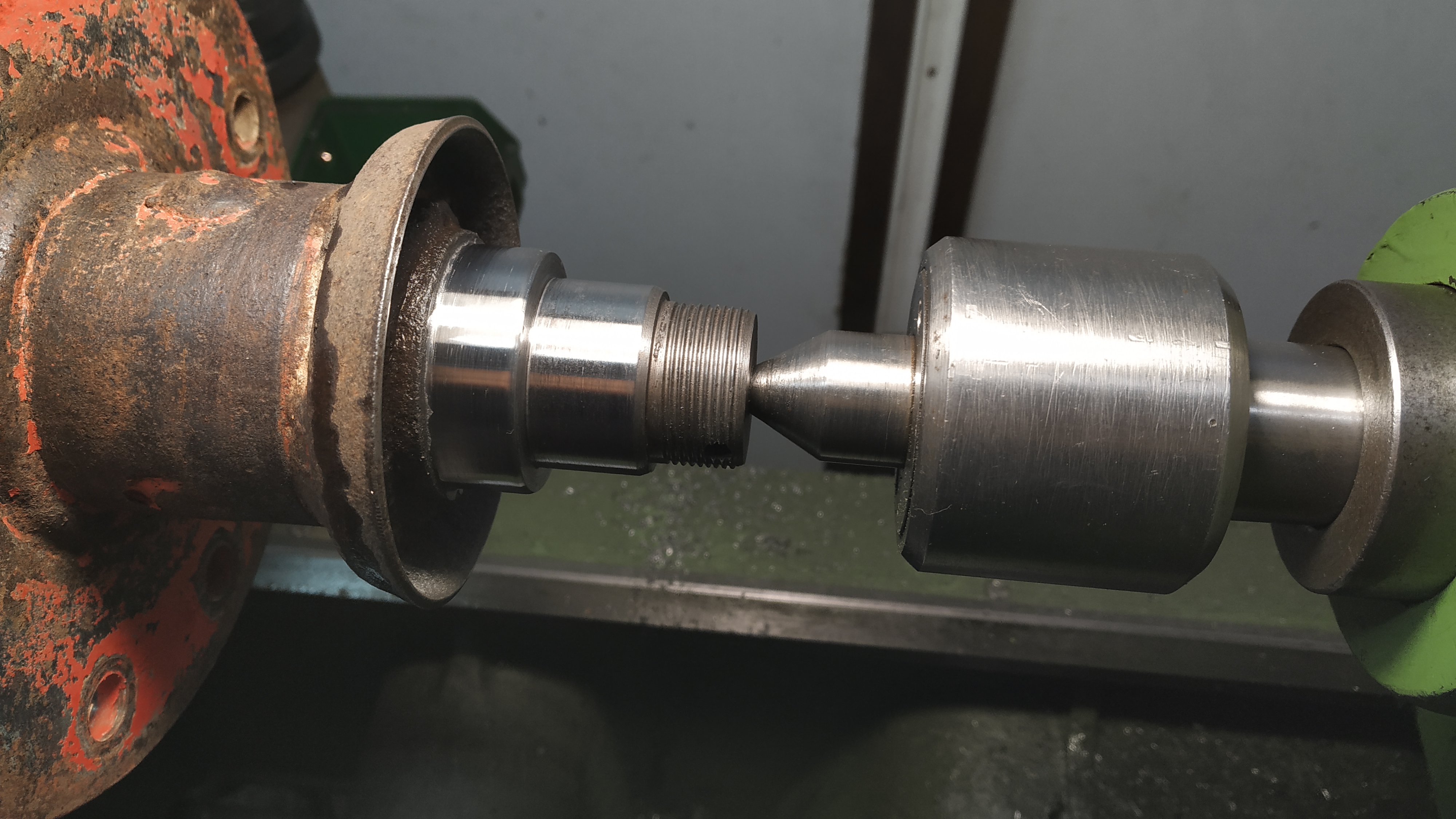

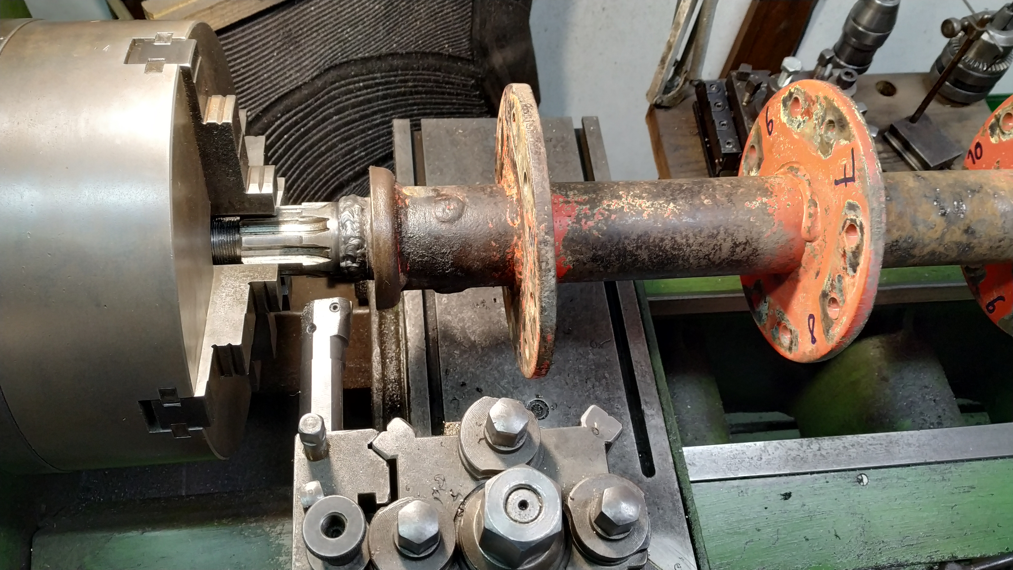

The rotor on the lathe. Had to stretch every millimeter out of this lathe. The tail-stock was hanging halfway in the bed ways and still had to get fancy with the tooling to be able to machine this.
View attachment 643787View attachment 643789View attachment 643792

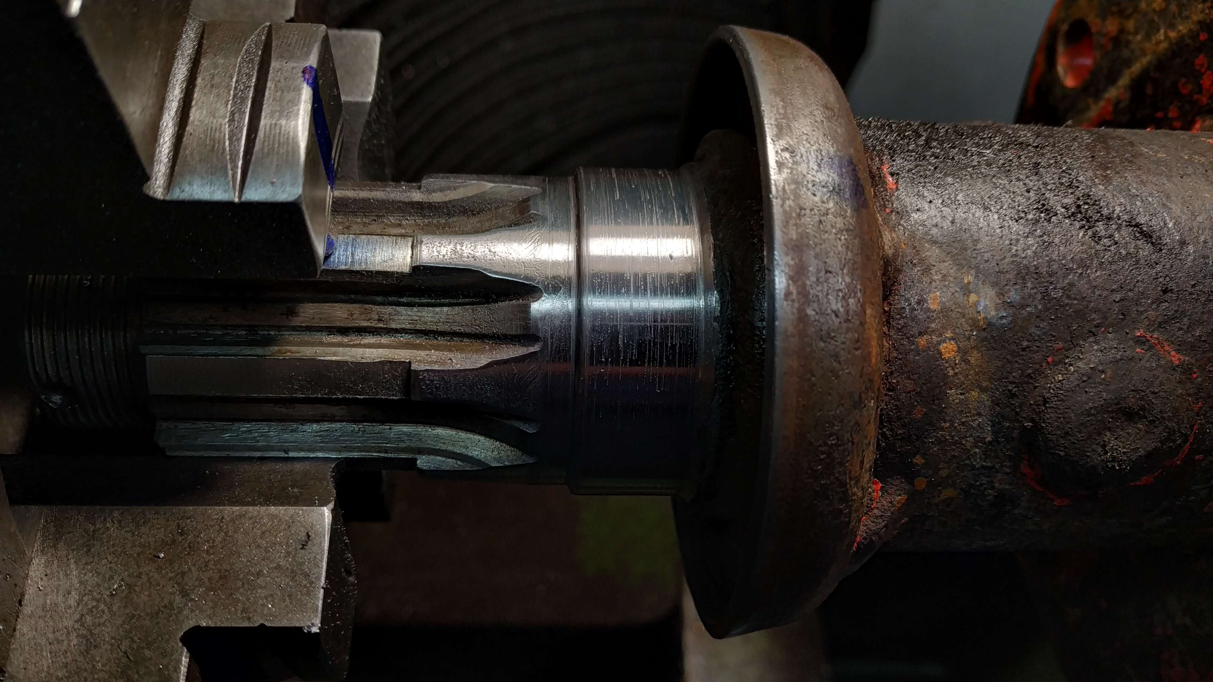

And the finished journals all polished up and shinny.
View attachment 643793View attachment 643794
Didn't take any pictures of the finished tiller but it still looked like a tiller and had no extra spare parts. :D

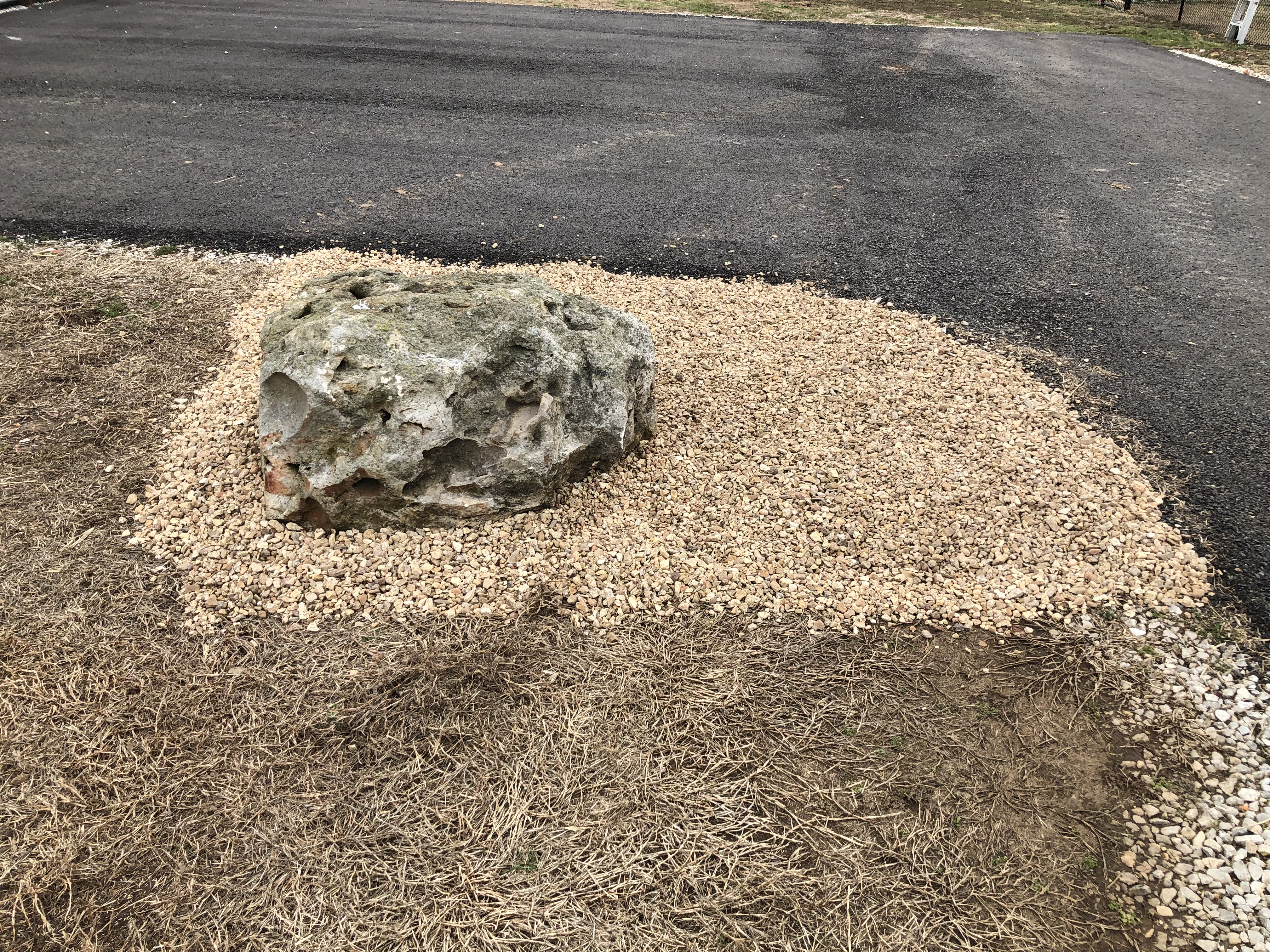

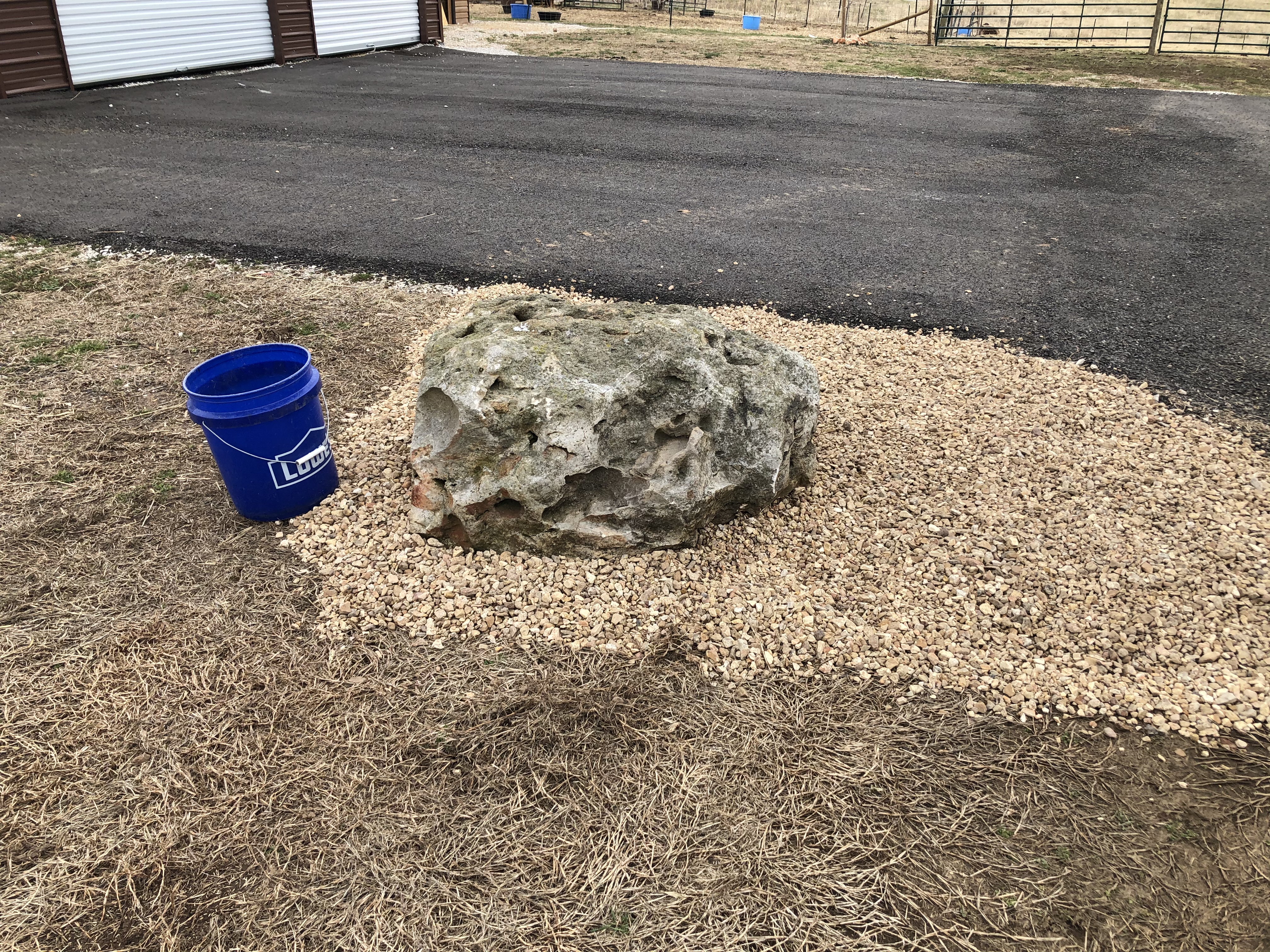

Moved a pretty big boulder yesterday. Tractor handled it like a champ. The weight of the Branson made it possible. A lighter tractor would not have handled that behemoth. I didn稚 have a nice 3pt attachment for it, so in the loader carried in reverse while basically dragging the loader, at least just touching the ground. I found it in an unexplored little corner of my property. I put a bucket in for scale.

**** that's a lot of rock. Is that the "final resting place?"
   / What have you done to your Branson today? #486
It is. My wife plans on spring flowers around it, but still a little early here. It was only slightly off center by weight in the loader. Without the loader down I was afraid I’d bend a loader arm. :shocked::)

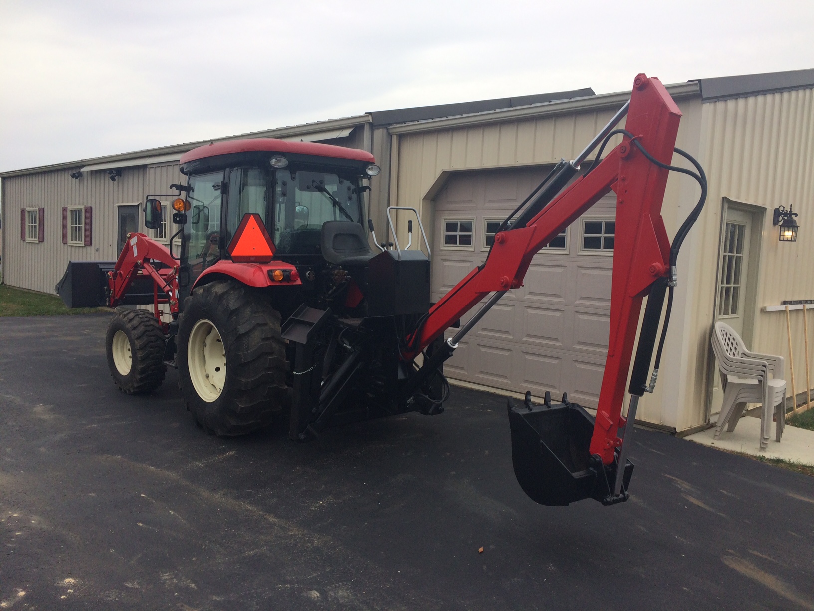

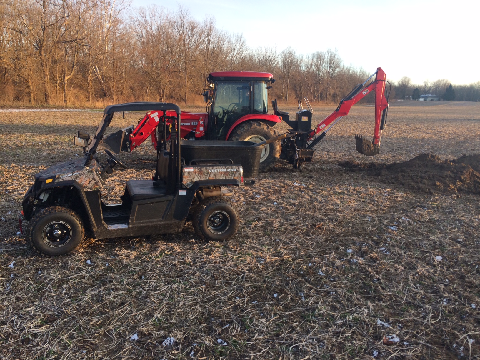

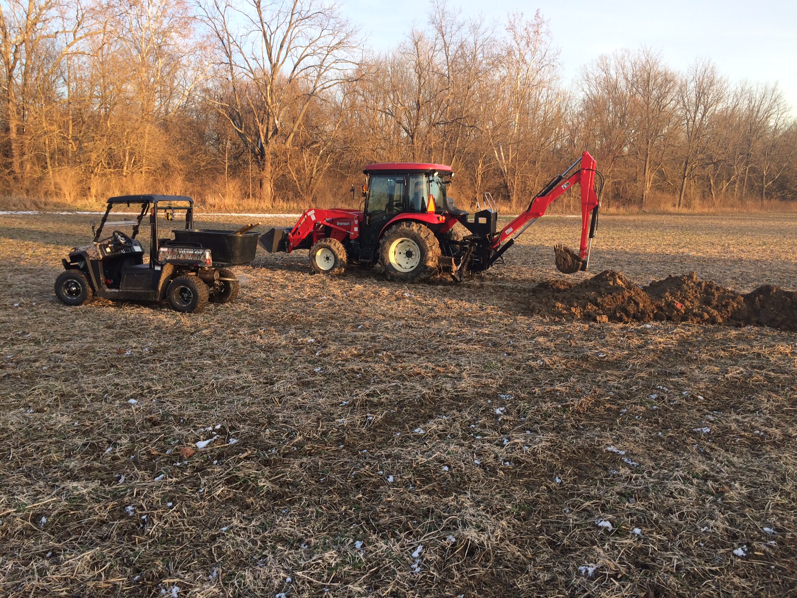

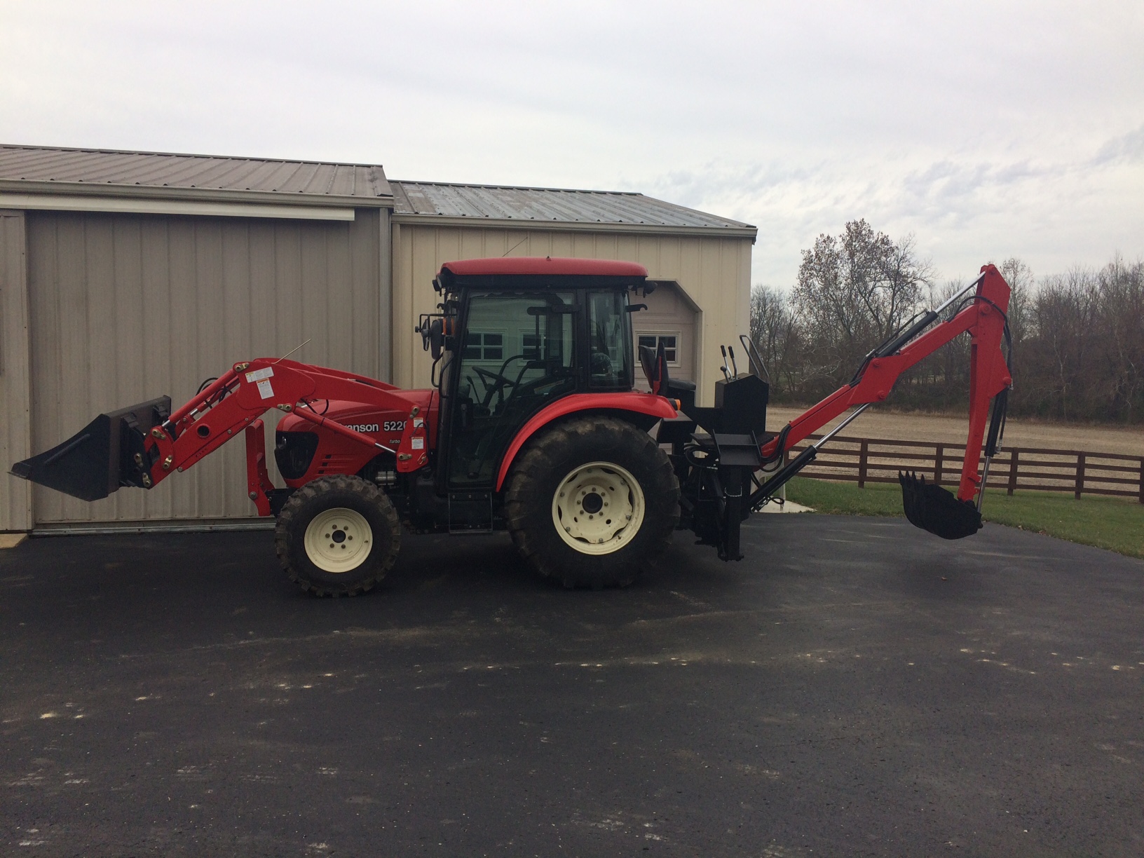

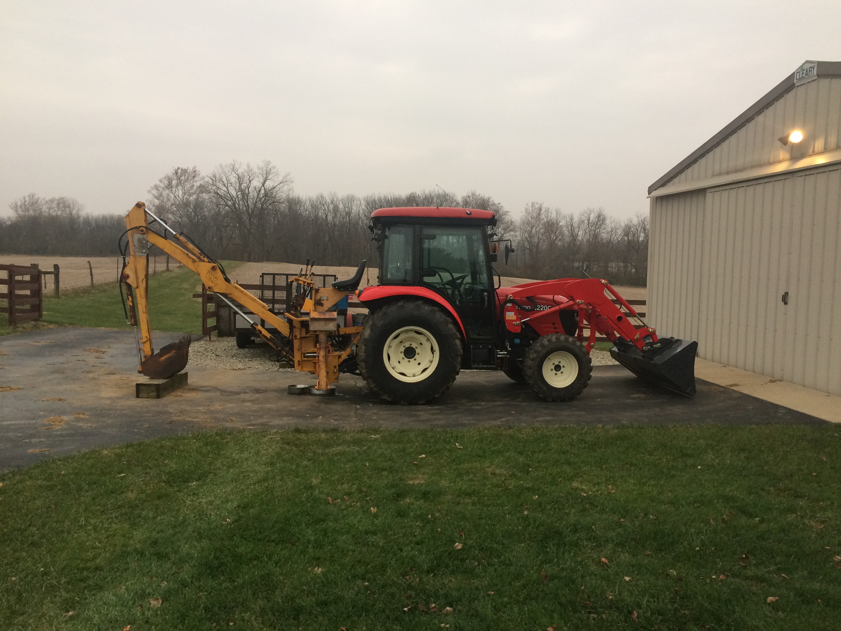

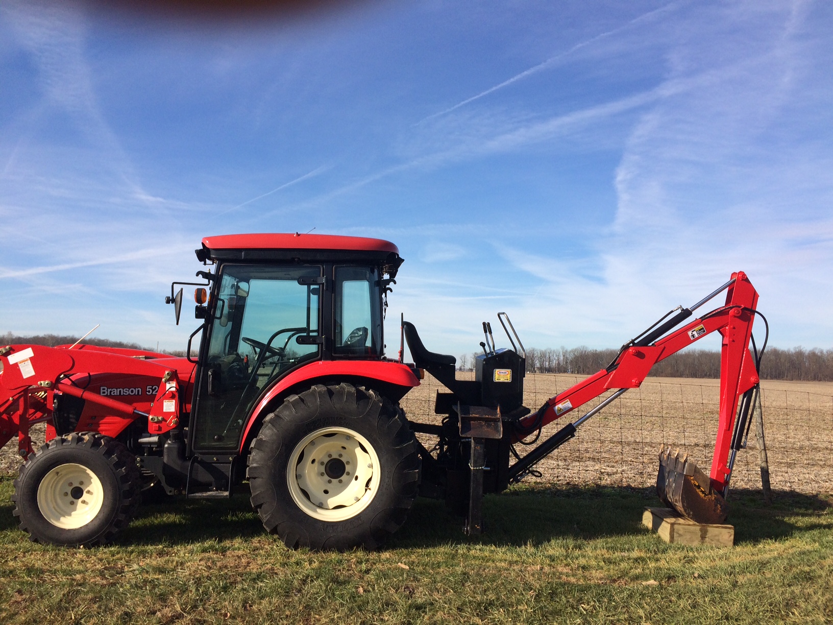

Added backhoe attachment to my 5220C
   / What have you done to your Branson today? #489
I would like to see some pictures of your project
   / What have you done to your Branson today? #490
image.jpegimage.jpegimage.jpegimage.jpegimage.jpegimage.jpegimage.jpegimage.jpegimage.jpegimage.jpegimage.jpegimage.jpeg
