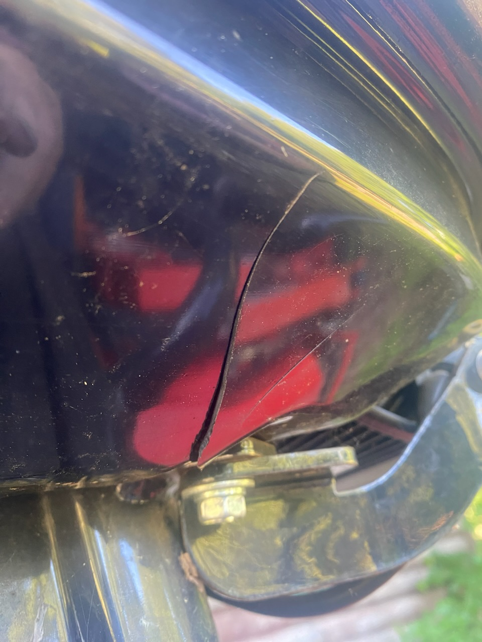

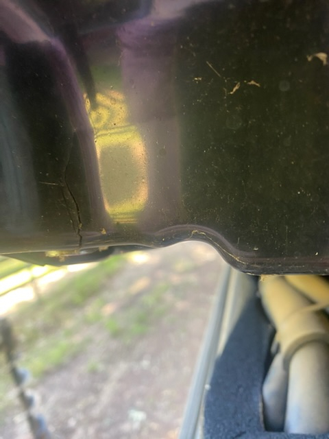

I just found my first issue with my 4815C. The roof assembly is cracking on the lower right hand corner at the front of the tractor. I don’t remember hitting anything and do not see any evidence that it was hit.
I am thinking about taking the roof off and trying to patch it from the inside but not sure if I could get to the crack or not. I am thinking about using epoxy and milled fiberglass to make the repairs. There is two cracks in the area that I will need to drill the ends to keep it from spreading.
Wonder what the likelihood of epoxy adhering to the plastic? Anyone have a better idea?
Edit: Scratch fixing it from the inside. The gap is only about 1/2 inch and at the top so no way to prepare it from in there. Also found another crack around the blind nut up front.
The roof was in a bind on this corner as if it had to be pulled over to get the bolt started. I also think this bolt was over torqued when the light bar was installed.
At this point I am going to price a new roof and go from there. I could attempt a patch from the outside but most likely will not hold.

Oh man that stinks. I would think you could repair from the outside? Maybe also take all 4 corner bolts off to relieve stress on roof? I think if you can get the stress out of it that the repair would hold.
Tractor Time with Tim recently did a series of videos doing a similar repair.
Can those lower sections be taken off separately? I haven't looked at mine that closely to tell.
I'm guessing you would not care for the "Replace Cab" option ($).

Well if that is the worst thing that happens to it not that bad of a deal. It is a one piece deal. The entire roof is what would need to be replaced.
The front corner bolts hold the light bar so they have to be installed. When I put it back on I got all the bolts started and just wiggled the roof a bit and it fell into place. Now I can push the crack almost all the way closed where before it would not move.
I think you are correct that I may not like the replacement cost but I will price it and go from there. If it is too high I probably will try an outside repair. Being it is around the blind nut it will be hard for the repair to hold I am afraid.
It looks like sheet mold compound or similar, you should be able to plastic weld it. You may call around to anyone who makes plastic tanks around you and they will have some expertise in this area. sounds like you should be able to reinstall without the stress of the misalignment?
Yes I can install it without the stress. I also am looking at a better way to mount the light bar so that weight is not on that bolt. I have thought about trying to plastic weld and likely will do that.
