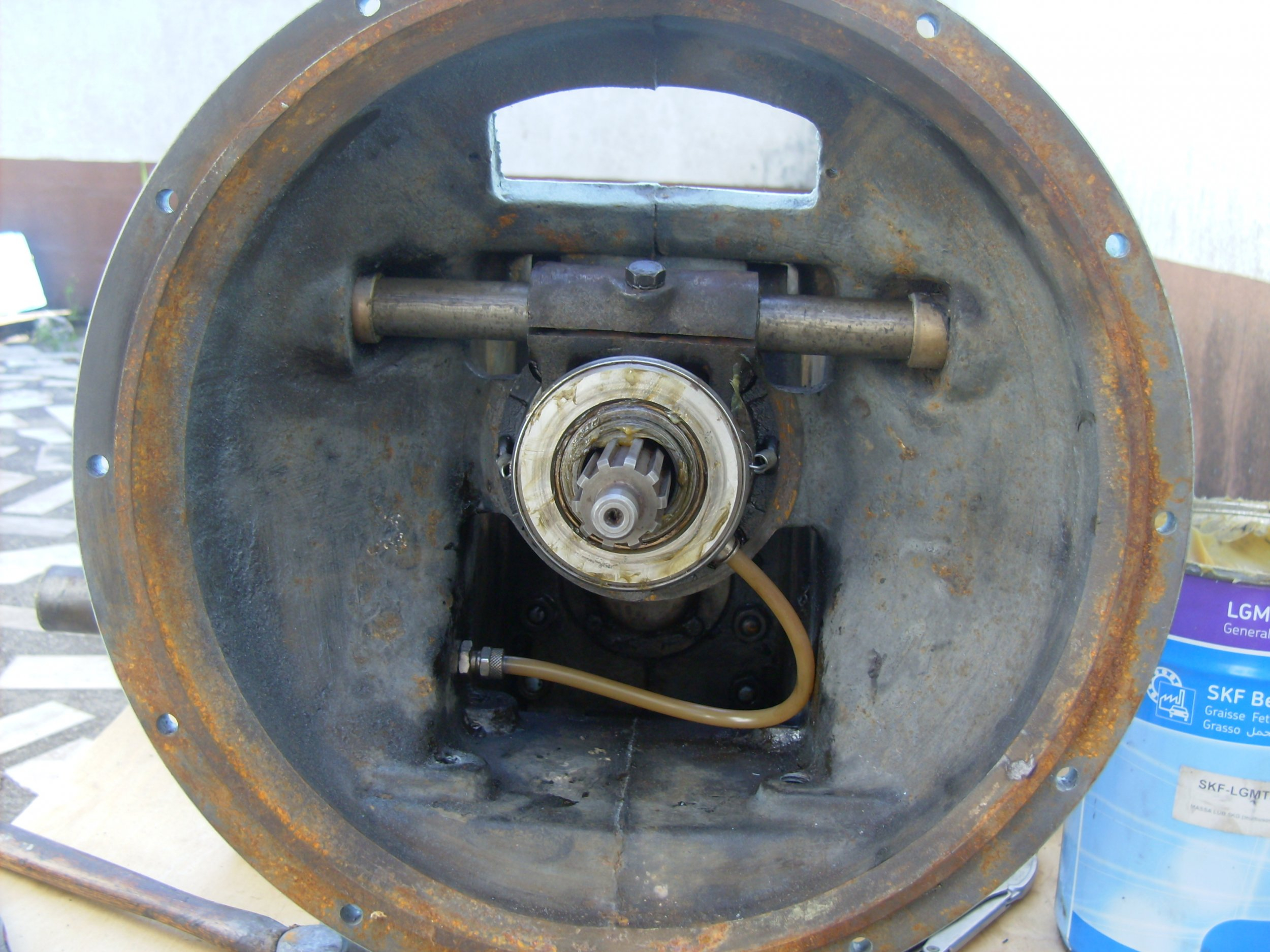

Many of the older tractors had a grease fiting an a hose that went to the throwout bearing holder;
The crawler I restored had that feature as well. Neat and simple feature that worked well and the bearings lasted a long time.
   / What have you done to your Branson today? #1,192
I knew that and that is what I was thinking these fittings were feeding. But ptsg makes a good point. I guess I need to take the bottom cover off one day and look at the throw out bearing.
While you're at it, spend a little bit of time pulling those splined couplers for the front axle out and apply some grease on the splines. Also, when reassembling, it's a bad idea to use a piece of wire to hold the roller pin in place. It has a tendency to walk its way out.
On mine, the coupler near the transmission wasn't bad, mostly because the transmission input shaft is right on top of it and there is this oil moisture that gathers under the shaft and then drops the drip right on top of the coupler. However, the coupler near the front axle was totally dry.

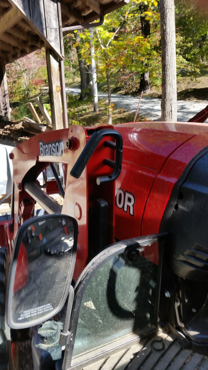

I did add a grab handle to my tractor to assist with mounting the tractor. I saw a bunch of variations used by others in the Branson FB Group. Several were not ergonomic IMO, a couple were very well done or chosen. One VG one is a Mahindra part that sells for ~ $17 plus SH and tax. I opted to use an Amazon sourced, Warehouse return thats an aftermarket Jeep Grab Handle. Use those terms and you'll see them. My buy I got two with bolts and spacers and they work great! I've included a picture. I used the included long spacers on the left side where I mostly mount, and the short spacers on the right side where the FEL lever is in the way of mounting. I drilled two holes and threaded them and used nuts on the back for increased sturdyness.
I'm currently desiring to find a grab handle for the right fender same as came on my left fender. There are two sets of factory holes plugged on the right fender but I've not found a handle that mates either set? One set if on the fender bend and ~ 6.5" hole centers, the other is up top and the best positioned and ~ 9.5" hole centers. I've searched Amazon and Ebay so far but not seen a perfect fit yet. Ideas are welcome.

Good stuff! I'd love to see photos of your milling operation and also the log cabin. Good luck on the build and have fun too.
I usually use the steering wheel as a grab bar but my arms are fairly long and I'm still more or less limber.
I like where you put the grab handle.

My short arms are nowhere near the st wheel when I mount, not to mention that my left knees had 14 steroid shots and the rt one got it first in sept.. My good leg is wearing down carrying the water for the bad one. Not quite to point of a full knee replacement yet.
The handle spot is spot on but I've still not decided on a rt fenders handle version to hold onto in dicey situations. I considered flipping the direction of the grab handle- which can still be done as the hole centers don't change.
