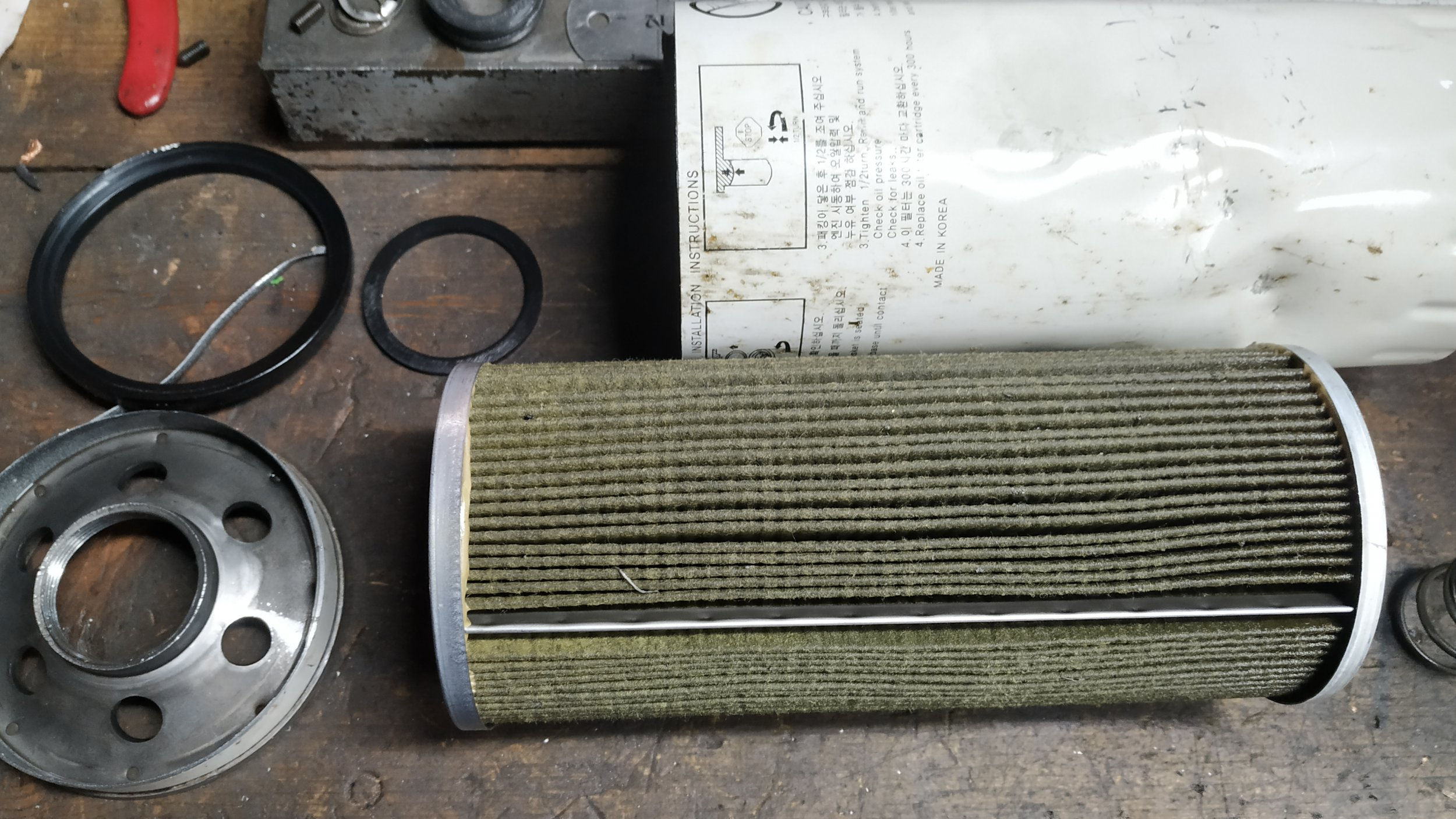

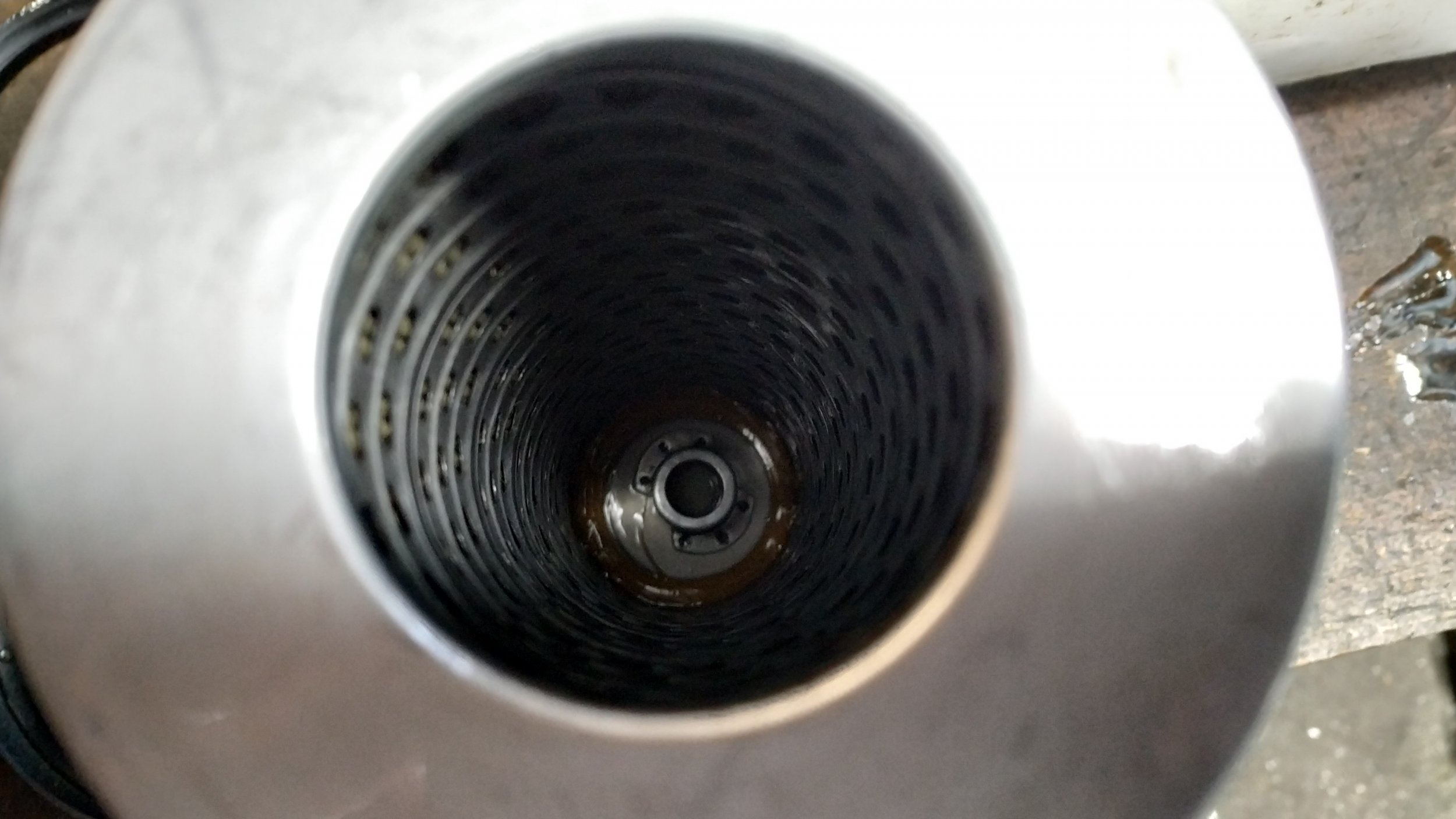

In case anyone wonders what's inside an OEM hydraulic filter. Not much going on really. I did noticed something on the bottom of the cartridge, can't quite tell what it is but doesn't look like a bypass. The Baldwin filter had the same thing on the bottom but wider and also had bigger diameter holes on the 6 hole pattern.
Comparing this one to other aftermarket filters I was looking for, all the other ones are about 1" shorter than the OEM one.
Oh like a lot of people have said before, this thing was a bear to come out. You can see the dents of filter wrench I made on it.
I was very pleased to find that the magnetic drain plugs had little to no trash on it. The filter also was super clean with only the common tiny particles of metal and a little bit of RTV here and there. Nothing to worry about. Keep it mind, this filter is still the one that came originally with the tractor and it has 370 hours on it.
View attachment 760259 View attachment 760260
Likely a check valve to prevent drain back in the system.
Glad to see it's staying clean. That's good to hear.
