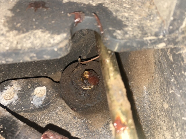

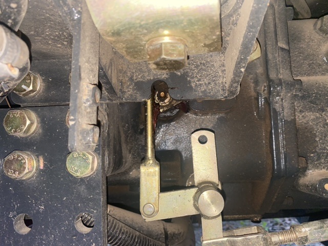

So I was greasing my 4815C a few weeks ago and found two new to me fittings. One on each side of the bell housing. They are not listed in the manuals and are tough to access. Not knowing what they were greasing, I decided to put about 4 pumps in each one. I did not run the tractor any until yesterday.

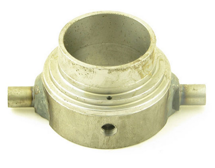

Since new, the throw out bearing has always made some noise when I would clutch the tractor. Well yesterday it was quiet all day. I wondered when I put grease in these new fittings if it was for the throw out bearing and I now believe they are. I don’t think they have ever had grease. They certainly are in the correct location to feed the throw out bearing.
If they do not feed the throw out bearing then I have no idea why the clutch was quiet yesterday. Lol
   / What have you done to your Branson today? #1,185
The geared models have those and no, those are not listed anywhere for some reason. It's for the clutch fork pivot shaft and doesn't take much grease at all. I don't think grease has anyway of reaching the throw out bearing though.
Also, they used straight fittings with is a complete bear to get the tip of the grease gun there. A 45 or 90 degree fitting would work much better. I really need to change mine.

That is good to know. I guess my hearing has gotten worse then because I could not get the throw out bearing noise yesterday. I purposely was listening for it and clutch multiple times trying to hear it. Oh well.
   / What have you done to your Branson today? #1,187
Wondering if it was just a little rattle coming for the dry shaft? Hard to say.

Many of the older tractors had a grease fiting an a hose that went to the throwout bearing holder;
   / What have you done to your Branson today? #1,189
   / What have you done to your Branson today? #1,190
I knew that and that is what I was thinking these fittings were feeding. But ptsg makes a good point. I guess I need to take the bottom cover off one day and look at the throw out bearing.
