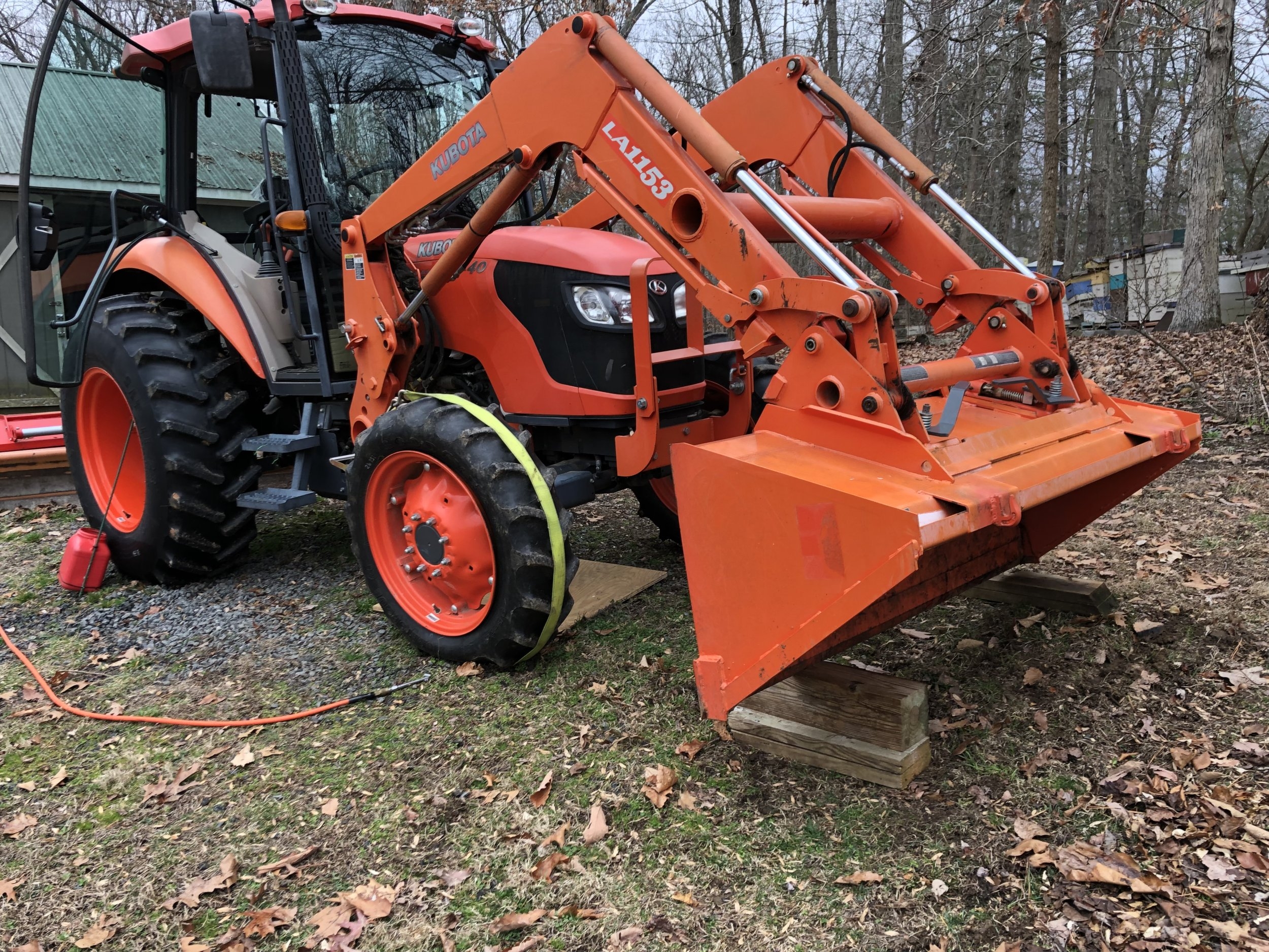

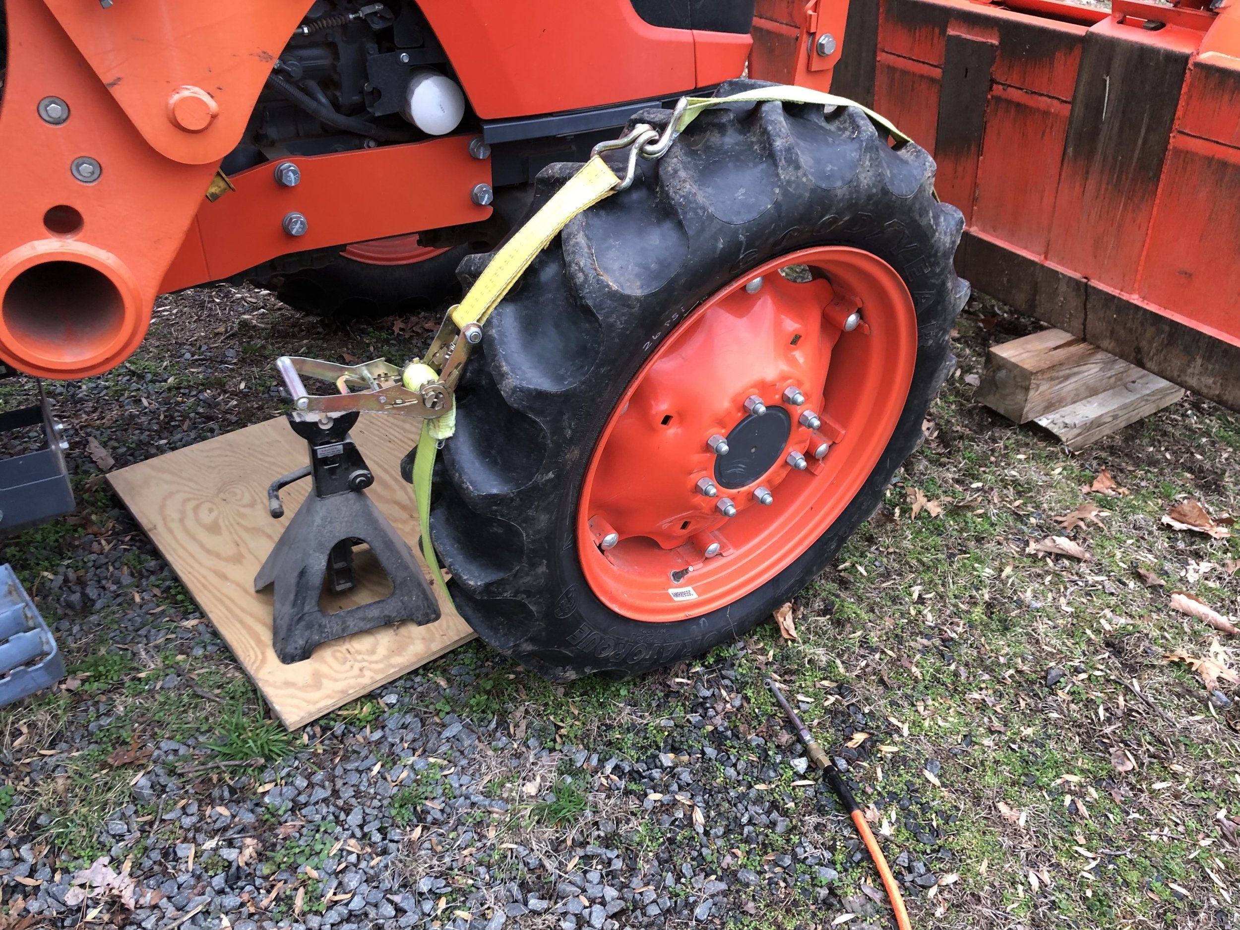

Thanks to All. Good advice. This morning I tried the lift up with the FEL and squeeze the tire with a ratchet strap method. Success! I was parked next to the barn and had a 300 psi compressor to use, which definitely was convenient. Had to apply a tiny bit of silicone gel to one spot on outside rim to help the bead slide over, but the ratchet strap did the trick! Thanks again.

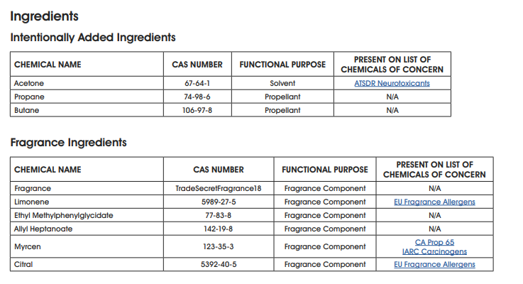

Nice thing about using starter fluid to reseat a bead is it also inflates the tire a bit as well so you don't need much air to get it up to pressure either.
I don't recommend it for the faint hearted however. In fact I don't recommend it at all but it does work if you are so inclined.
