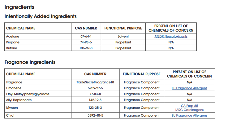

yes... you don't want want to light up a match while spraying this stuff... I mean unless you do intend to light the place up... check the ingredient lol
Wow! Looks like a lawsuit waiting to happen.
Some grandma spraying nice scent for a luncheon with candles lit on the table and —- whoosh!

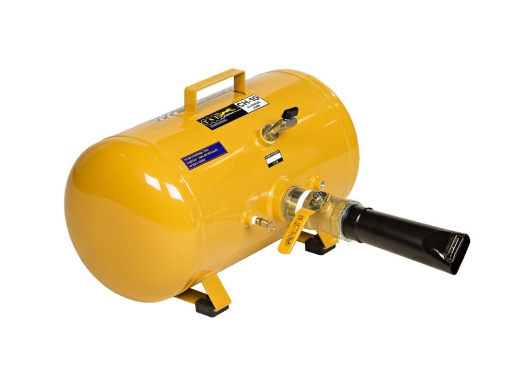

You should be able to pry one side off the Wheel. Feel all around inside of the tire for anything that could cause a leak. Lube both beads and wheel with liquid dish soap, remove valve core and try to inflate it using a Ratchet strap or chain with a bar to twist is. Fill Air compressor to max and lock it on valve. If first attempt fails, take it to a Shop.
