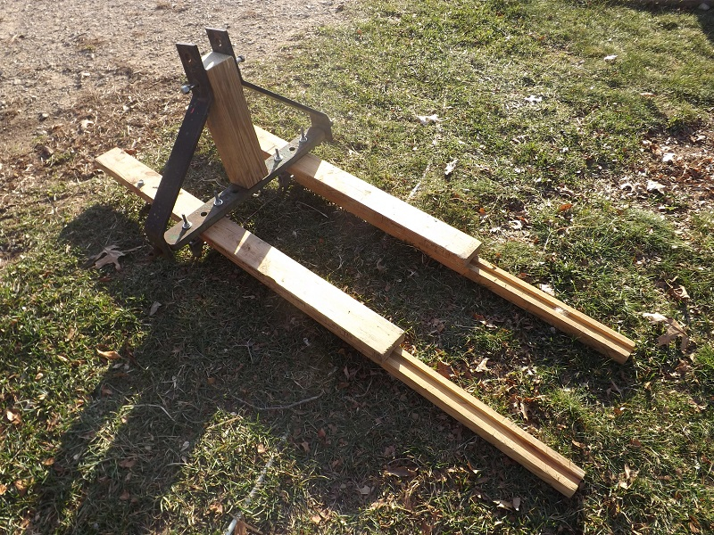

Poor mans forks that get by.
Using my box blade mount straps to the 3PT and a drawbar.

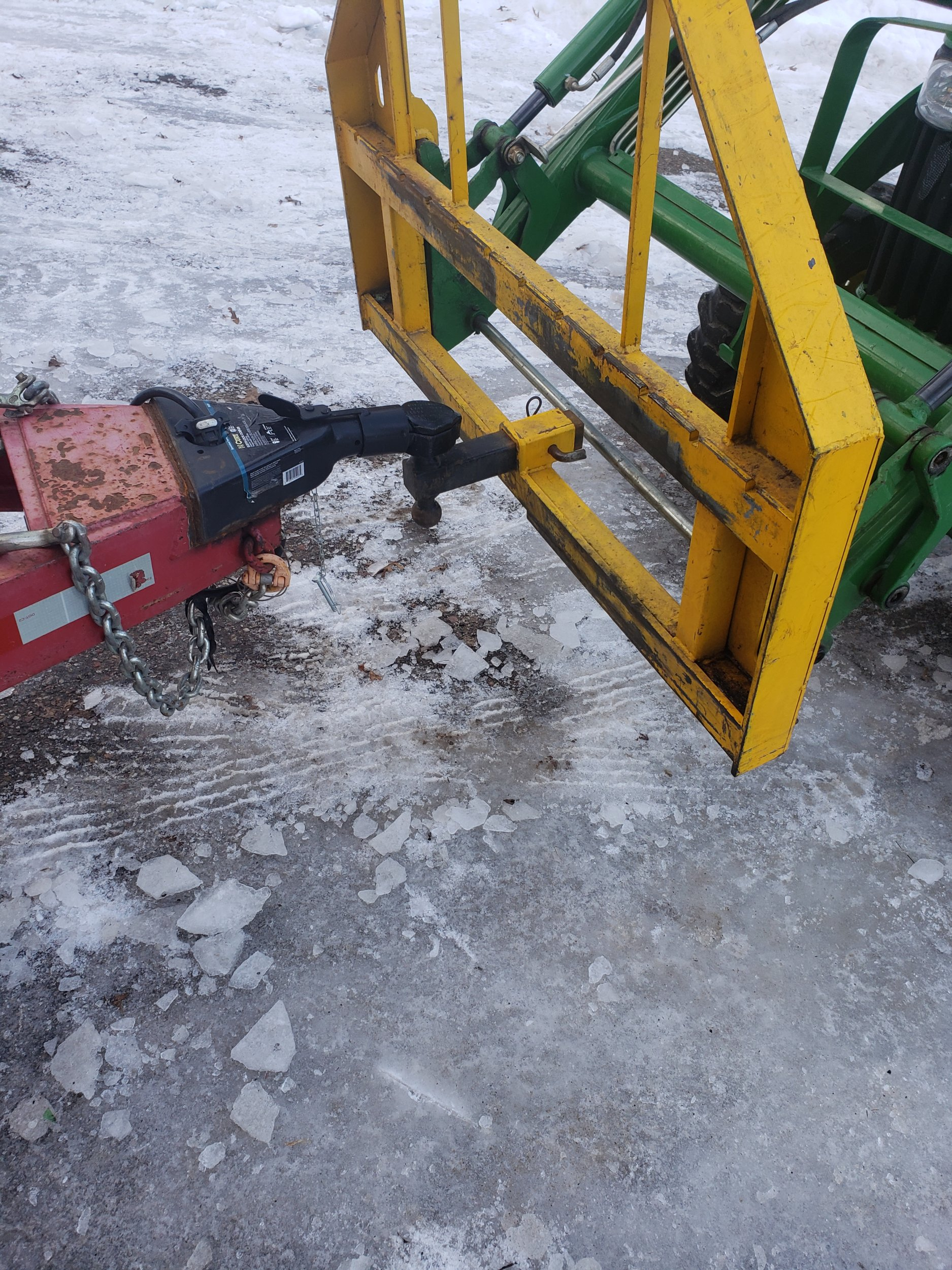

Not really forks but I added a receiver tube to my mask and now I can move trailers with the front.

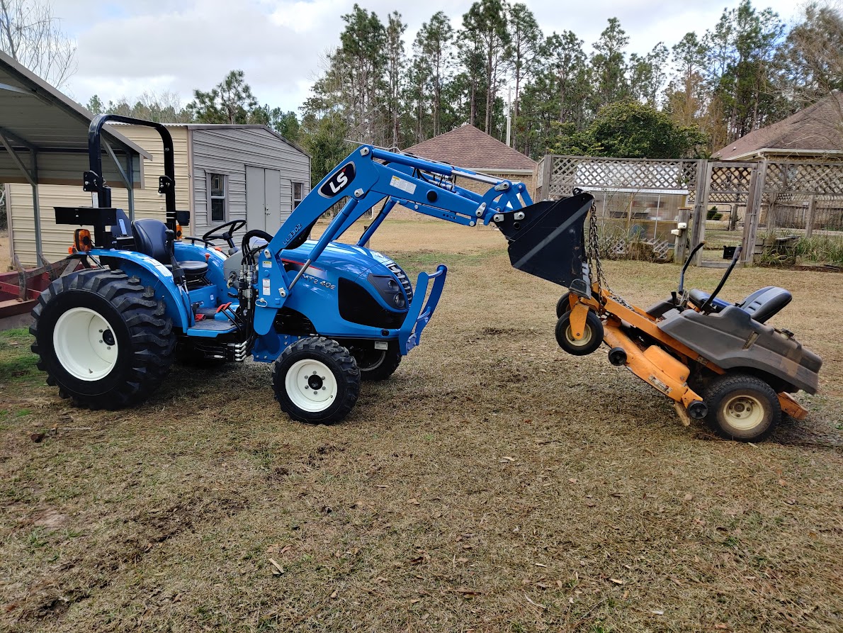

Lift mowers for access to get the sticks branches out of the blades.

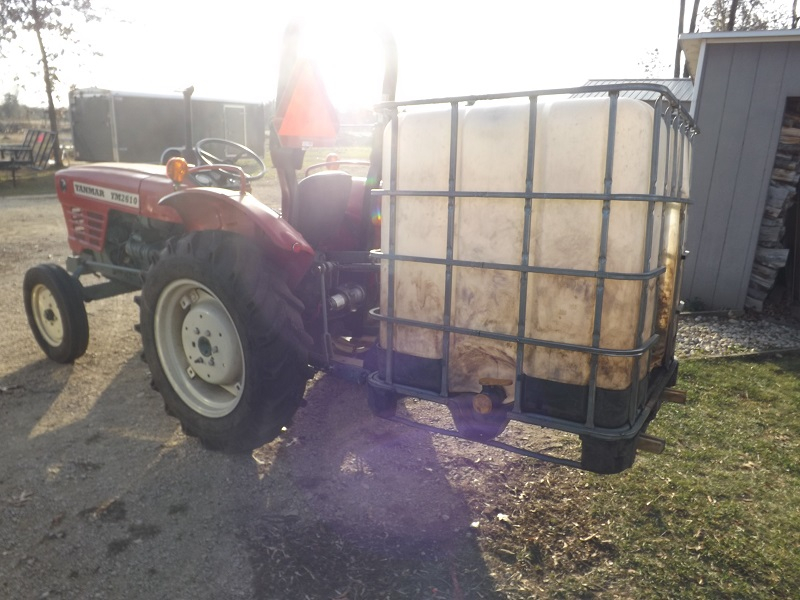

remove the tank from an IBC tote, cut an access hole in the cage, chain it to the fork frame, chain across the access hole, and you have a nice little work platform.
