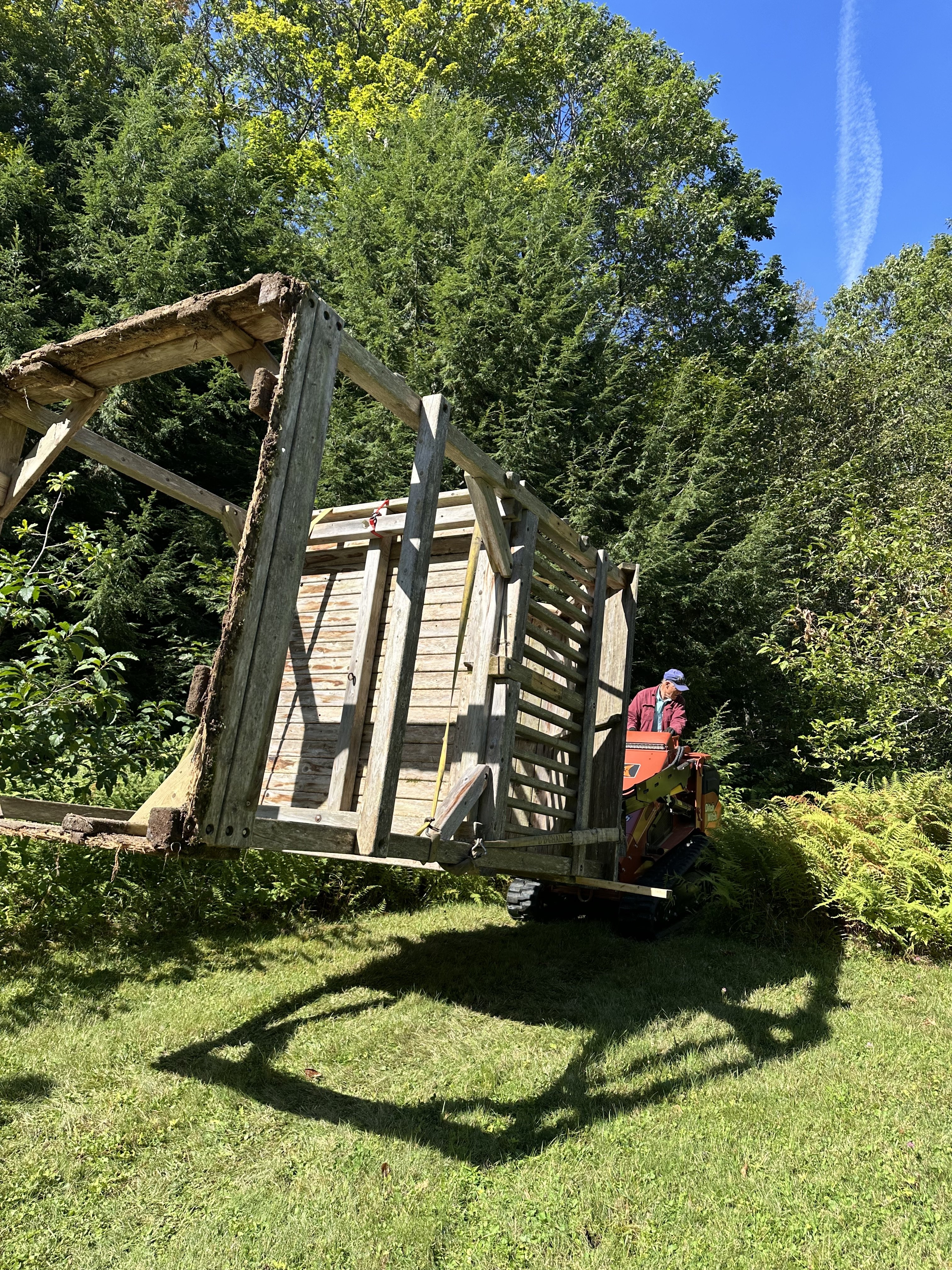

Moving a play structure for the grandkids !
What a great idea. Kids have a new adventure and a cool grandfather.

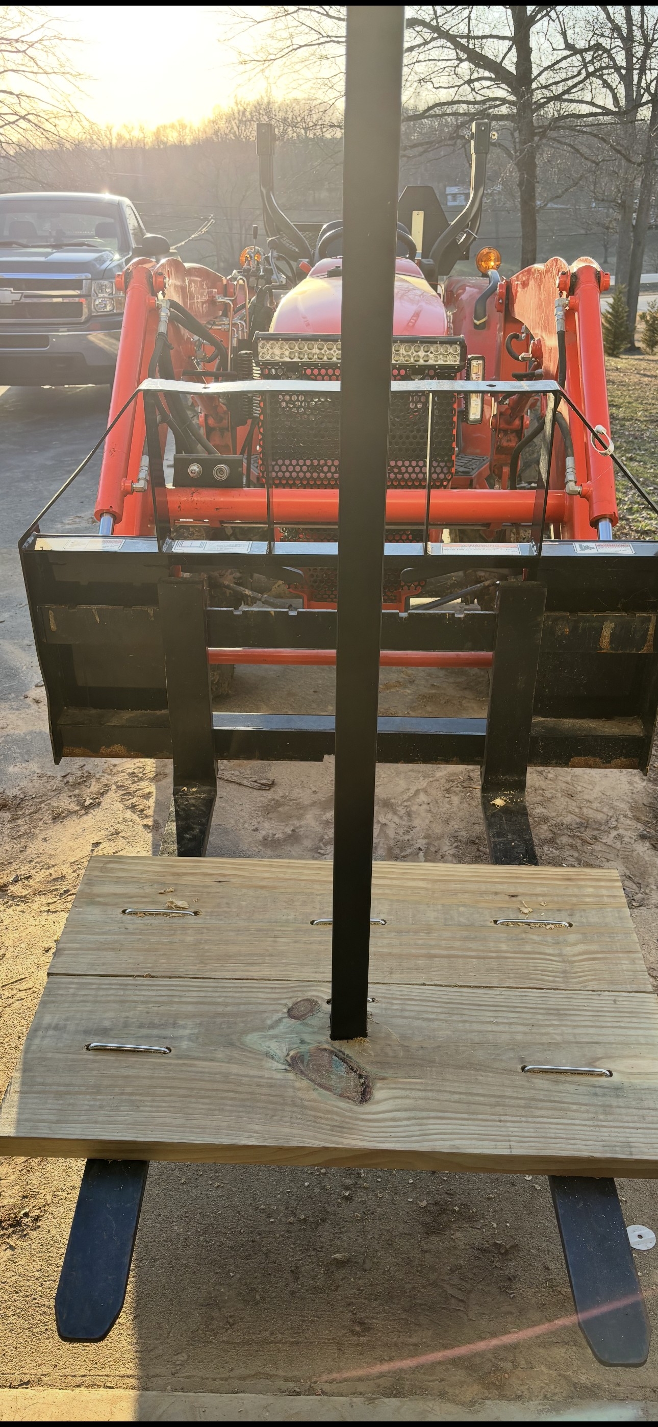

I used an extenda-bed hitch that I bolted to 2x12 that I then bolted to the forks. I used this to slip inside the hole of fence rolls to pick them up, and then the heavy fence roll sat on the wood and spun around the pole while I stretched the fence in place. I used ratchet straps and a metal bar to stretch the fence. Everything worked really well for costing nothing since I already had everything.
