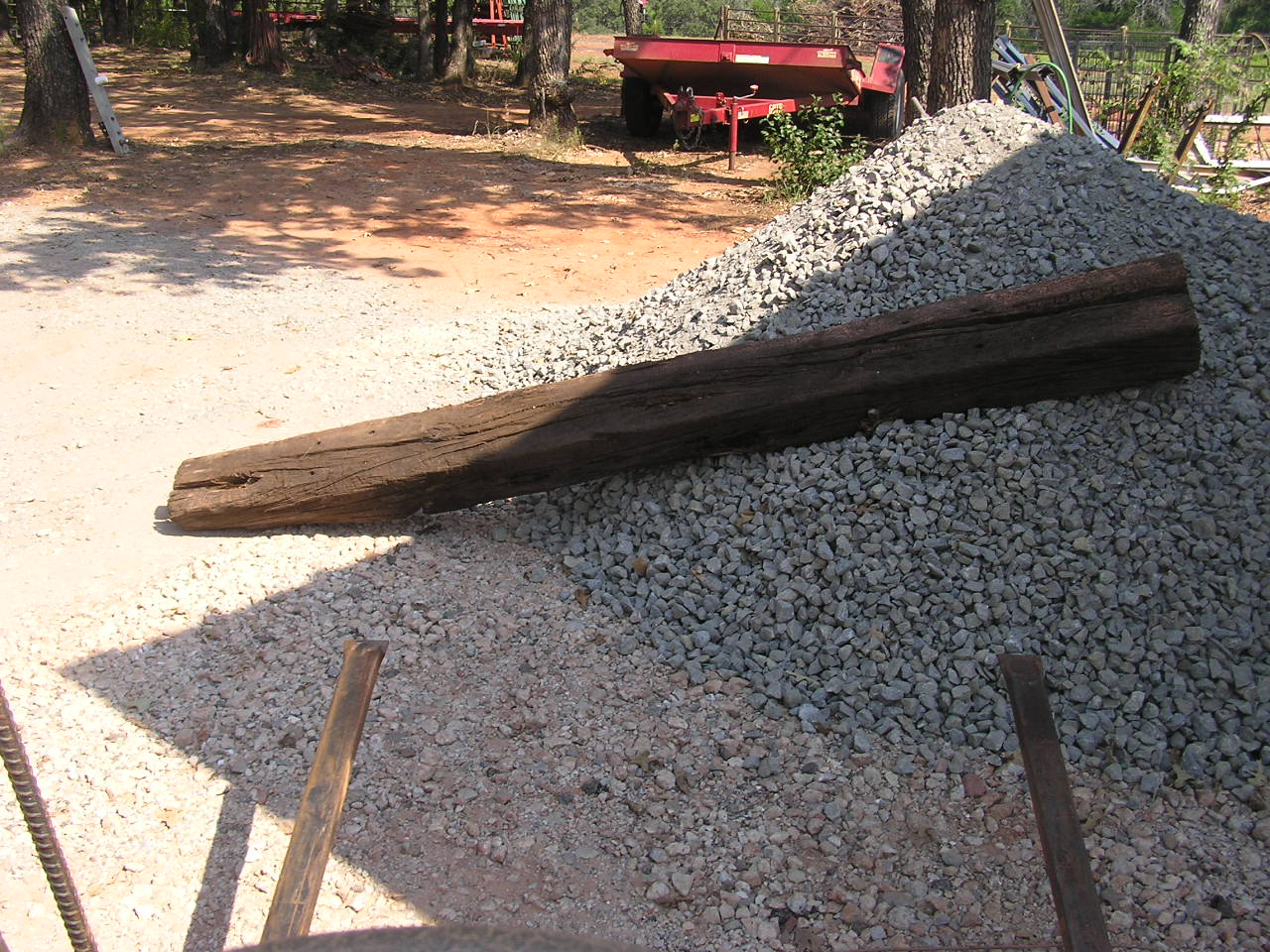

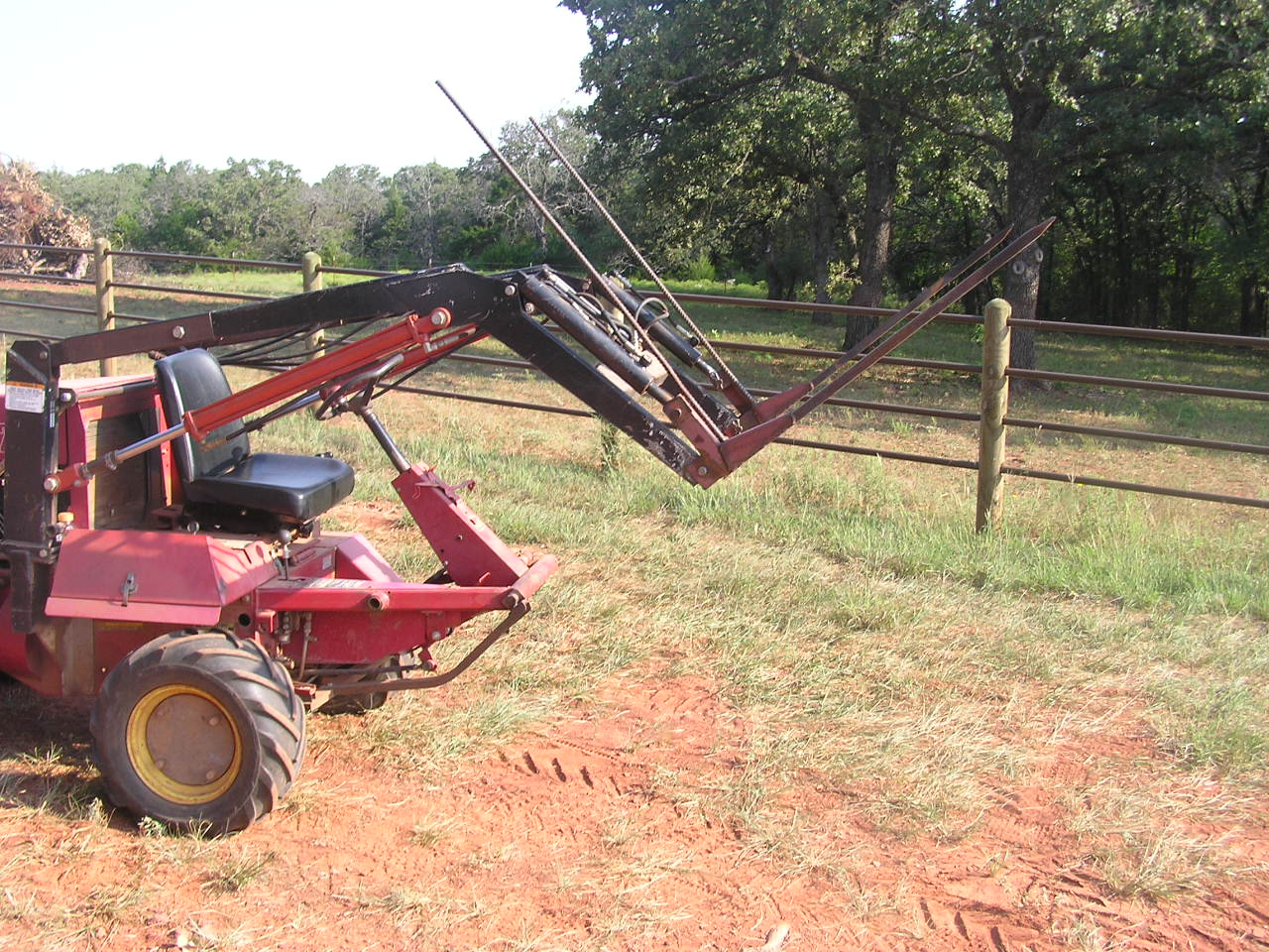

I made a set of independent forks for getting under things that are not flat on the ground:
View attachment 722491View attachment 722492
Picking up a RR tie that is at an angle to the ground:

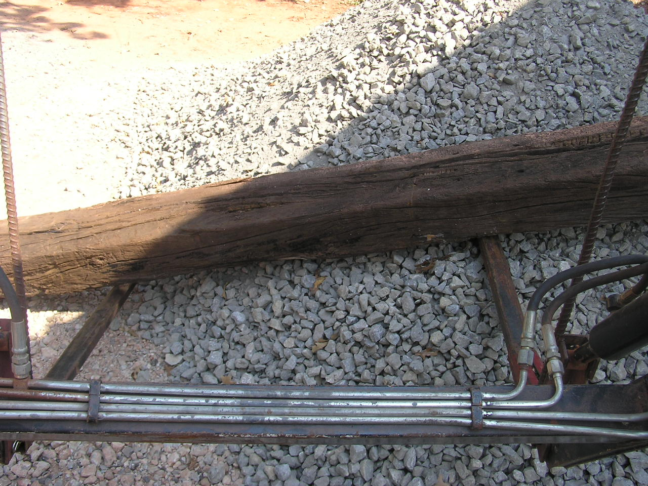

Setting the angle of the forks by curling down:

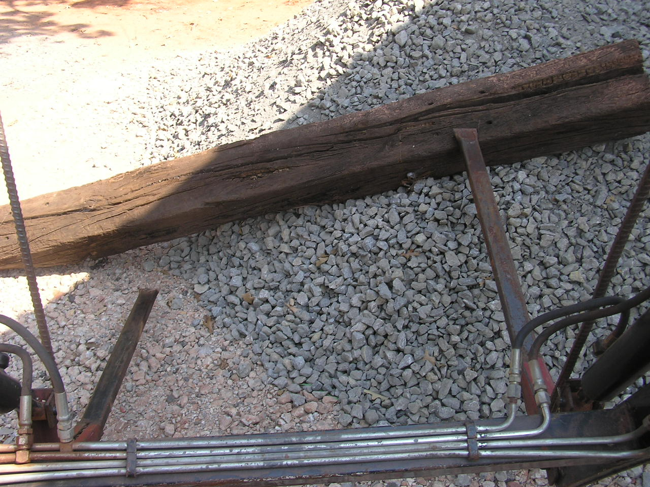

Backed up and got under the tie:

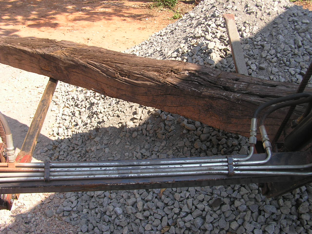

Picked it up:
Curled up and raised for transport:

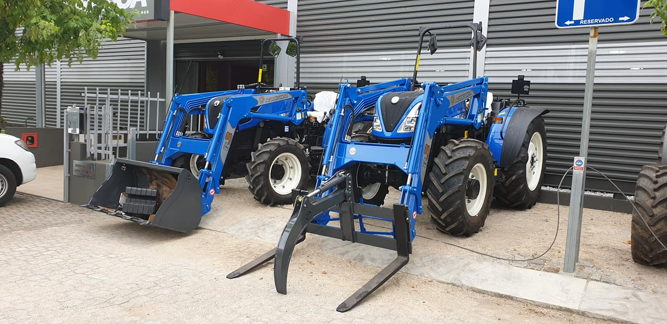

Is the thumb/grapple arm a separate attachment or are they sold like that? I have seen some sold here with two arms, never one. Does it get in the way of loading pallets, or can it lift up out of the way?
what kind of tractors are those? I could not read the names.
