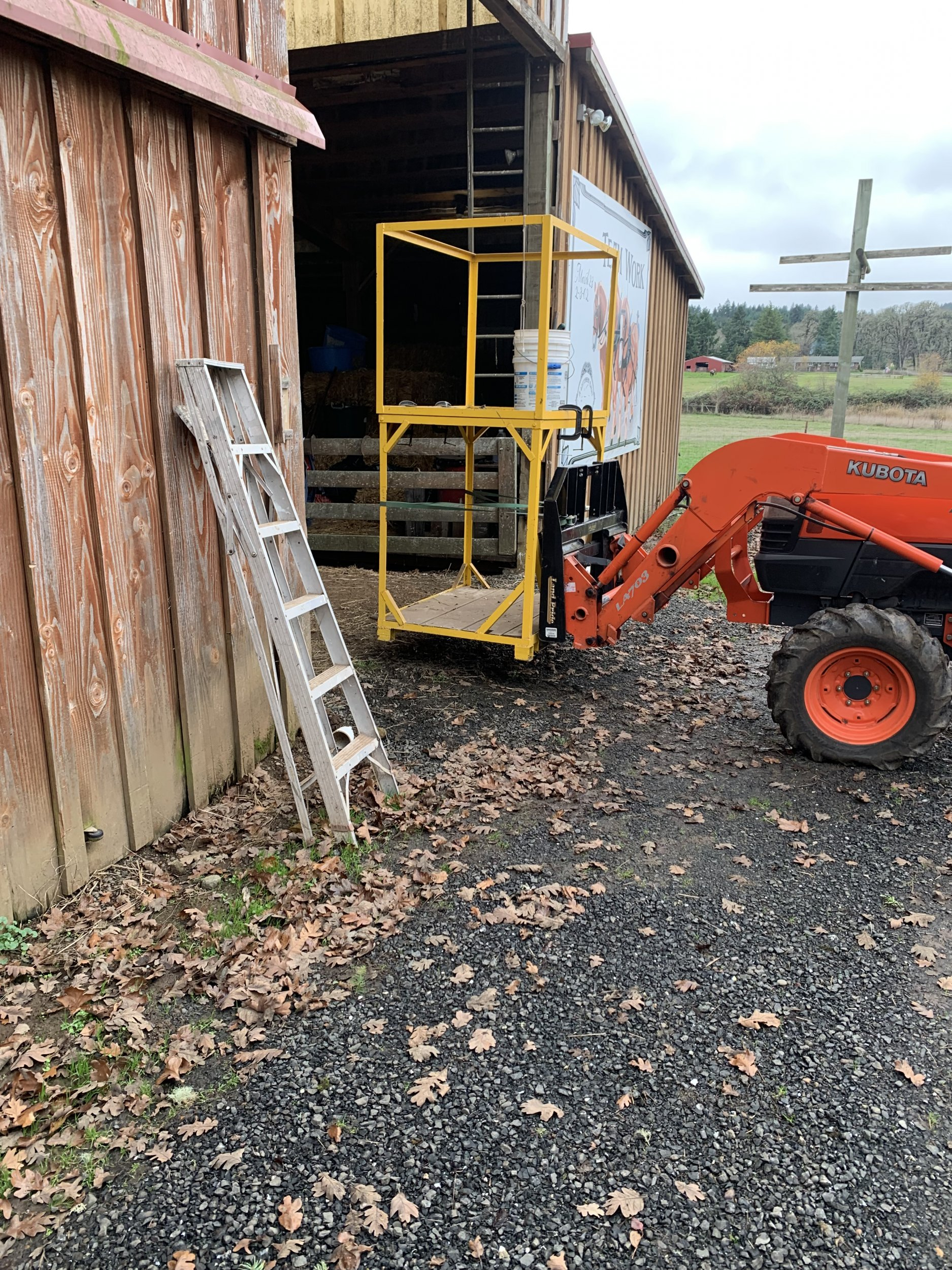

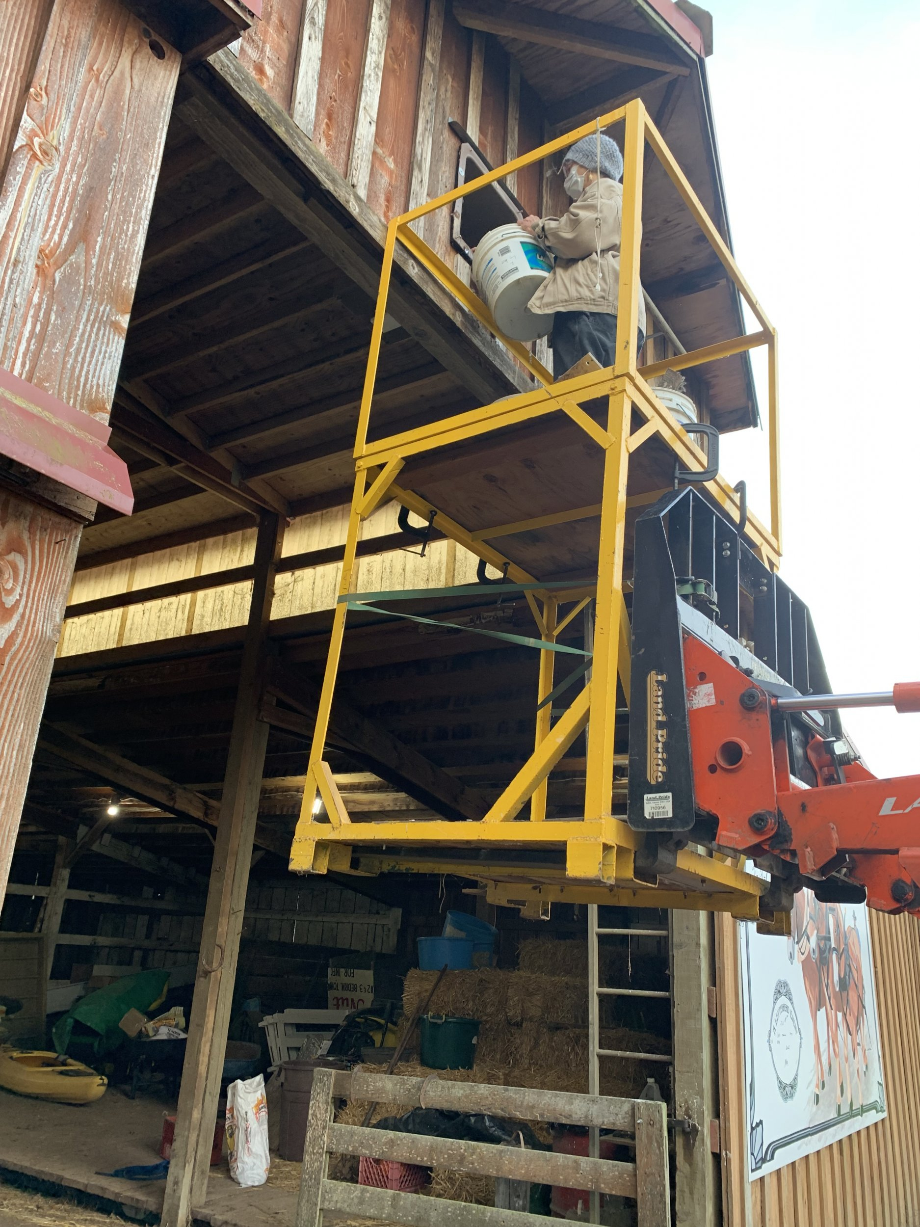

My double decker for reaching higher, yeah I know the tire needs some air. Cleaning out the barn owl box for the upcoming year.

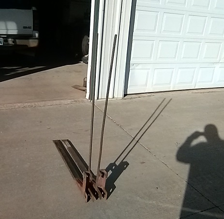

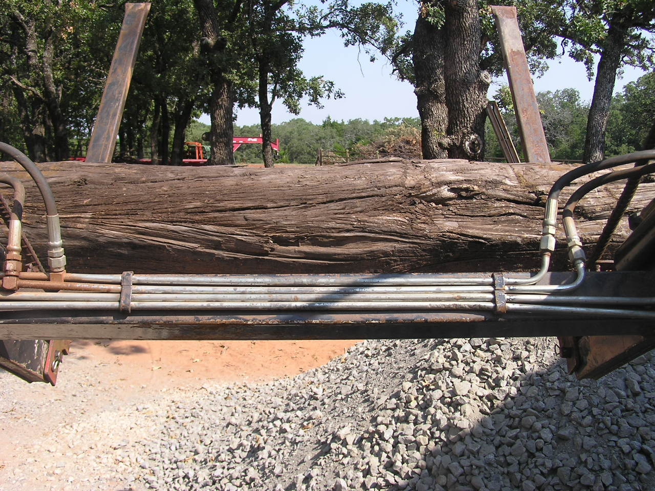

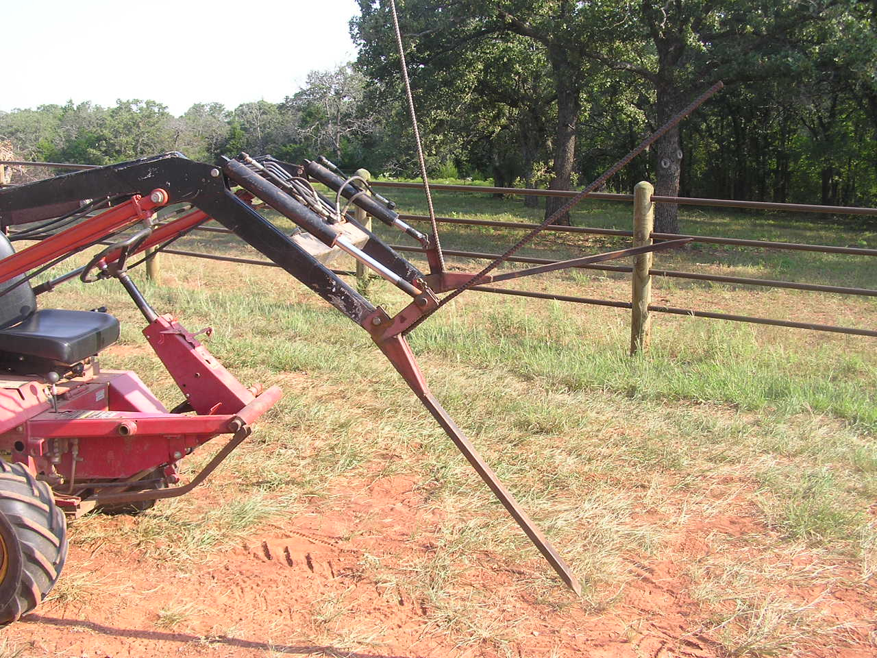

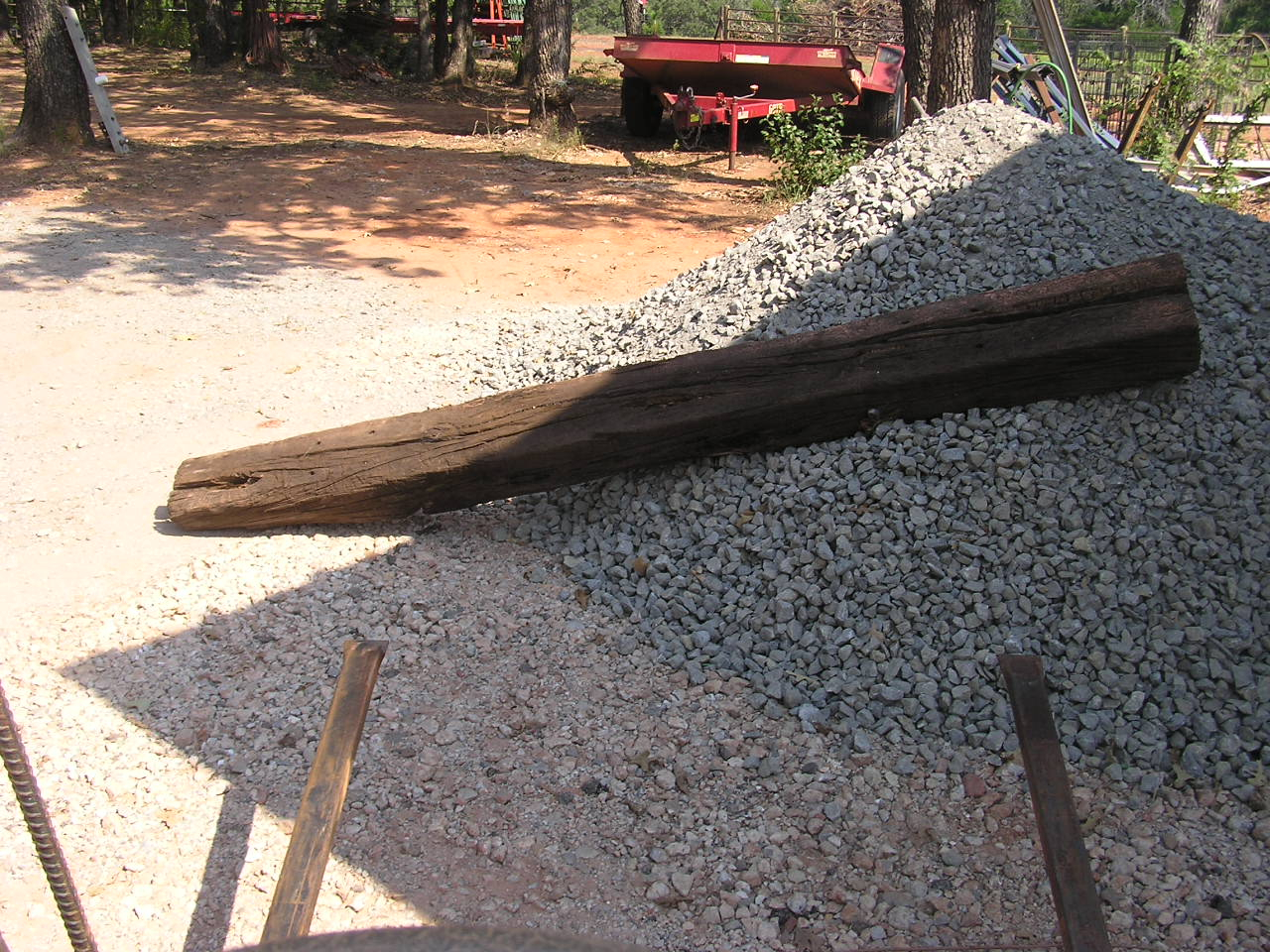

I made a set of independent forks for getting under things that are not flat on the ground:

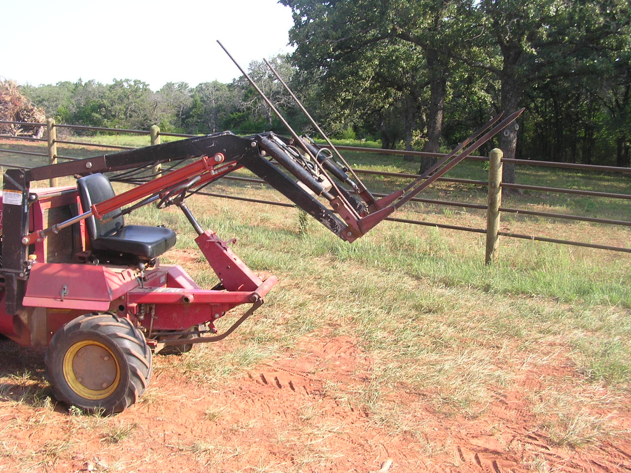

Picking up a RR tie that is at an angle to the ground:

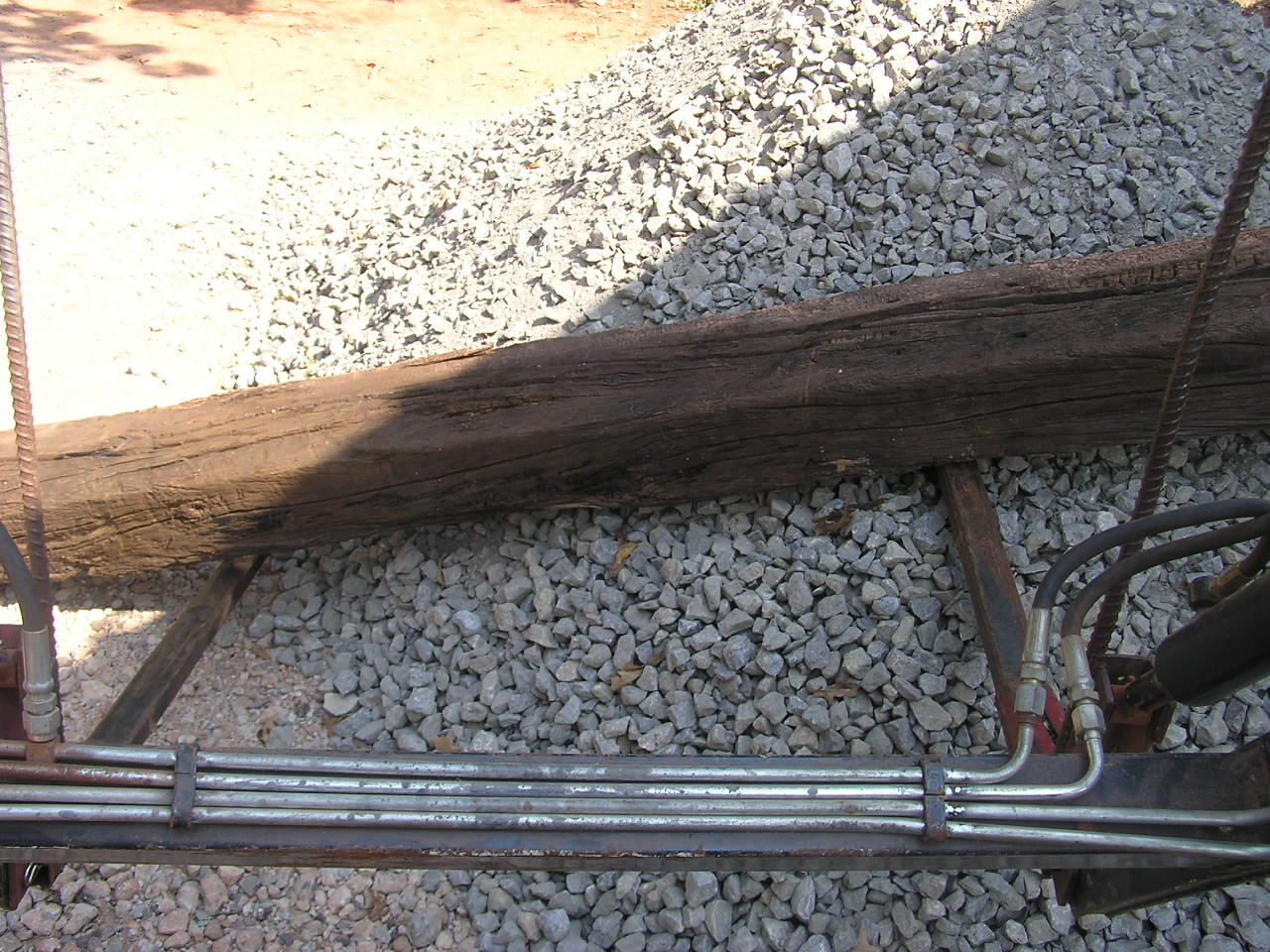

Setting the angle of the forks by curling down:

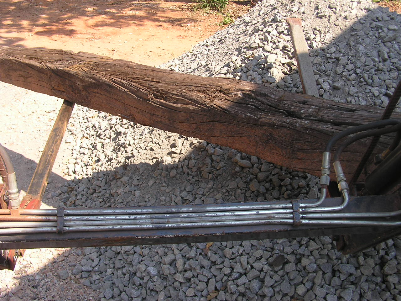

Backed up and got under the tie:

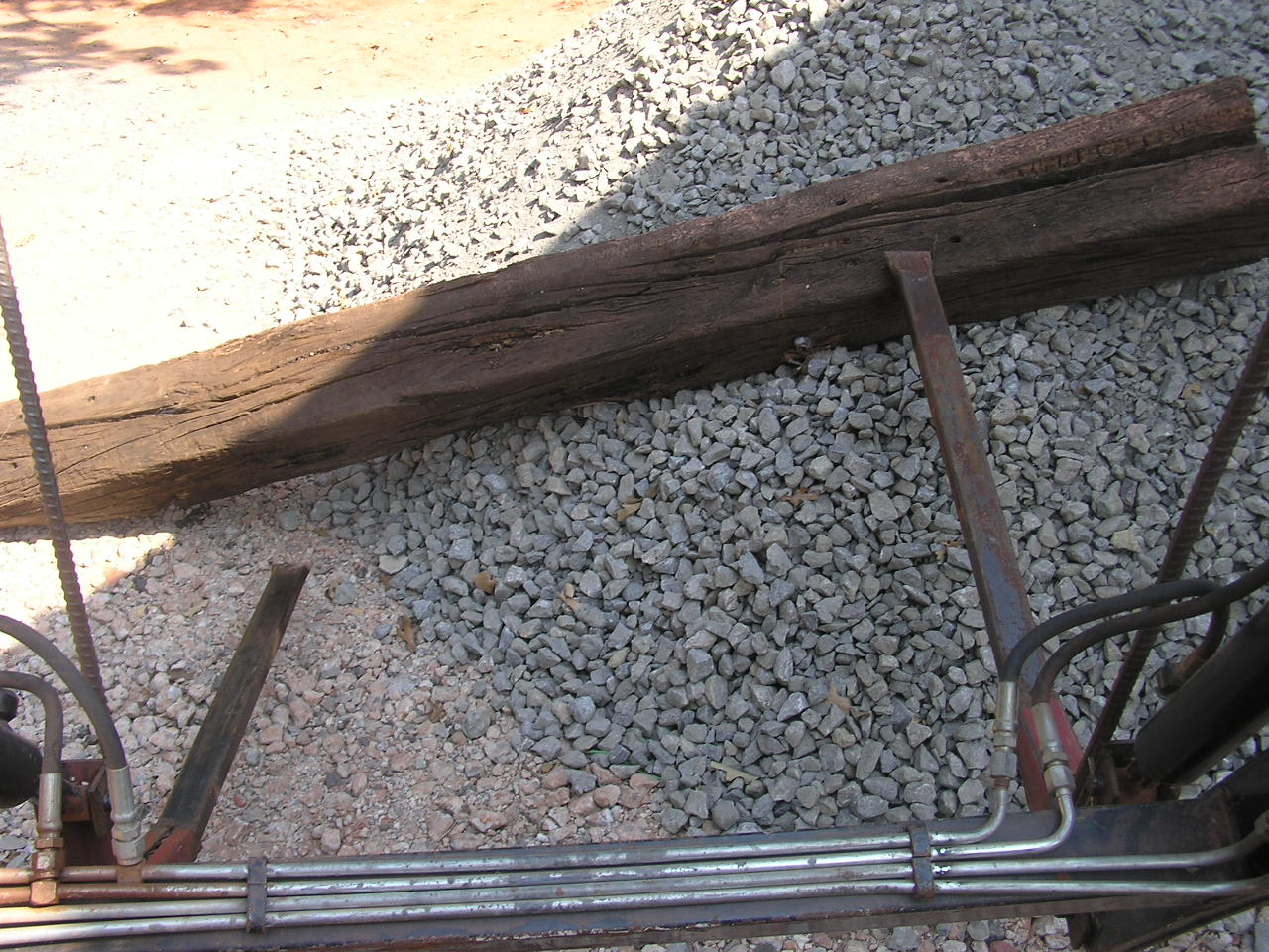

Picked it up:
Curled up and raised for transport:

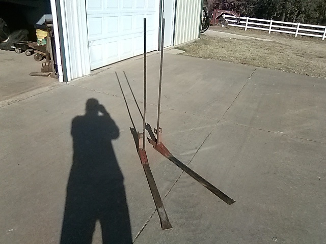

Mr. Xfaxman, those forks will show back up on TBN 40 years from now!
Probably a lot sooner than 40 years :)
"...Just found these at an auction...anybody know what they are?..."
Yep, if they are not with the other TORO+Loader stuff it would be hard to tell what they are:
