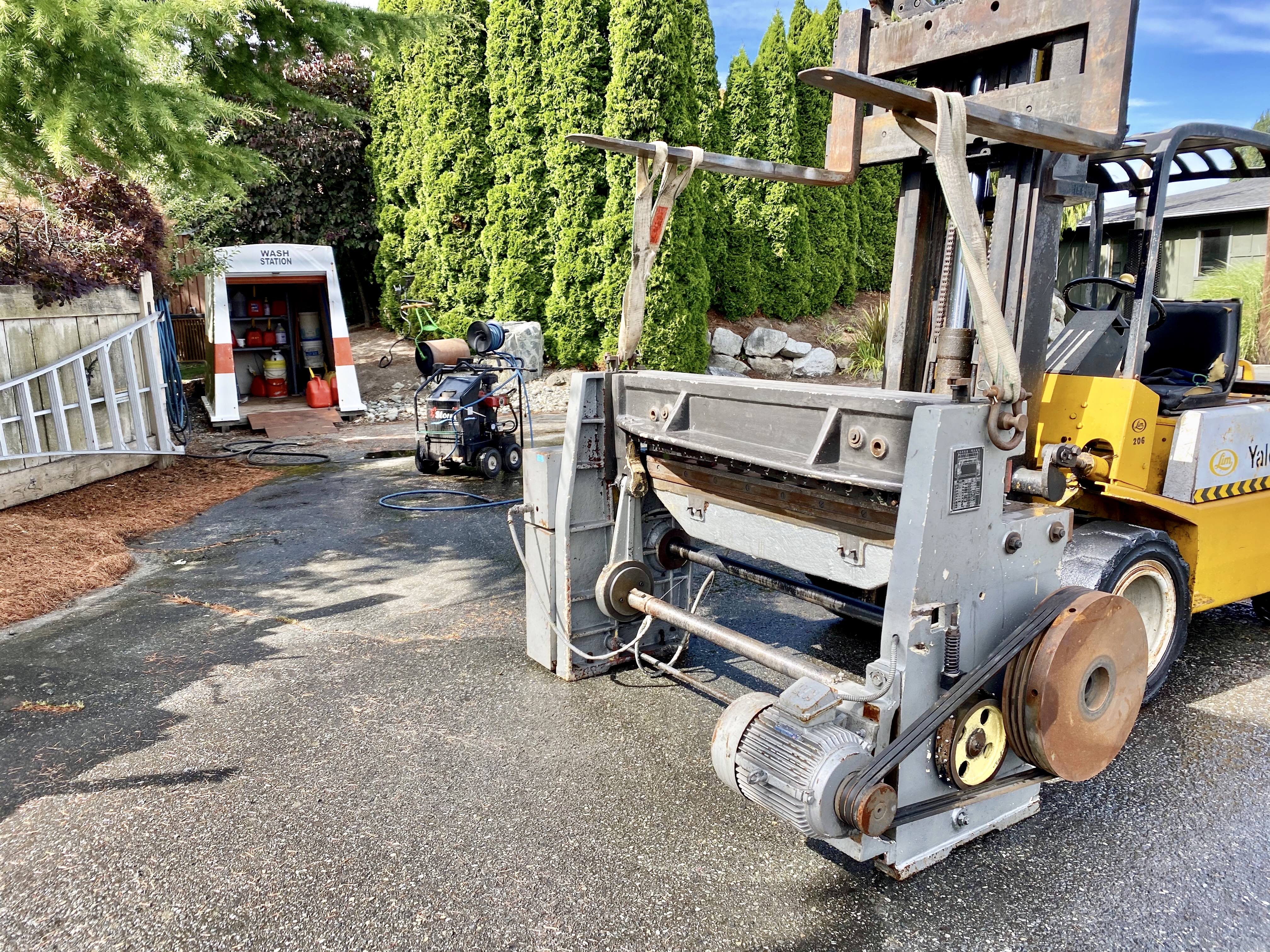

Here is another lift sling application I used with forks the other day.
Two slings lifting a 5500 pound shear with forks

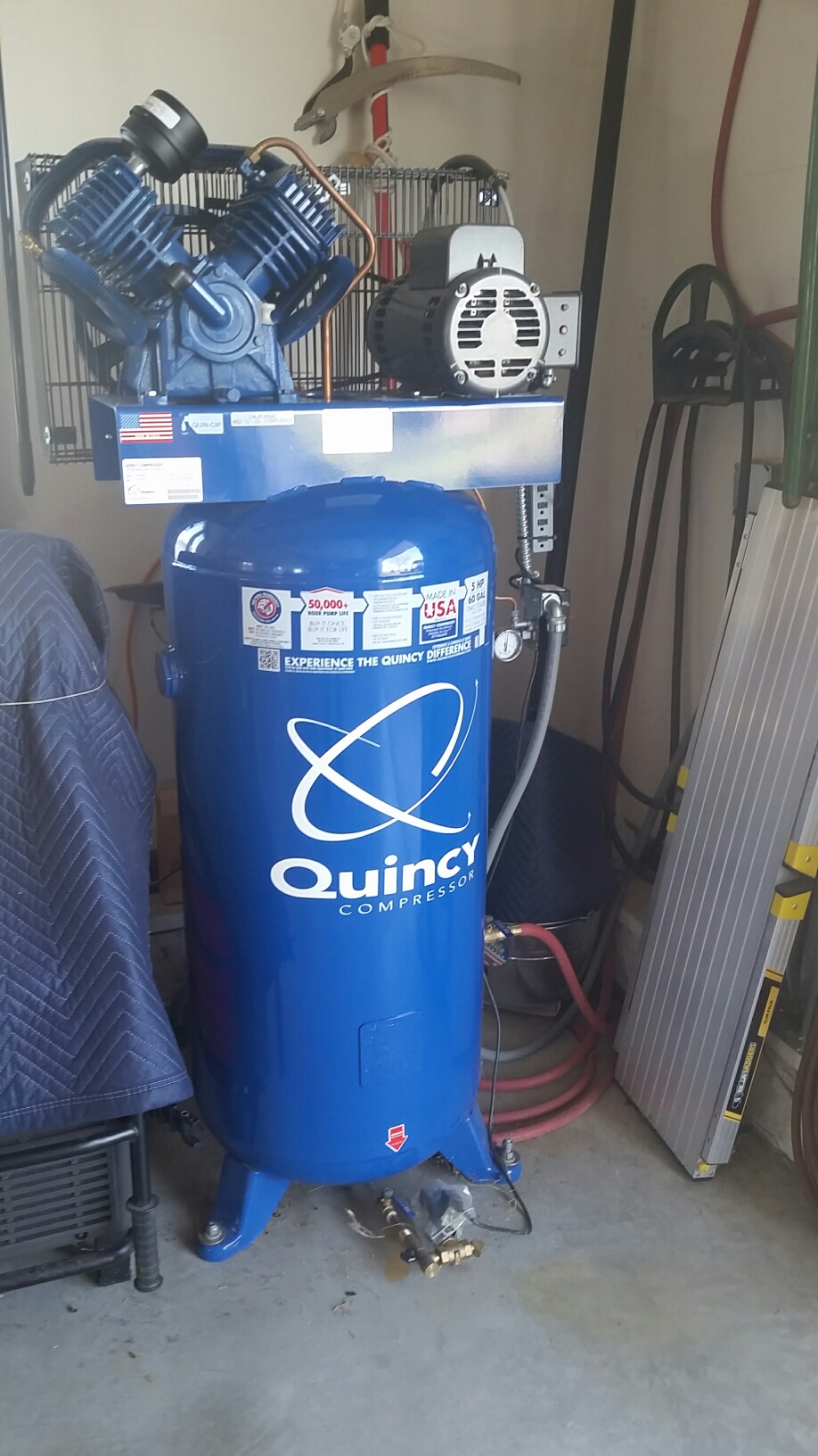

I used mine to raise my 60 gallon air compressor off the pallet and into place so it could be bolted down to the floor.

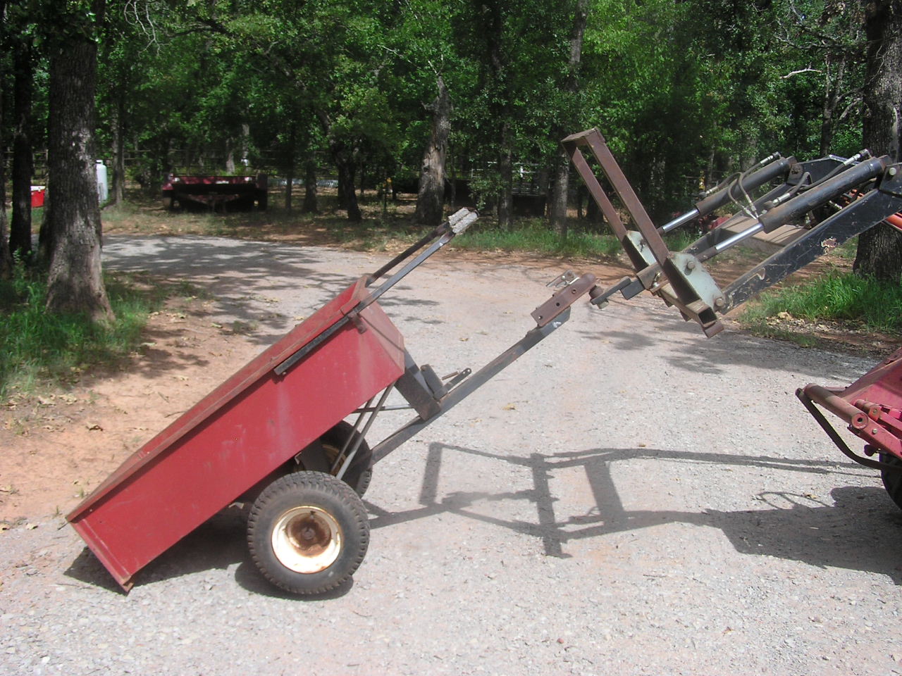

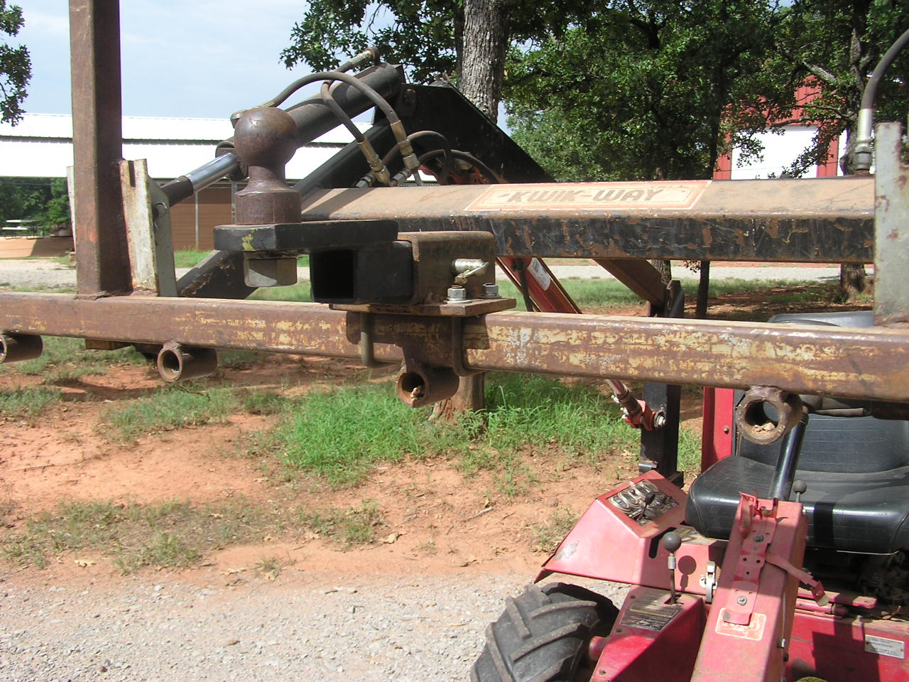

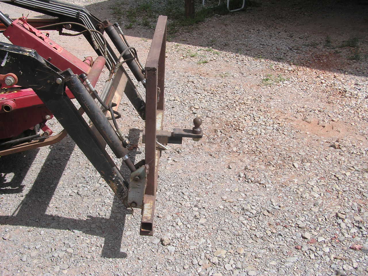

Wasn’t a fan of the hole in the end of the fork method so I welded a receiver to mine. Works great, and keeps the weight closer to the pivot for the heavy trailers.
   / What else do you do with forks besides lift pallets? #386
Wasn稚 a fan of the hole in the end of the fork method so I welded a receiver to mine. Works great, and keeps the weight closer to the pivot for the heavy trailers.

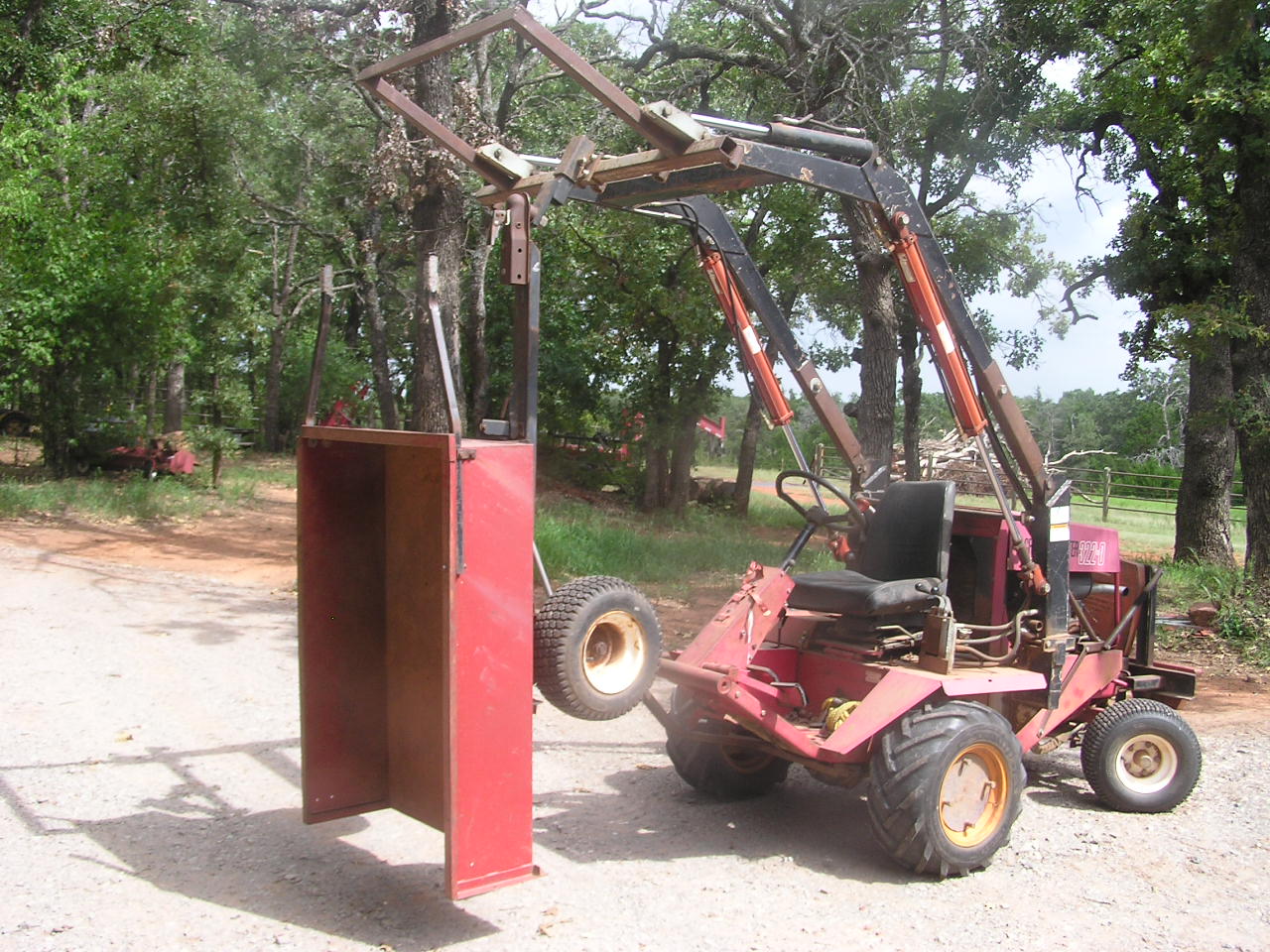

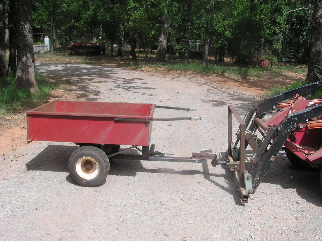

Yep, very handy:
Makes it a 90 degree dump trailer :D:

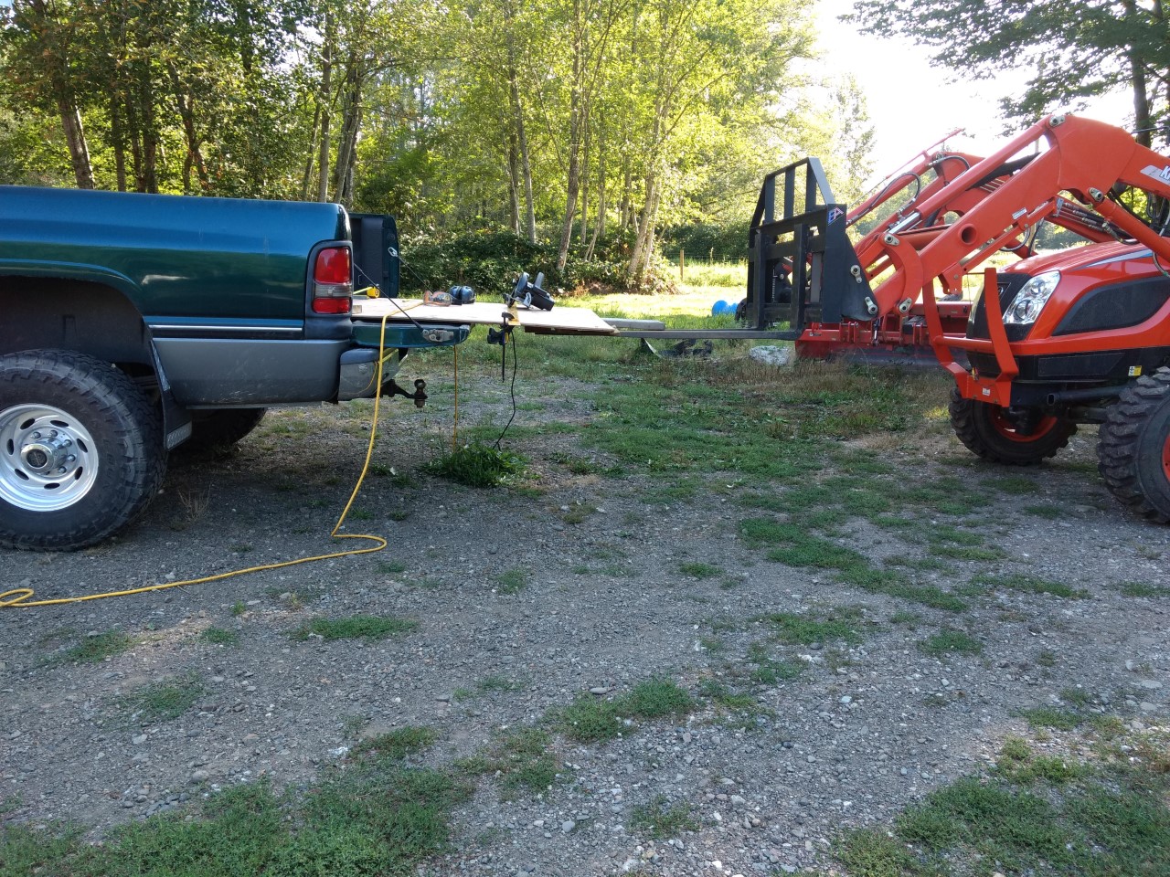

Been meaning to post this for a while now. It's kind of a variation on Cat_Driver's use-as-a-table.
