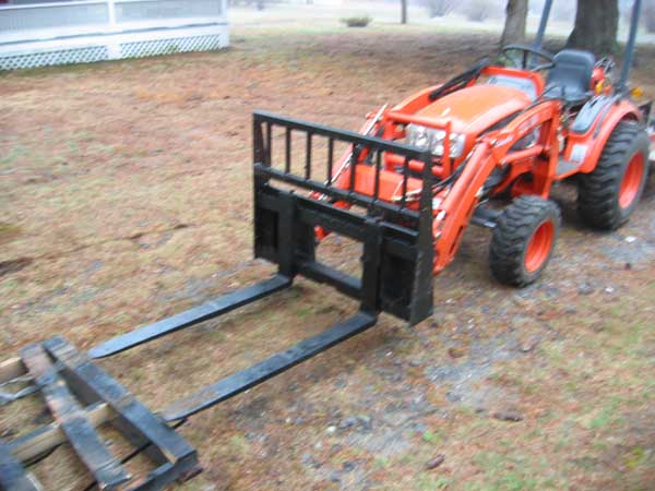

   / Used Bradco 48" Pallet Forks - how much? #4
That photo link did not work for me. However, here is a photo of the forks I just sold for $550. They were very good forks I just found I did not have as much use for them as I thought and they were oversized for my CUT. They were real skid steer forks.
Hopefully you can access picture now:
   / Used Bradco 48" Pallet Forks - how much? #6
Those look pretty much identical to the ones I sold. Condition looks pretty good to. It would be nice to know what size loader they were used on but you should be able to tell if there is anything bent.
