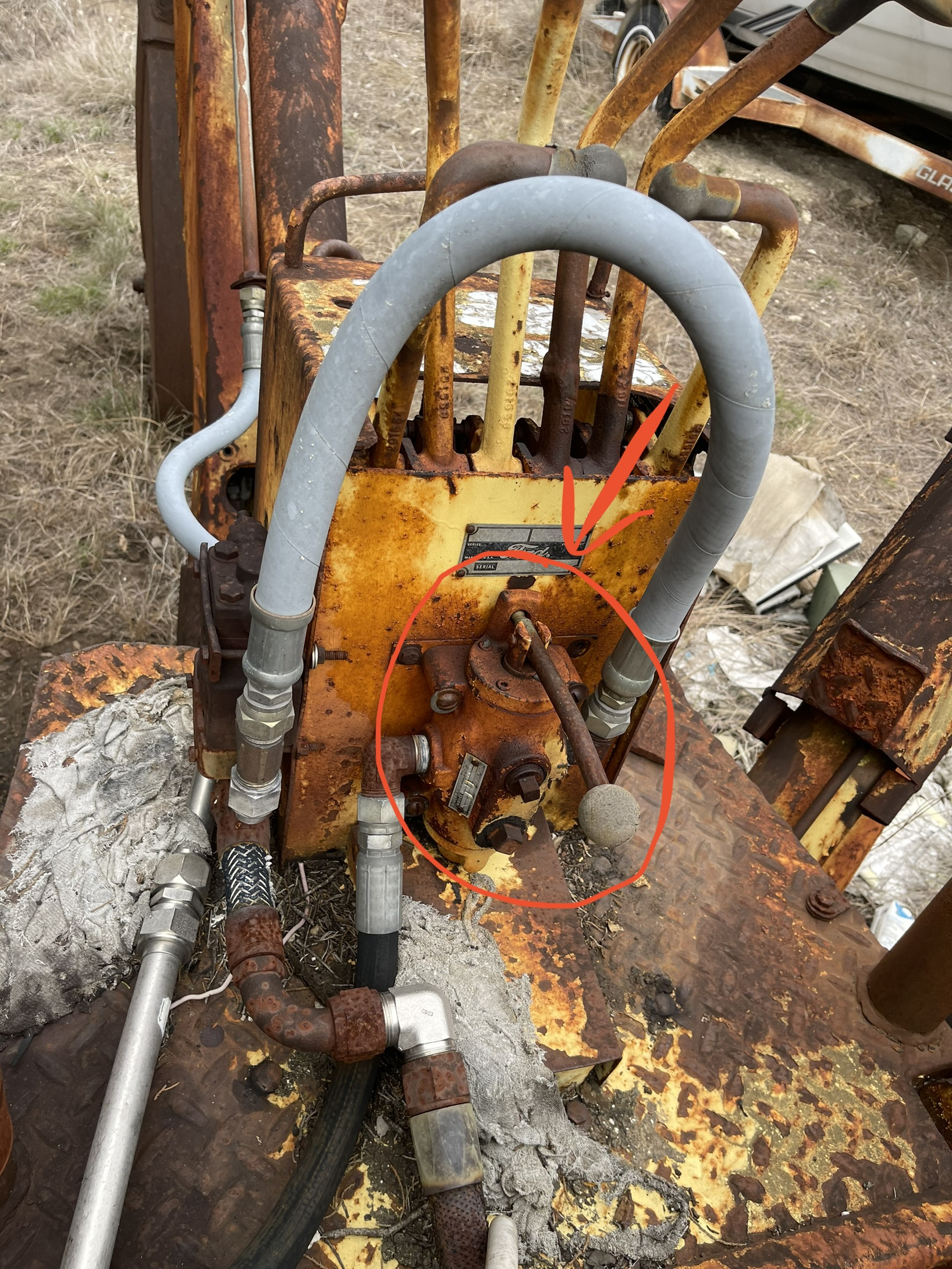

Steel line coming from the pump - I physically traced the line back and it connects to the outlet of the pump on the pressure side.
Black hose - the backhoe is a removable attachement. As such on “standard” equipment the back hoe would have a pressure connection, and a tank connection, so if you were to remove the backhoe after it is physically dismounted from the tractor you would disconnect the pressure and tank lines, then you would be able to drive the tractor away, leaving the backhoe where it sits. The black hose connects to the backhoe pressure line. From there it goes to the valve pack.
The fact that the 2 valves I am trying to figure out are physically mounted to the backhoe is purely coincidental (but probably convenient). They are not part of the original equipment, they have been added on.
Hopefully this helps, or let me know if I can provide more clarity.

Well the one on the side, that has the black hose coming off the bottom does indeed look like a type of relief valve. Where does the hose off the bottom go? Just back to tank?
The valve that is mounted on the control tower to the backhoe goes nowhere. It does nothing. Its just an open center valve that is serving NO purpose at this moment beyond what a simple coupler would do.
Now in the past it may have ran an attachment or hydraulic thumb. But since there are no other hoses, and the work ports are blocked off.....it has no function, and nothing to figure out

Could this actually be a control valve with the A&B ports plugged... And exactly what is gray hose connected to (on left side), another valve body( a "TEE" fitting)?...
   / What does this do? #15
e045aa2c-9b63-4a4e-b07d-bc1381dbba07-jpeg.776996
Yes, its just a control valve with teh work ports plugged. Like maybe the thing had a thumb at one time that was removed?
The thing on the side is just a pressure regulator

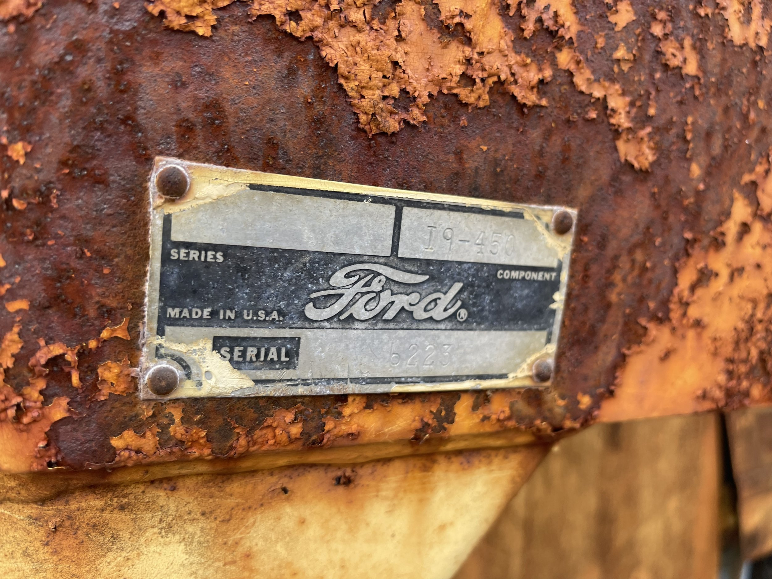

I called the loader a 450 because this is the tag on it.
Is that not the correct designation for the loader?
   / What does this do? #19
No that's a Ford component ID number
That's gonna be worthless if you need to order parts.
Step back and take a picture of the loader as a whole. They are supposed to be the 740 loader. But lots of parts and machines got frankensteined over the years so who knows what's actually on it
