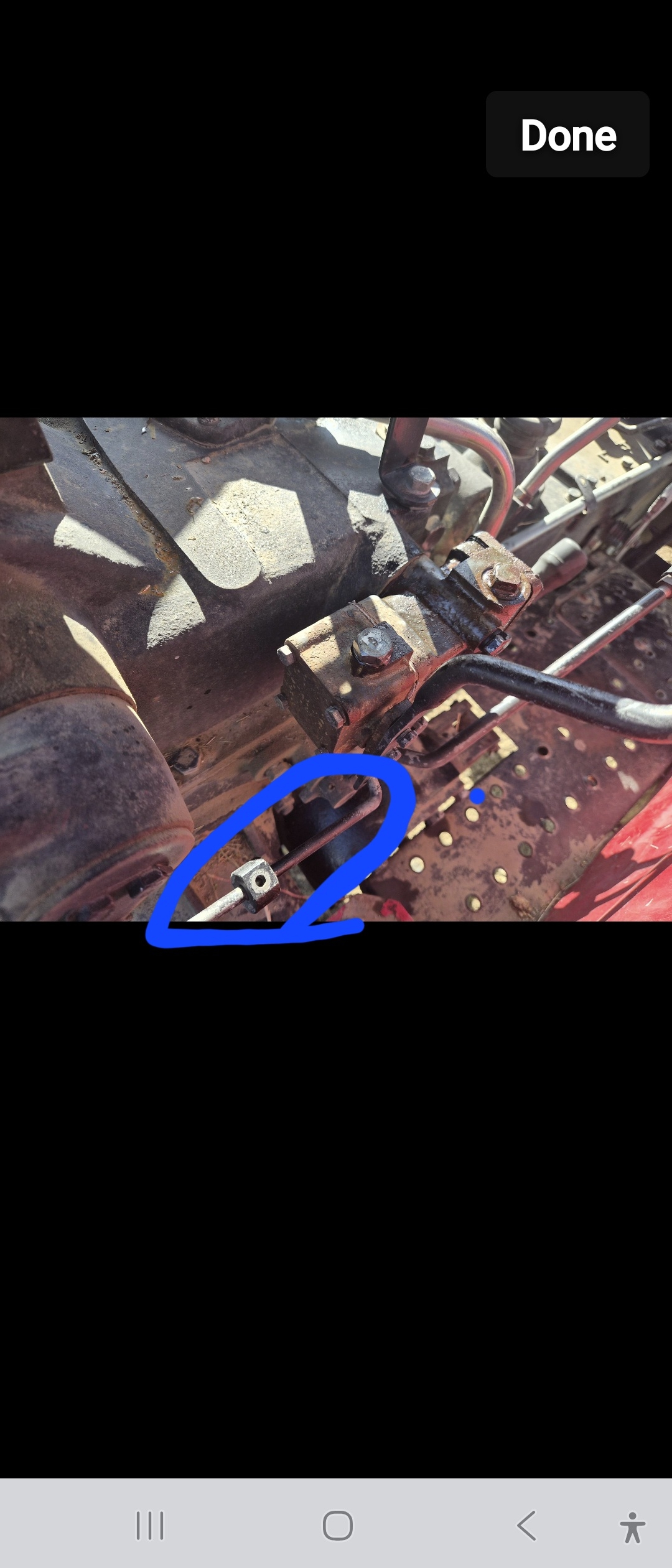

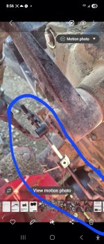

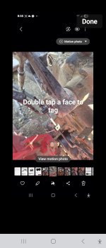

My hydro lift went to hell, and I'm trying to find the parts to fix it. What is this linkage thing, and is something missing? The pics show the arm with the two nuts, but I wonder what that black nut-looking thing went to. I ordered the distribution valve, but can't find the new linkage. Any help is much appreciated.

In the pictures you have there they are showing the unit is for controlling max lift and/or depth you want depending on the implement you are using.
I will attempt to attach some photos from the user manual. I only use a snow blower attachment so I am only concerned with how high it lifts. The dept I'm not worried about, I let it float. If I was using a plough however I would want to limit how deep it could go.
Hope this is a help!
