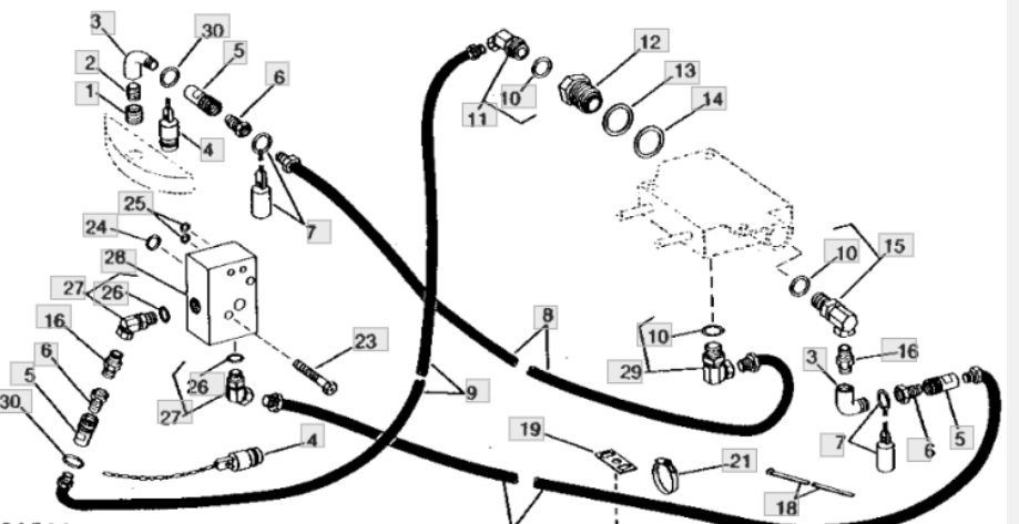

JD 820, 830 & early serial # 2040 have unique hyd systems compared to other JD tractor models. Is your tractor & loader hyd system attached to tractor utilizing a hyd block(item 28)?

This took some time to figure out. Something this ridiculous was causing a big part of my 3 point lift problem and it was in the original gresen loader valve. This broken seal goes inside the power beyond sleeve on the left side of the loader valve. There are two pressure inlets on this system and one return to tank. This internal seal closes off another oil chamber inside the loader valve. As soon as I put a new internal oring on this power beyond sleeve, the 3 point worked perfectly.
When the tractor is running, and I'm moving the bucket up or down and let off the valve to neutral, now you can hear the pump load for a split second and then quiet right down like no load until I move the three point or another hydraulic valve.
The rockshaft three point lift works better than ever! What a journey.

Well I'm totally confused because your JD 830 that has open center hyd's should have open center plug 12C not 12A or 12B which are for closed center hyd systems.

I don't understand this system very well myself Tx Jim, but after the single oring part #14 for #12 was replaced all my rear hydraulics started working normal? When I look at my loader hydraulic layout, it is exactly like this drawing with the three hose hookup and the left line going to the reducer / adapter with the inner oring that was bad? Is this not considered some type of power beyond or weird setup for part, #12? It did have the manifold block you asked about also next to my rear remote hydraulics.
Question,
How would the loader hydraulics, if always open center flowing to tank allow any pressure to build up for the rest of the system. This is where I get baffled. It seems like the loader you wouldn't want to flow to tank while the valves are neutral, to allow some kind of working pressure to the rest of the 3 point hydraulics. Unless my system shouldn't have the three hoses and maybe should be two lines. One pressure and one return. But there are three hoses like the photo below on this tractor. It says open center hydraulic system in the hydraulic picture below. Too confusing with too many options. Lol

My personal knowledge of power beyond hyd's such that your 830 utilizes is limited. It's odd that your tractors loader hyd control valve has open center plug with internal seal similar to closed center conversion plug while open center plug not for 3 rd hose system has no inner seal.

This is the image of the PBY sleeve o-ring and the 3rd hose (PBY) or port connection it came from on the loader control valve. It has been working flawlessly since I changed the o-ring. All the other RS parts I replaced have also helped with the power and speed of lifting.
It was never this responsive before it failed.
I hope this thread helps someone someday.
