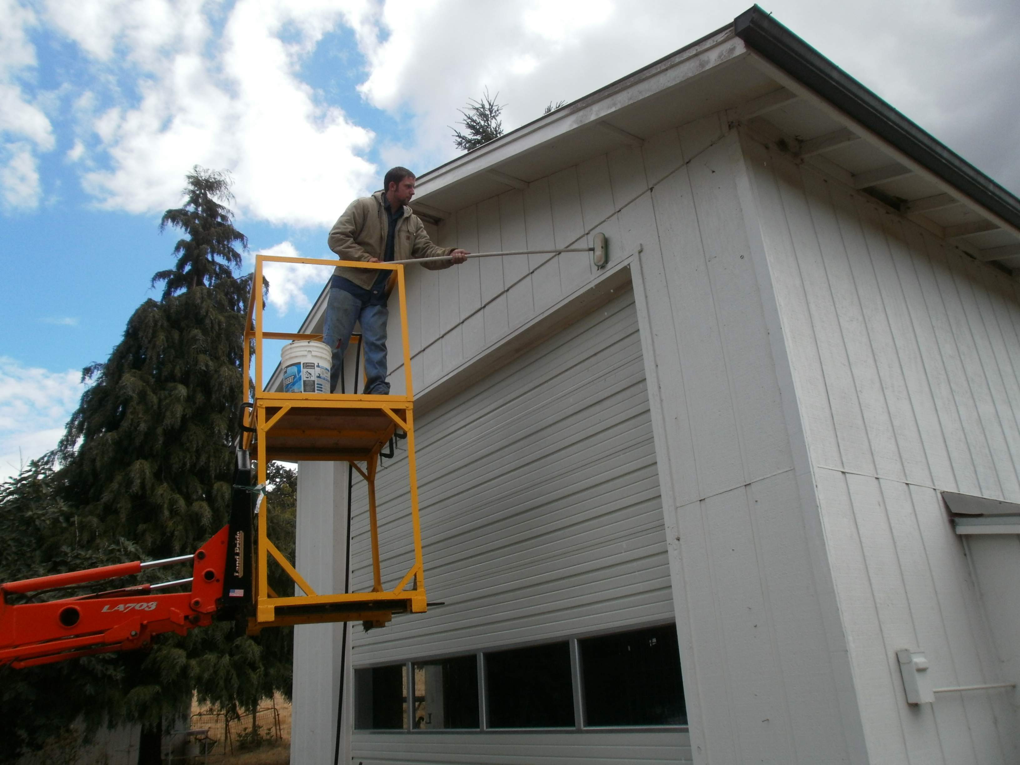

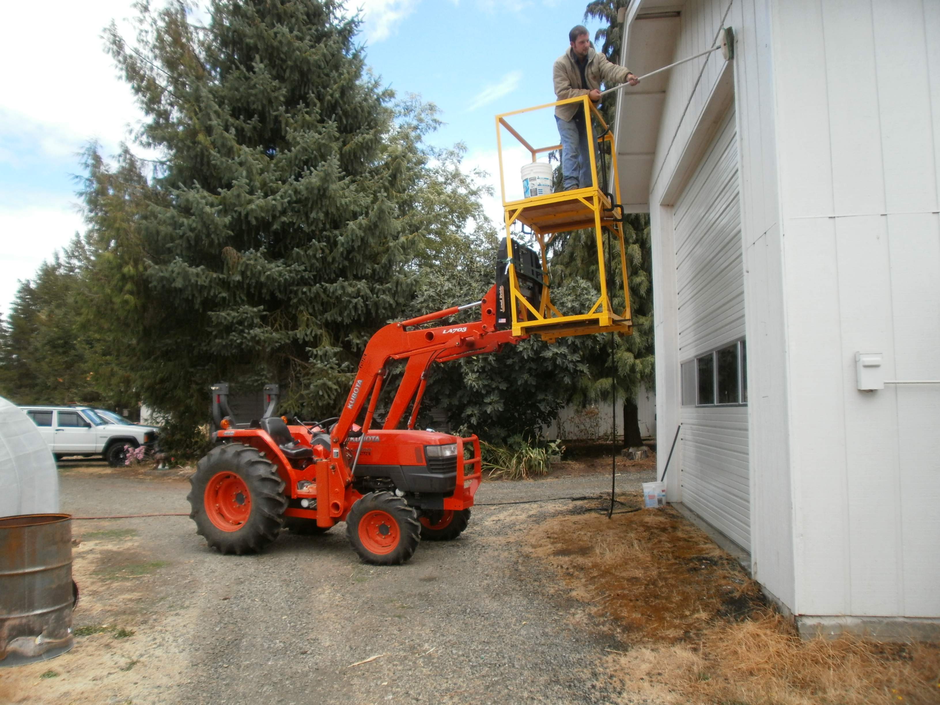

Home built manlift go swell with my Landpride Forks

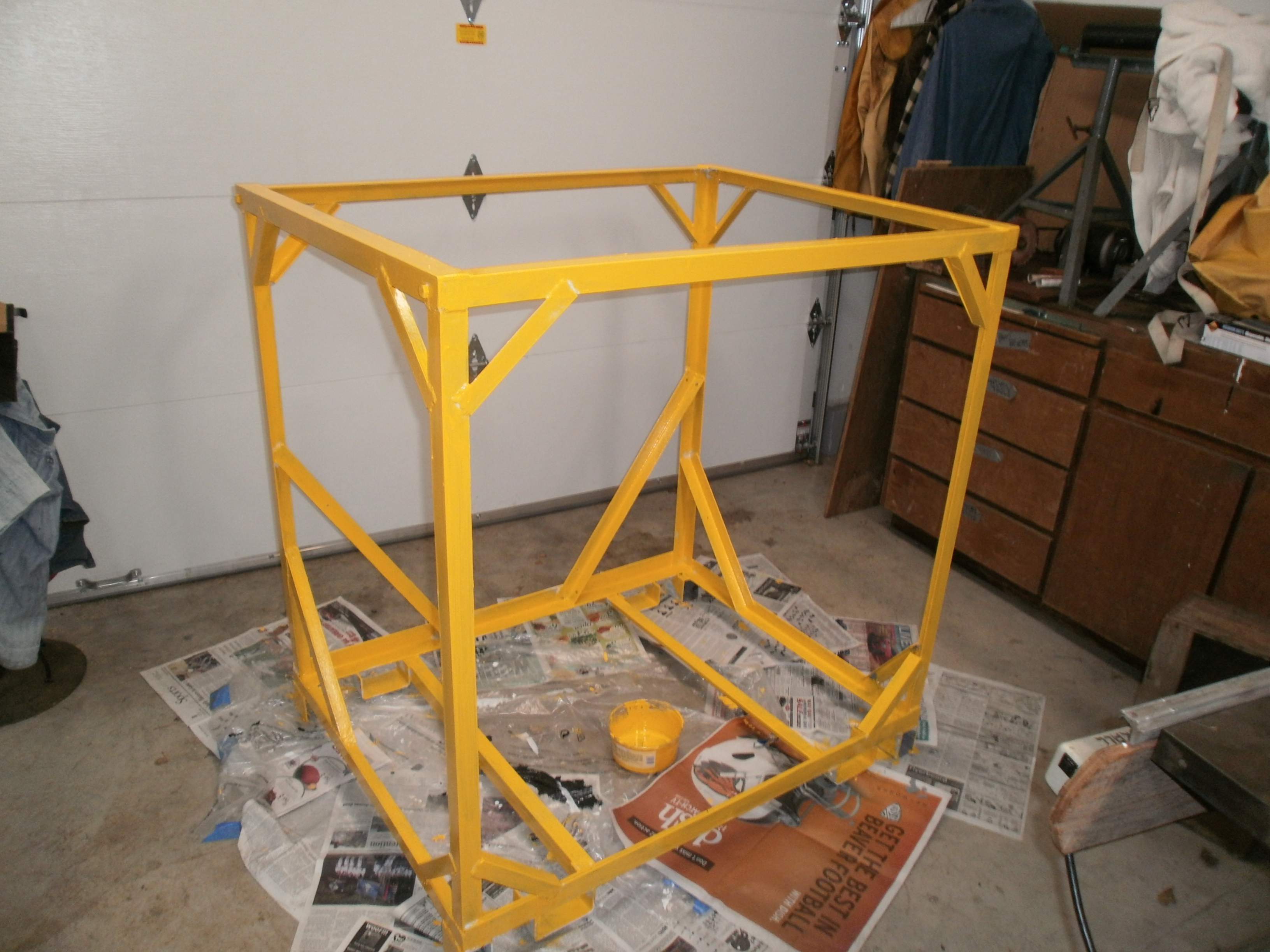

PC060036.jpgPC030031.jpgThe bottom basket began as the shipping pallet for a Woodmaxx hydraulic chipper. I worked great, but I needed more height. So made another one to bolt down on it. Then I decided that I liked having it be easily and quickly switched on and off so I went with four inch steel C Clamps. The lower pallet deck is milled douglas fir two by lumber.
The upper basket deck is one inch plywood. Both decks are bolted and nutted through the angle iron tray. Underneath the top deck, I have PT two by four on each side, screwed to the bottom of the upper deck. On top of the deck is one inch wood. SO, My clamp points are spread out considerably with the use of those two boards. It is strong as can be . Oh and I forgot to mention, I have foam rubber strip between the the top of the lower basket and the bottom of the upper basket. It all makes for a nifty install.
In my view, the only slightly sketchy thing about those pictures are the C-clamps holding the 2 frames together.
Can I ask what you repurposed those from?
Thanks,
Thomas

Hi HSL,
Thanks for the reply and the details, I wasn't really meaning to troll you about the construction, I'm just jealous and trying to figure out what I can use to make my own.
In other words, nicely done!

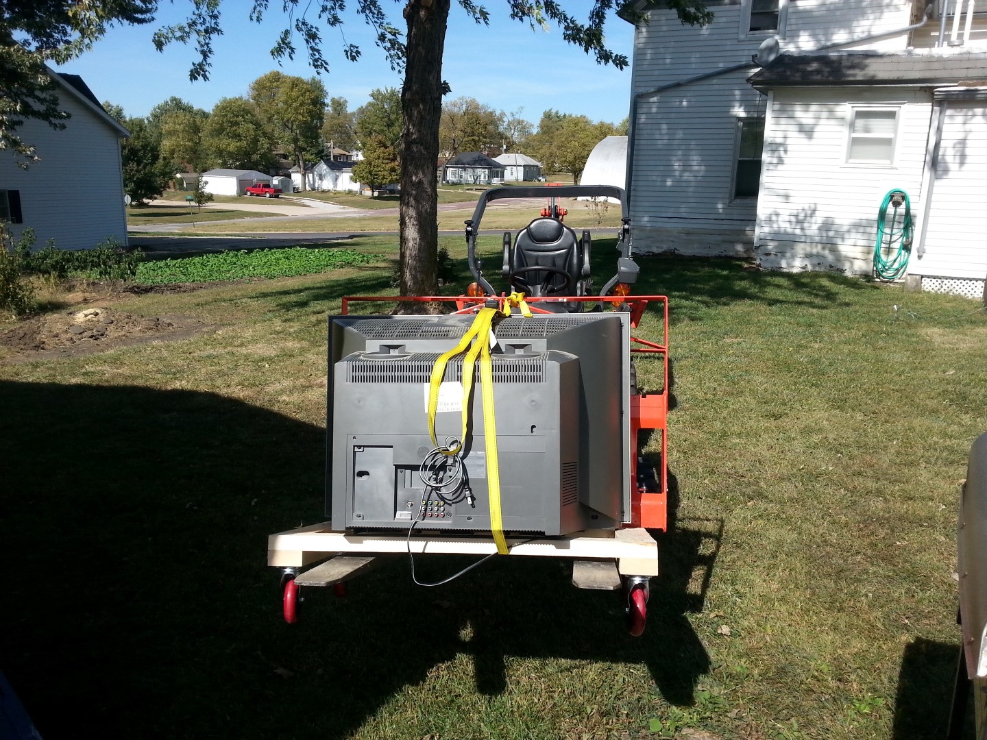

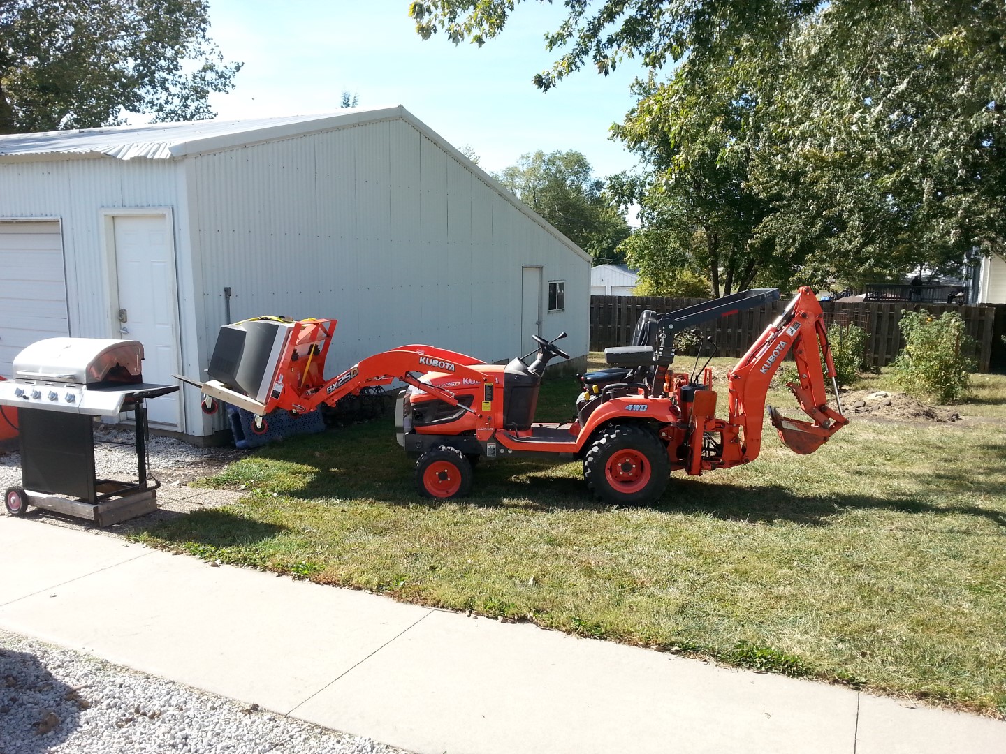

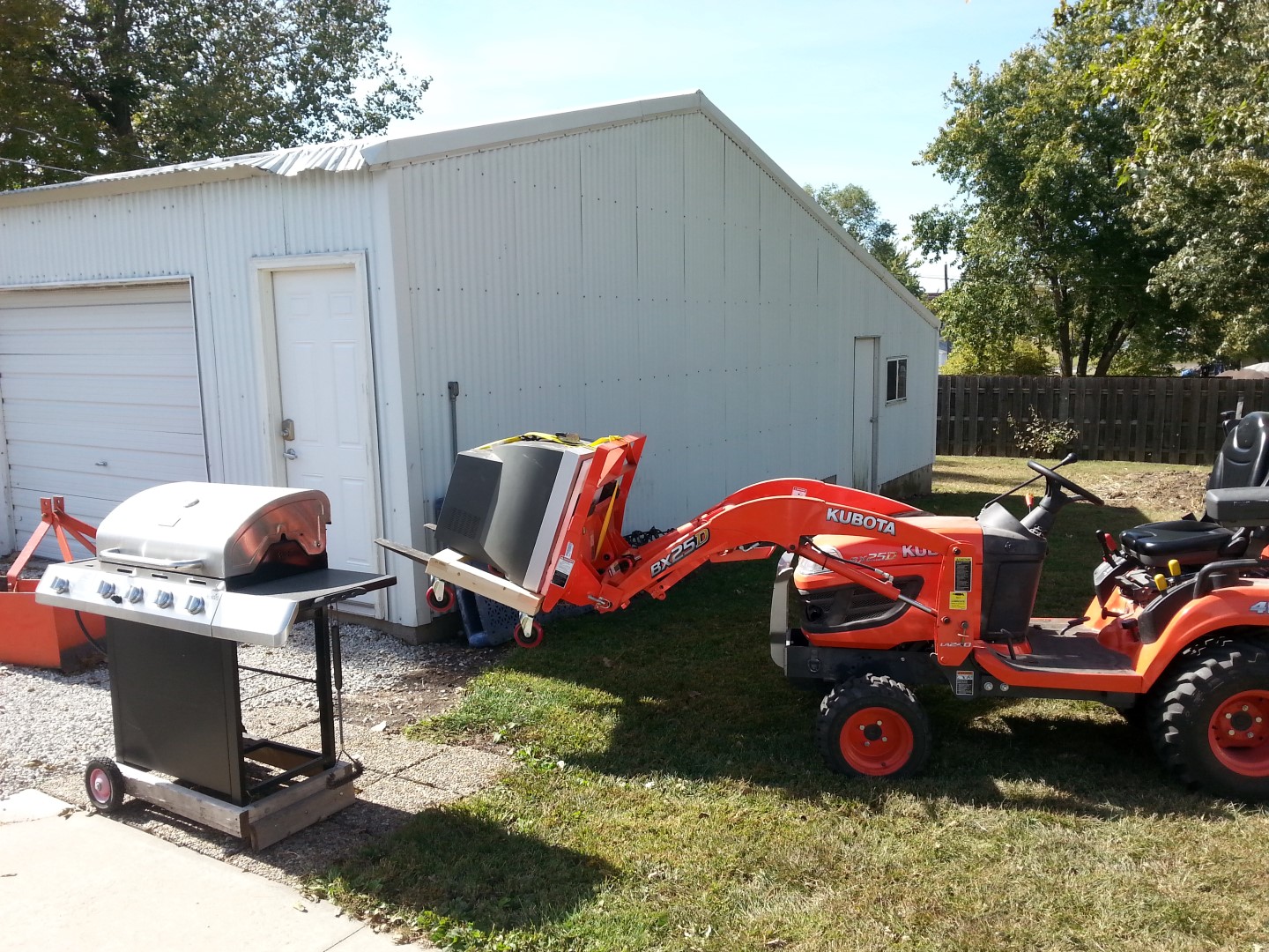

How about forks for donating an old TV to the local thrift store? It's a 34" flat screen and probably weighs 200#. I made a second trip and took the TV stand with a few extra things thrown inside.

You are lucky they will take that.
Around here the needy only want LCD's and thrift shops refuse all tube and projector types.
Our only option is the scrap yard.
I don't know if they want it or not but they have a room open 24 hours and you walk in and drop stuff off. I'm sure they get stuff they don't want.
