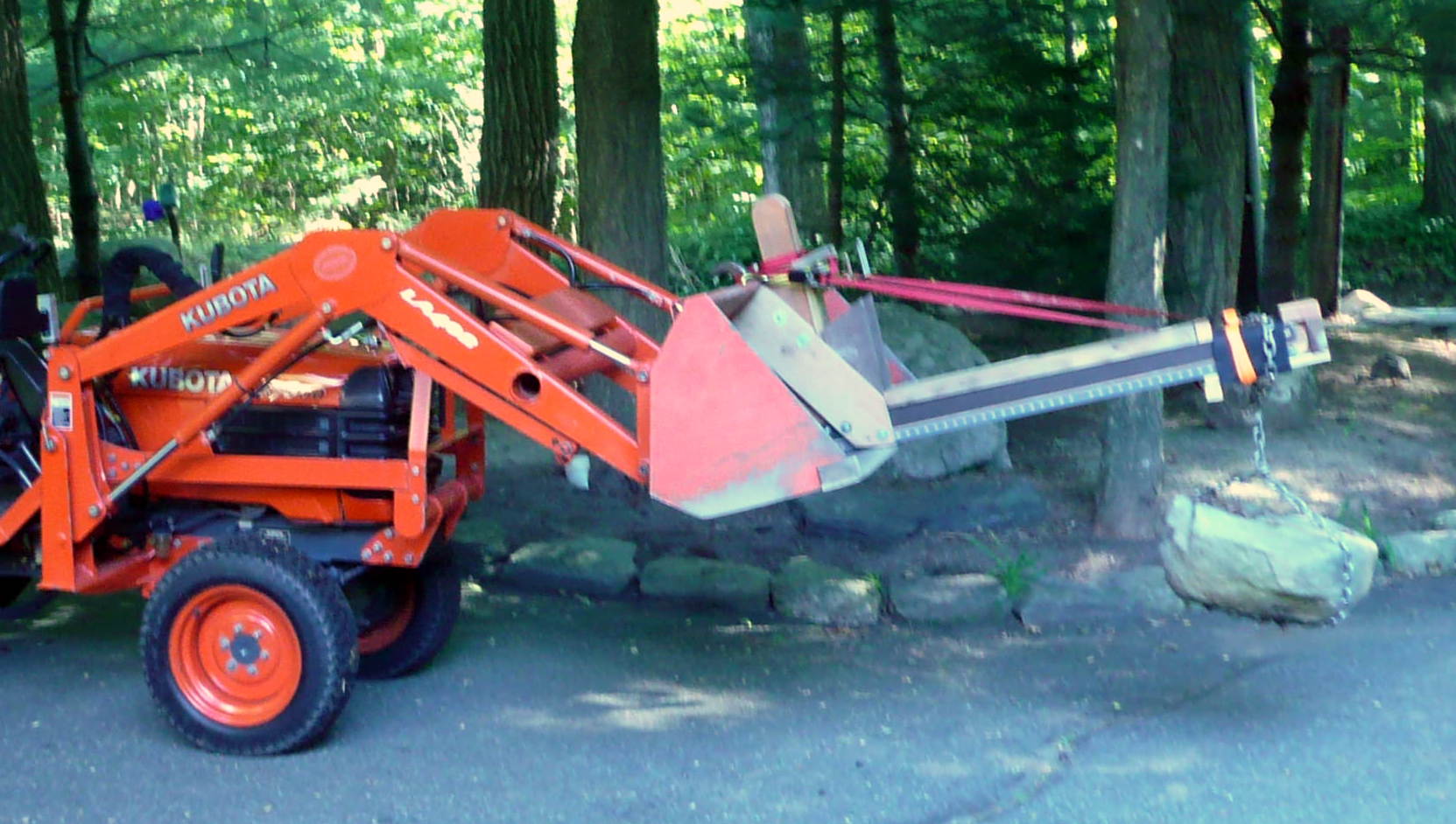

Wooden forks passed the test again today.
I needed to lift and place some stones in the back of a garden bed. I set
the forks closer together and secured them with some wooden braces and straps.
Easily lifted and set the stones in place while not having to drive into the mulched and planted garden bed.
Great additional extension allowing me to work further ahead of the front tires and avoid damage to the finished beds.
Also used them to place flat stones higher up on a steep bank than I would have been able to with just the bucket.
Made the days work a lot easier and faster!!
Wooden forks did the job today.
