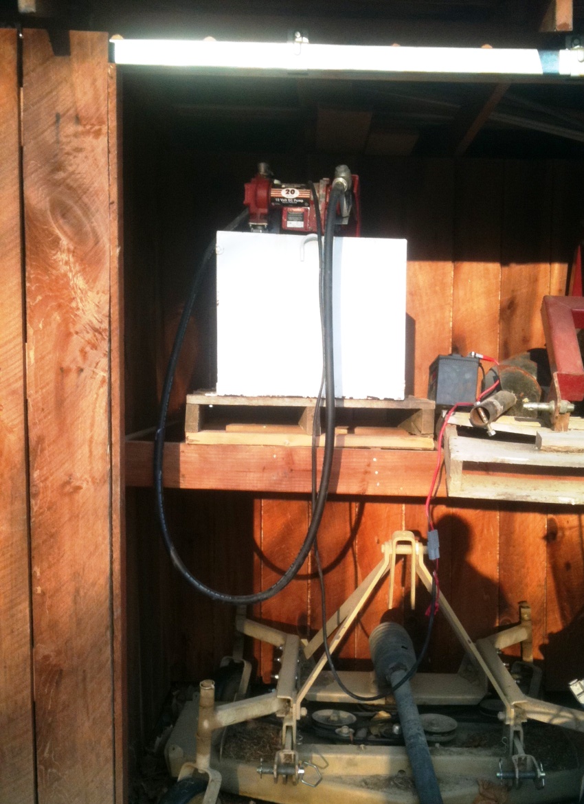

I use a 55gal transfer tank and 20 GPM pump I picked up off of craigslist. I had to add a filter, hose and tank adapter but the price was right ($100) and the pump actually worked:D
It's bolted to pallet and I pallet fork it to the truck and fill at the farm co-op. It lives on a shelf I built into the shed with a sliding door so it's out of the elements but still easy to get to.I use about 50Gal every 6 weeks-ish so this is much more convienient than 5 gal cans, especialy with the JD fuel fill location on the top of the hood:mad: Was a major PITA with cans but is no problem with the nozzle.
Right now it's powered by a L&G battery that I throw on the charger every few weeks, but it uses tha same connector (Anderson SB50) as the one I put on my Gator, tractor, truck, and lawn mower so it can be powered by any of those also. My battery charger and 1.5amp maintainer have been converted to the same connectors so they can be swaped easily to any of the above with out having to access the battery directly. Power is trenched to the shed but I haven't had the main pannel connected to the meter yet but soon. Then the maintainer will wired up in the shed and rotated among the different batteries. Or at least that's the idea:cool:

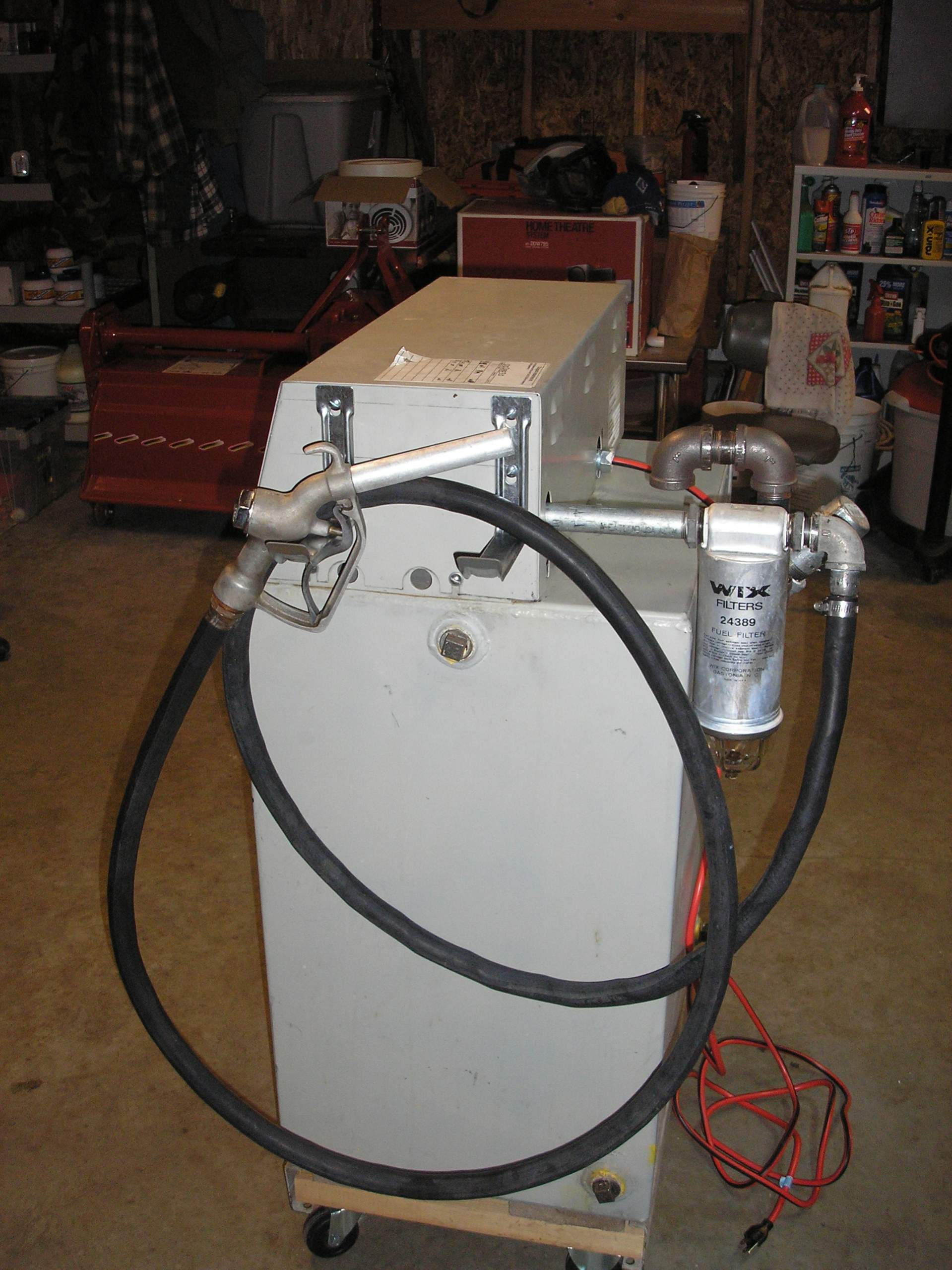

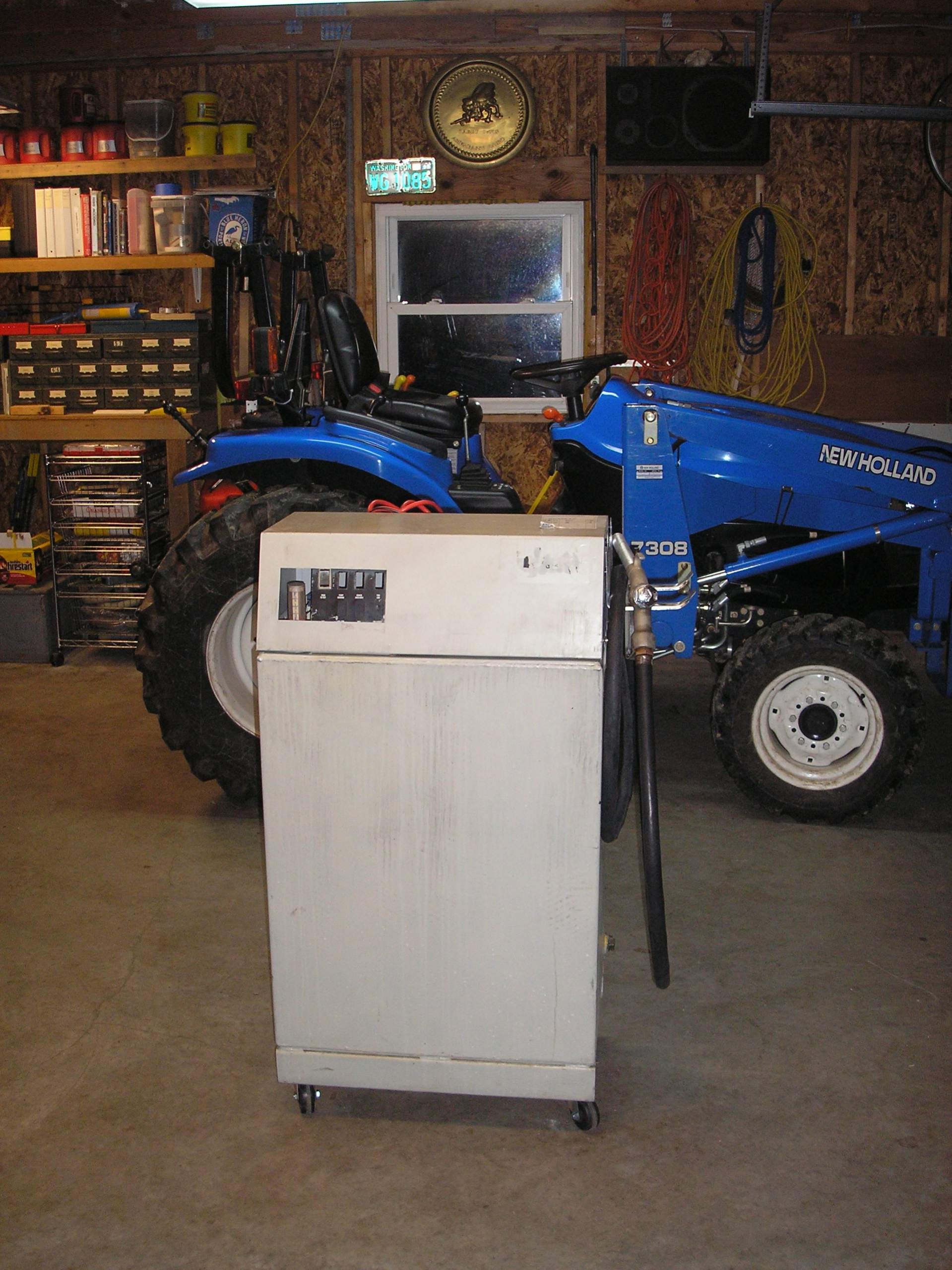

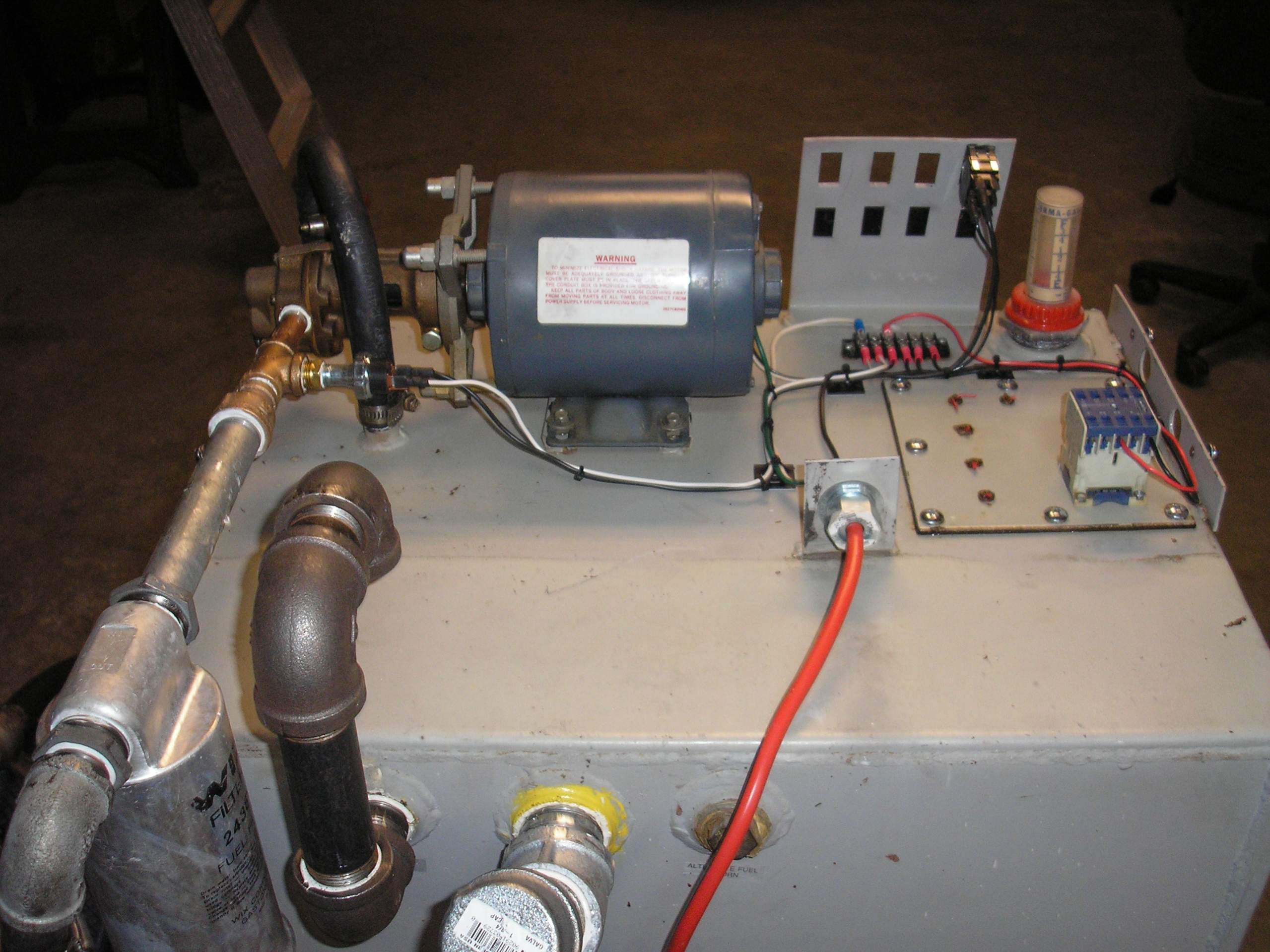

Probably not much help but if you could find a building generator demo project you might get the day tank, at least that's how I got mine. I had to reverse the motor and install a down tube so it pulled from the bottom of the tank instead of filling the tank (gravity fed the gen) and wired a pressure switch through a relay to control the pump. A friend donated the pump nozzel and filter housing so all together I got about $50 in a 40gl fuel tank. I load it in the truck about every 8 months and add stabilizer at fill time.
