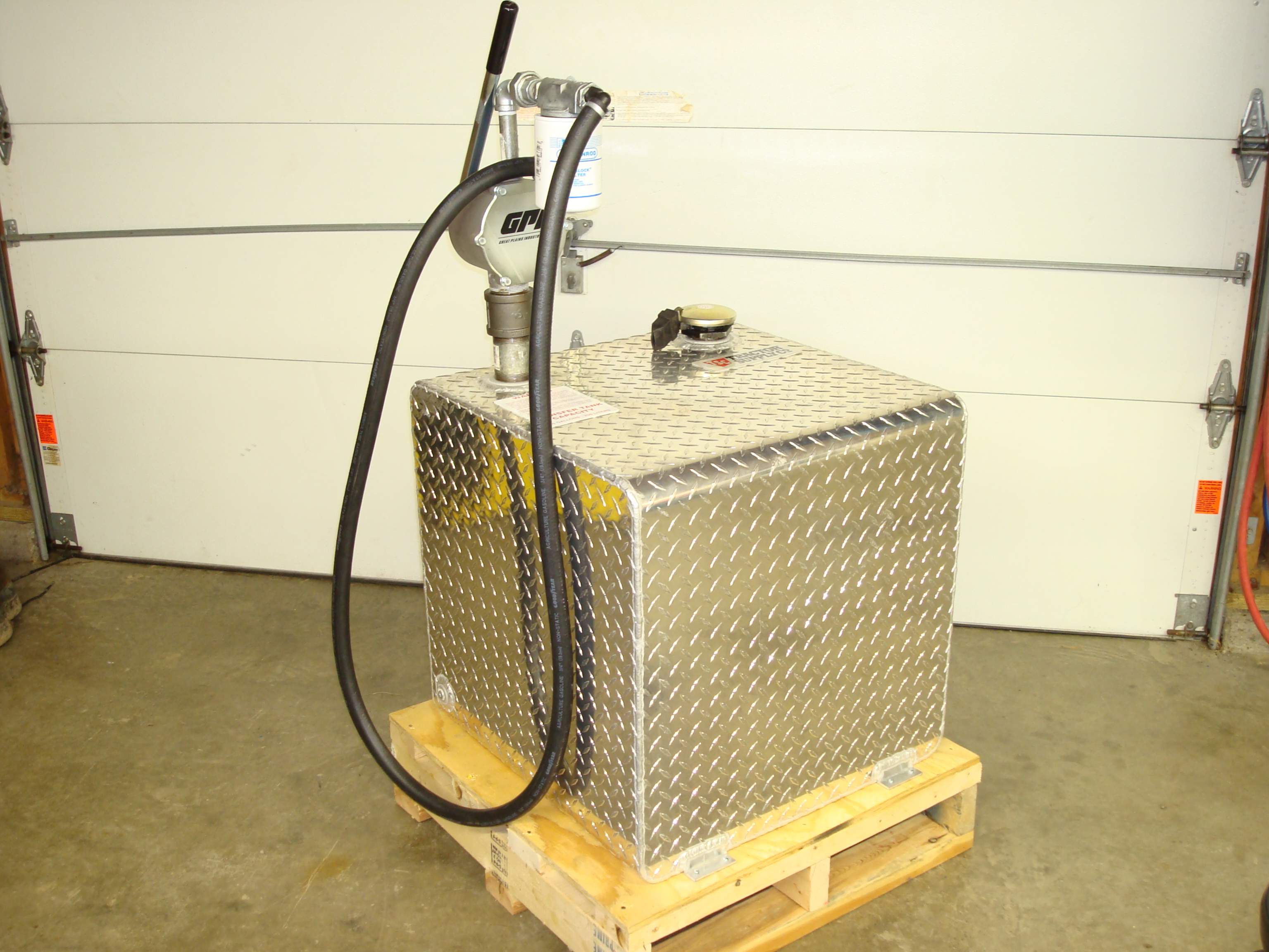

I bought this 55 gallon Aluminum diamond plate tank at tractor supply along with the vented lockable cap, hand pump. Decided to make a pallet as a way to lift it up and place in the bed of my pickup with my forks on the FEL. The tank I chose had tabs welded on the bottom so I could screw it down to the pallet. I can get 4-6 months run time out of a tank. I got tired of wrestling those 5 gallon cans and the spillage associated with them. Looking back, I should of bought a painted carbon steel tank that would of been just as good and a lot less money.
Whats the part number of this tank? I think I'd like to have one of these.
Jenrow33
Here's the part number for the Carbon Steel painted version - SKU Number: 0828000. They might not carry the Aluminum ones any longer, I don't know for sure. Good luck.

Forgot to mention about welding ears or eyes on the tank for lifting. NOT a good idea. Those metal tanks are very thin gauge and without some major reinforcement pads, you will likely rip them off the tank and spill your fuel. Mine has tabs welded on them but these are only for lifting when empty. Safest way would be to build an angle iron frame around them with lift eye if you needed to lift them that way. With the wheels on mine, I can pass a chain or strap under it if I needed to lift it or if I had some pallet forks, which I dont, I could use that. So far I have not had to lift a full tank and empty it can be handled by hand pretty easily.
/ what do you do for fuel storage? #50
I plan on using my pallet forks. The tanks are only 11 g wteel...way to thin to lift full
Did you get that at Tractor Supply?
Wedge
/ what do you do for fuel storage? #55
Wedge40,
Yes, I bought mine at tractor supply. Mine tank sits in my barn in the tractor bay on the concrete floor. If I had it to do all over again, I would buy the painted carbon steel 55 gallon tank and save money. My Alum tank on sale was 350 bucks. That 55 gallon tank has saved me a lot of headaches and trips to the fuel station. Good luck.

I also wanted to mention that having my 55 gal diesel tank locked in the barn is a nice security measure. With the price of fuel, the thieves have been active. Fuel and copper seem to be hot items they look for around here.
