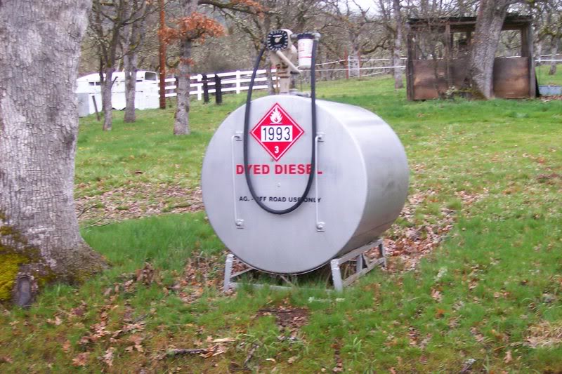

I just had a 100 gal steel tank made and put a 13 gpm fill rite 12 volt pump on top attached to a deep cycle battery. Using solar charger to keep battery topped up. Works well. Had fork slots and lift eyes put on the tank so i can run it down to a local station to fill. Anyone know where I can buy red diesel in northern california, specifically near Santa Cruz?
