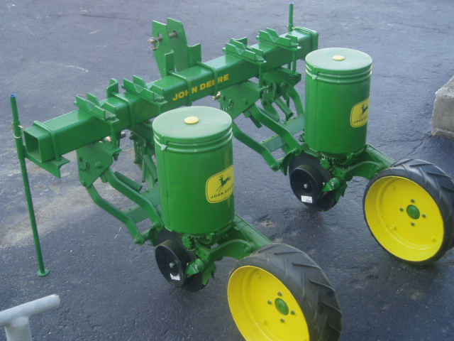

dsgsr said:
Folks, That BAR that has all the holes in it that hooks between the lower draft arms IS called a TOOL BAR.
David
NOPE! A Tool bar is a totally different animal. What we're talking about in this thread is a DRAWBAR. A toolbar does (usually) mount on a 3-point hitch, but it serves a completely different purpose. They generally come in 2 sizes. (2-1/2" X 2-1/2" or 4" x 4") They're used to mount row units for cultivators, bedders, planters, ect. They allow row units to be positioned at various spacings dependent on desired row width.
The first 3-point drawbars were the brainchild of the man who invented the 3-point hitch, Harry Ferguson. Early Fords and Ferguson tractors had no drawbar mounted under the tractor to encourage the use of the 3-point hitch. The 3-point drawbar was available to allow drawn equipment to be hitched to the 3-point draft arms instead of the non-existant swinging drawbar on those tractors.
Here's the only picture I have available that shows a TOOLBAR. It's the 4" X 4" piece across the front of this planter that the 2 row units are hung from.

   / What do you call this #14
I did notice one poster mention that swinging drawbars were more prevalent on older tractors.
Perhaps he should have said "bigger" instead of "older"?;) Of course, I don't know for sure that's actually the case either, but in my own personal experience, that seems to be the case. Neither of my B series Kubotas had the ability to swing the drawbar to the side, but the old Oliver I used for cutting and baling hay did.
And Farmwithjunk has defined the "tool bar" as I know it. My Kubota dealer used to sell a small implement assortment; a single tool bar, onto which you could bolt a single bottom turning plow (moldboard), or two small middle busters (to make a bedder), or cultivator plows.
