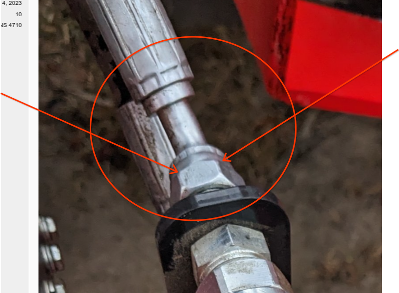

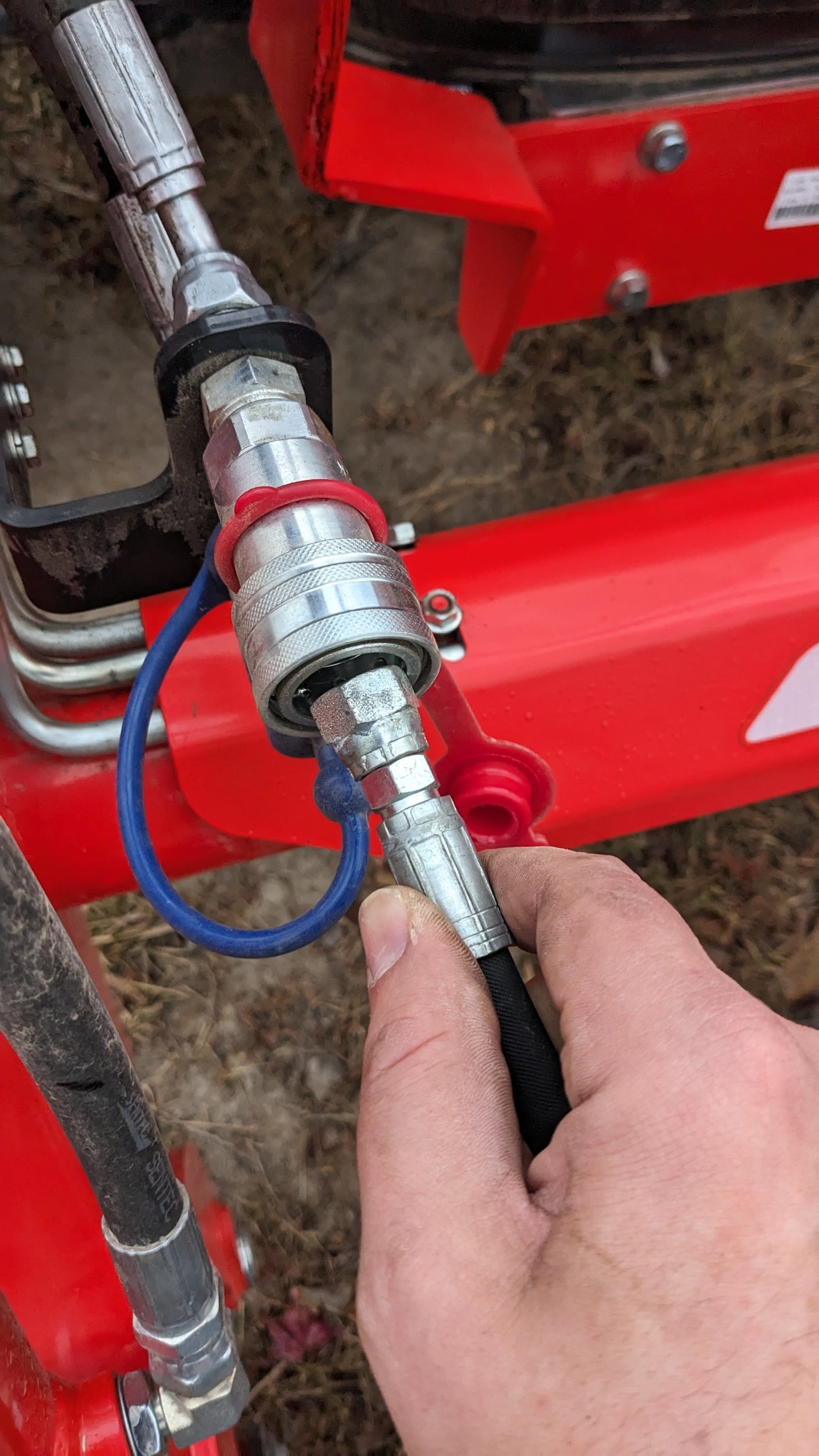

this is a dealer installed third function valve on Kioti 4710. Im a new owner so I'm not sure what I'm looking for but I'm guessing it's something fairly common. the hydraulic hoses on the attachment can fit inside of 3rd function coupler.
/ What do I need to make this connection? #2
what you've got in your hand is the equivalent of the end of the hose behind the connector there:
You probably need the male one of these (on the right)
plus a nipple (short segment with male threads both sides)
or possibly if that's a 3/8" line in your hand and the coupler is a 1/2", you may also need a bushing.

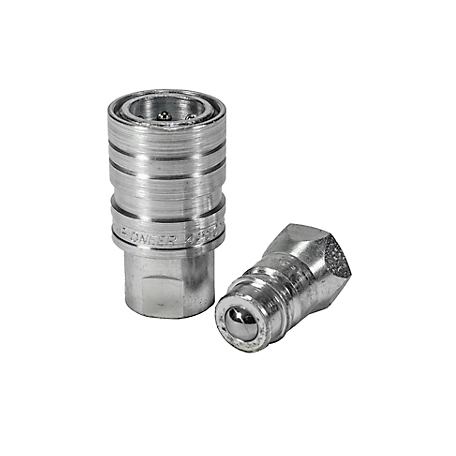

Ask the dealer what kind of quick connect fittings to use. It's likely 1/2" "AG" (ISO 5675) coupler but there's a number that look about the same from the outside.
You will need hydraulic fittings to adapt the hose to the male coupler. Don't use pipe fittings, they are not rated for the pressure. SurplusCenter is a good on line source. Or you can go to a local hydraulic parts store.

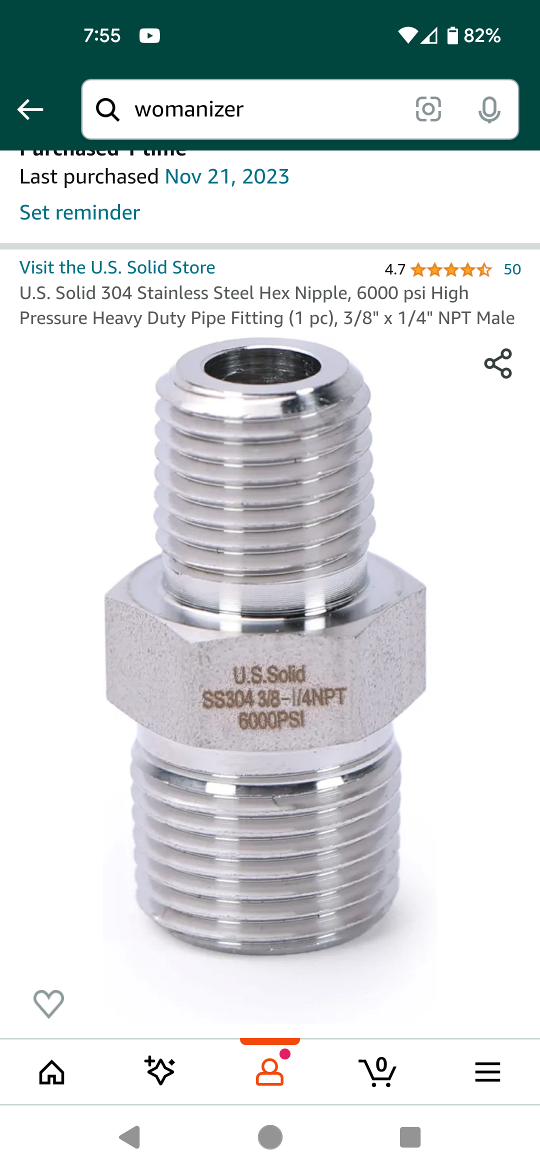

what would the maximum PSI be in something like this? I found these 1/4th to 3/8 nipple or whatever. is this sufficient @ 6000 psi? and then a 3/8th female to male quick connect. could very well be 1/2 but I rolled the dice to hopefully get it going this weekend. just concerned about that male to male reducer and whether or not that is appropriate? I've seen JIC(?) bushings as well but it seemed like 6k psi would be enough.

Not sure where you are getting 6000PSI.... Most systems top out about 2500PSI at most or maybe even less.....
  • qd_sizechart.pdf
/ What do I need to make this connection? #13
6000psi is how much the part is rated for - obviously fine for 2200-2600psi

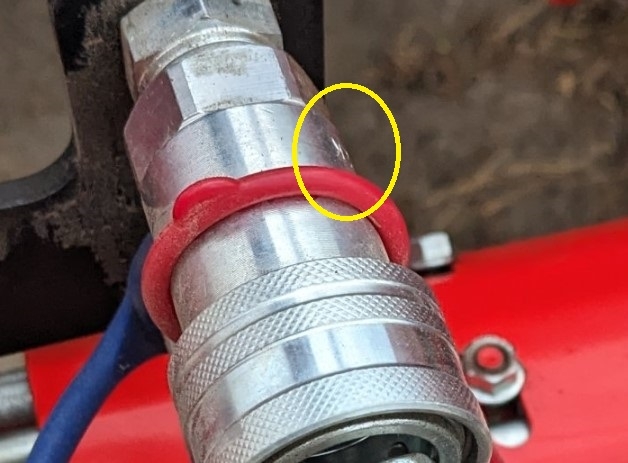

Does this help any? part appears to say 1/2 PT-22k but that doesn't really return any results online.
also. on the attachment side... this is 1/4th JIC, correct? does the size of the hydraulic hose matter? IE can I get a female to female 1/4JIC to 1/2 JIC, carry out the line with new 1/2 inch hose and then terminate with the 1/2 inch coupler?
Maybe this will help..
And...
  • thread_guide.pdf

No one here can really tell you the exact sizes, they do dumb things with hoses, you can have 1/4 hoses, and 3/8 and 1/2 inches ends installed.
you either need to measure them with a caliper and go figure it out against a chart, or and by far the easiest, is take the hose from the attachment, and the quick disconnect from the 3rd function to a hydraulic store, and tell them to make either a end for your hose that works, or adapters to make it work,
you probably just need a jic to npt to qd male setup, but what size that's going to be needs to be measured.
I had to use a jic5-6 adapter to make some of my stuff work etc.... hydraulic fittings are all over place, its ridiculous.
it can also be sae 45 or jis 30, you really can't tell easily, I actually pulled my fittings into cad software to measure the angles on the seat to confirm, its ridiculous.

based on dealers pictures I really think this is 5675? does that make sense? do you agree? 1st picture is know 1/2 AG Hydraulic quick connect iso 5675. 2nd picture is dealer.
If this still isn't right I guess I can drive out to dealer and pick up some QDs and work my way backwards. I appreciate all the help!
