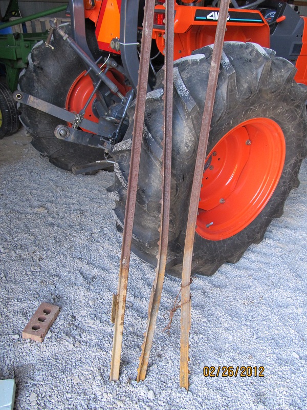

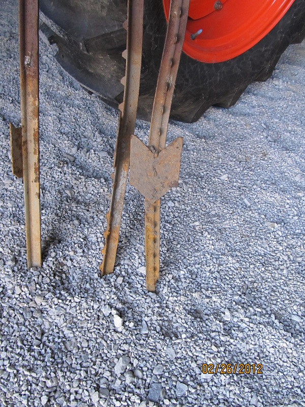

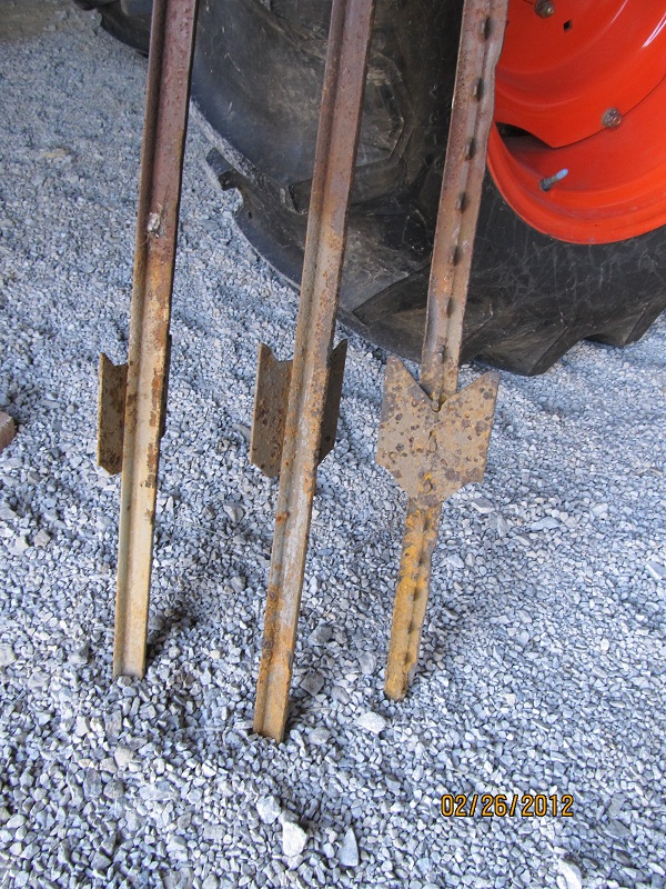

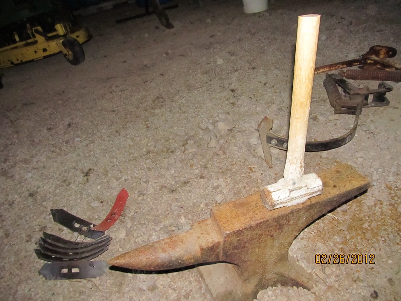

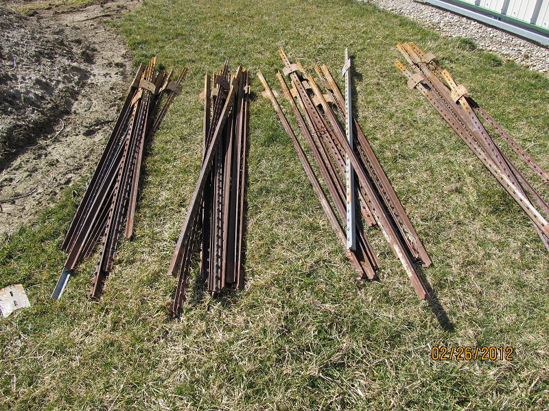

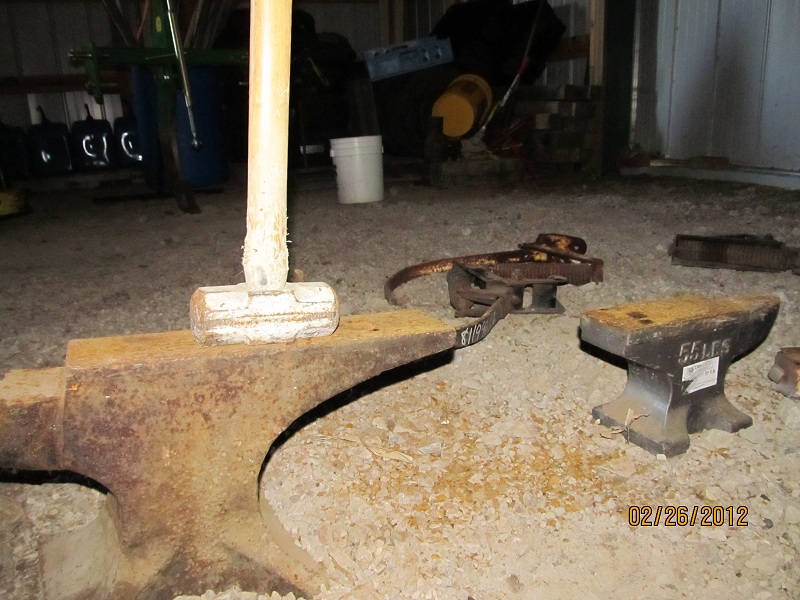

Today I discovered you can straighten bent steel posts with an anvil and a sledge hammer that's been shortened. I bought 35 nice long and heavy steel posts at an auction--cheap--since they were all bent. Anyway, here's some before and after photos. The first photo is mildly bent and then straight in the second photo. Third photo shows a post with a double "S" bend that came out OK and is in the fourth photo.
The 5th and 6th photo shows my avil setup and shortened sledge (6 lb?). It took seven whacks to straighten a mild curve and at times I had to lay the post between anvilsto get that final swweping curve out. Last photo is 35 straight posts and 32 were bent when I started. Took maybe 45 miutes.
