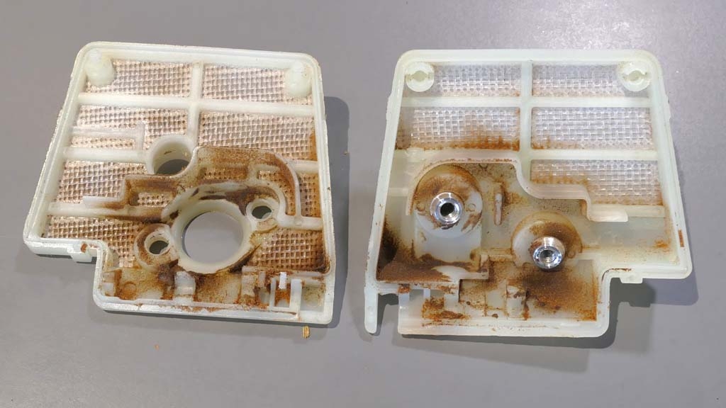

My always reliable and dependable Stihl 026C (the C means it has a decompression button) wouldn't start yesterday just when I needed it to clear a fallen tree over a fence. I last gave it a good workout a month or so back cutting rounds of hardwood firewood.
OK - gotta be fuel or spark! I'd just topped up the fuel, so decided to check the plug. Air filter looked reasonably clean, since I regularly brush it clean, so I undid the two retaining screws which hold the (aftermarket) air filter to the carby, then applied gentle pressure to pull air filter off the compensator tube. In doing so, it partially split the filter in half (the way they're built) and I noticed dirt and crap on the inside!
Aha, I thought, carby full of crap. But since I'm here, I'll check the plug anyway. It was quite wet and oily, so replaced it, then pulled the starter to see if it would start. Well, it did.
So I don't plan on sticking with those cheap aftermarket air filters after this, and will stump up for the genuine article. But I will source a carby rebuild kit anyway. After 25 years or so, it's probably time!
