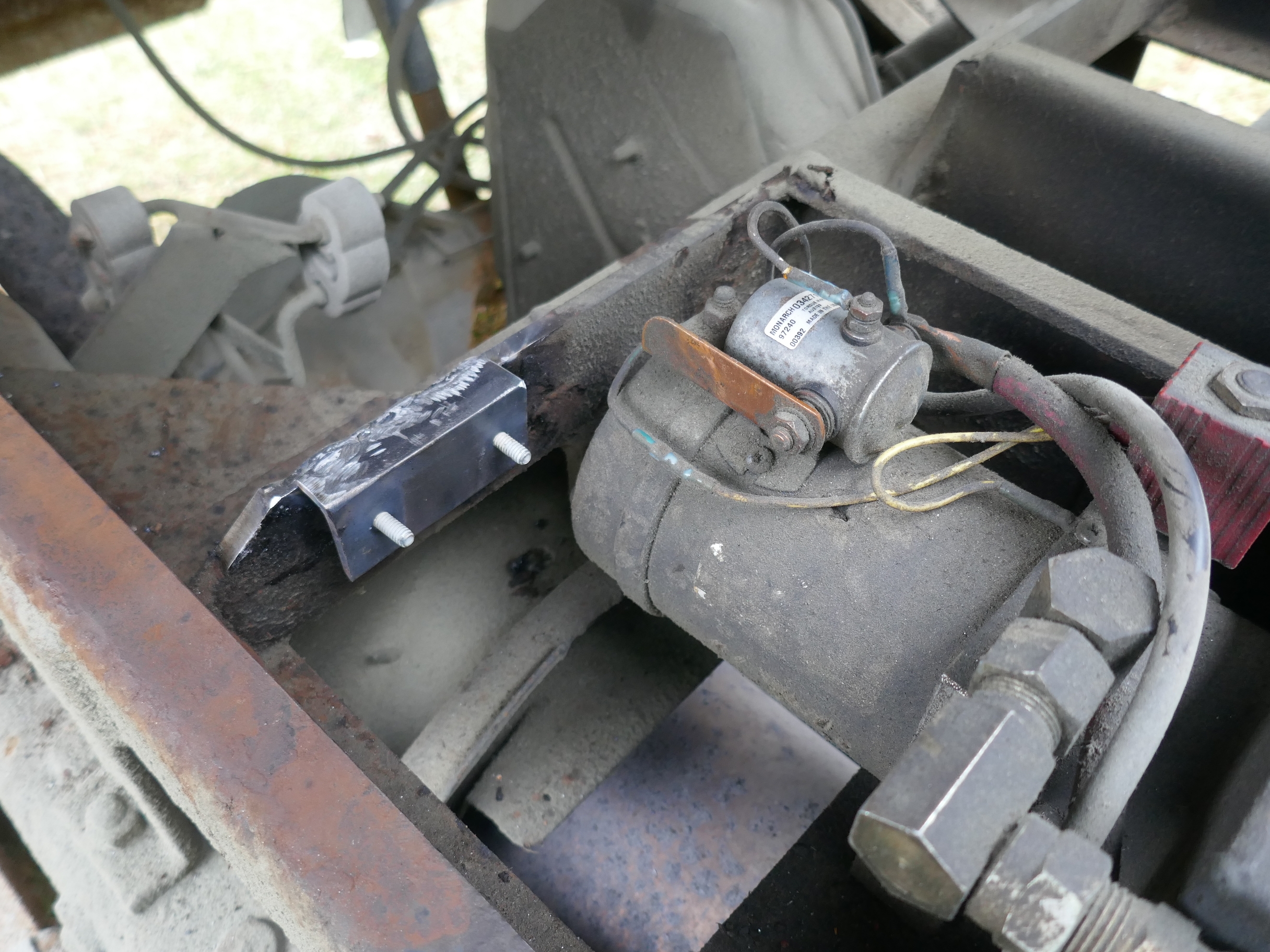

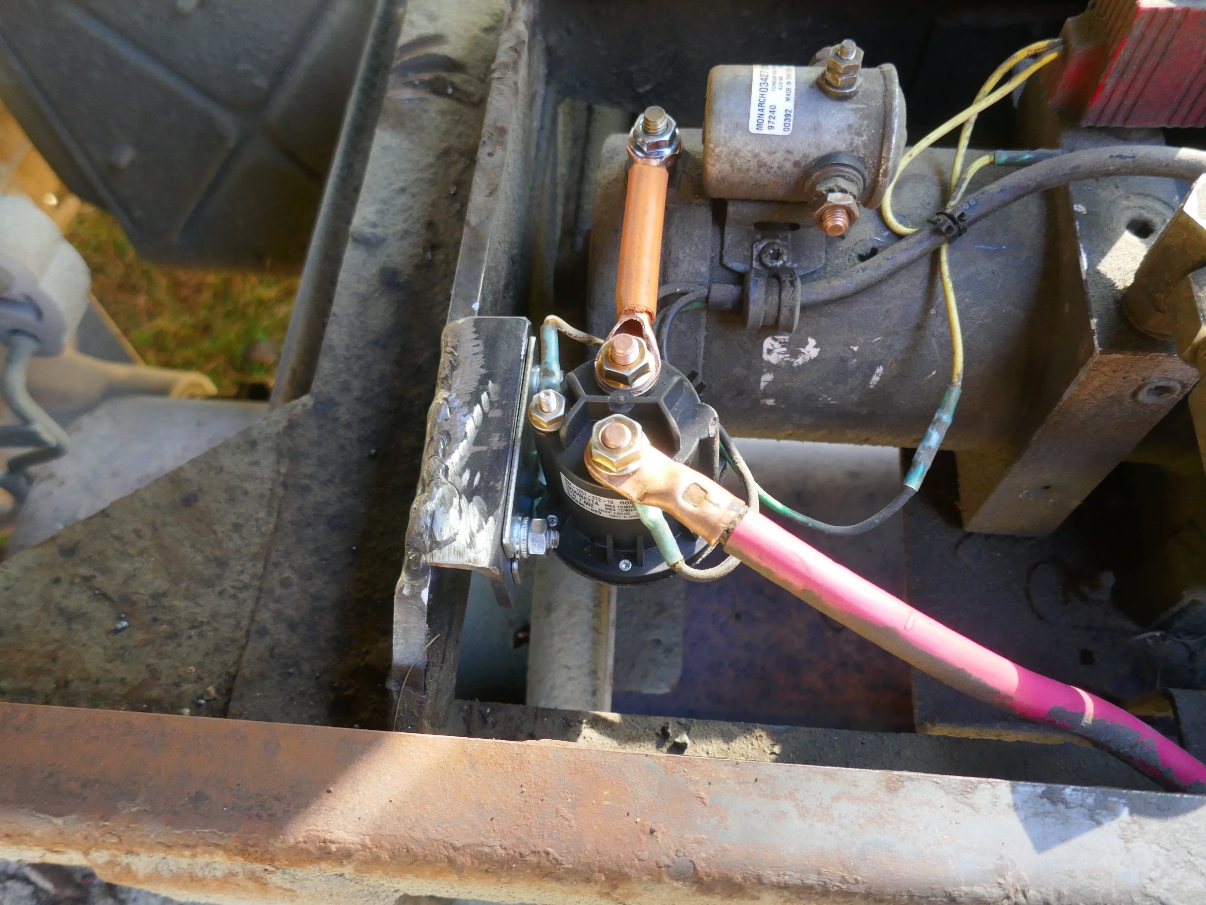

The solenoid switch on my truck's dump body lift became intermittent. Last week I replaced it. Made a bracket and welded onto the lift assembly.
Then mounted the new solenoid and changed over the wiring.

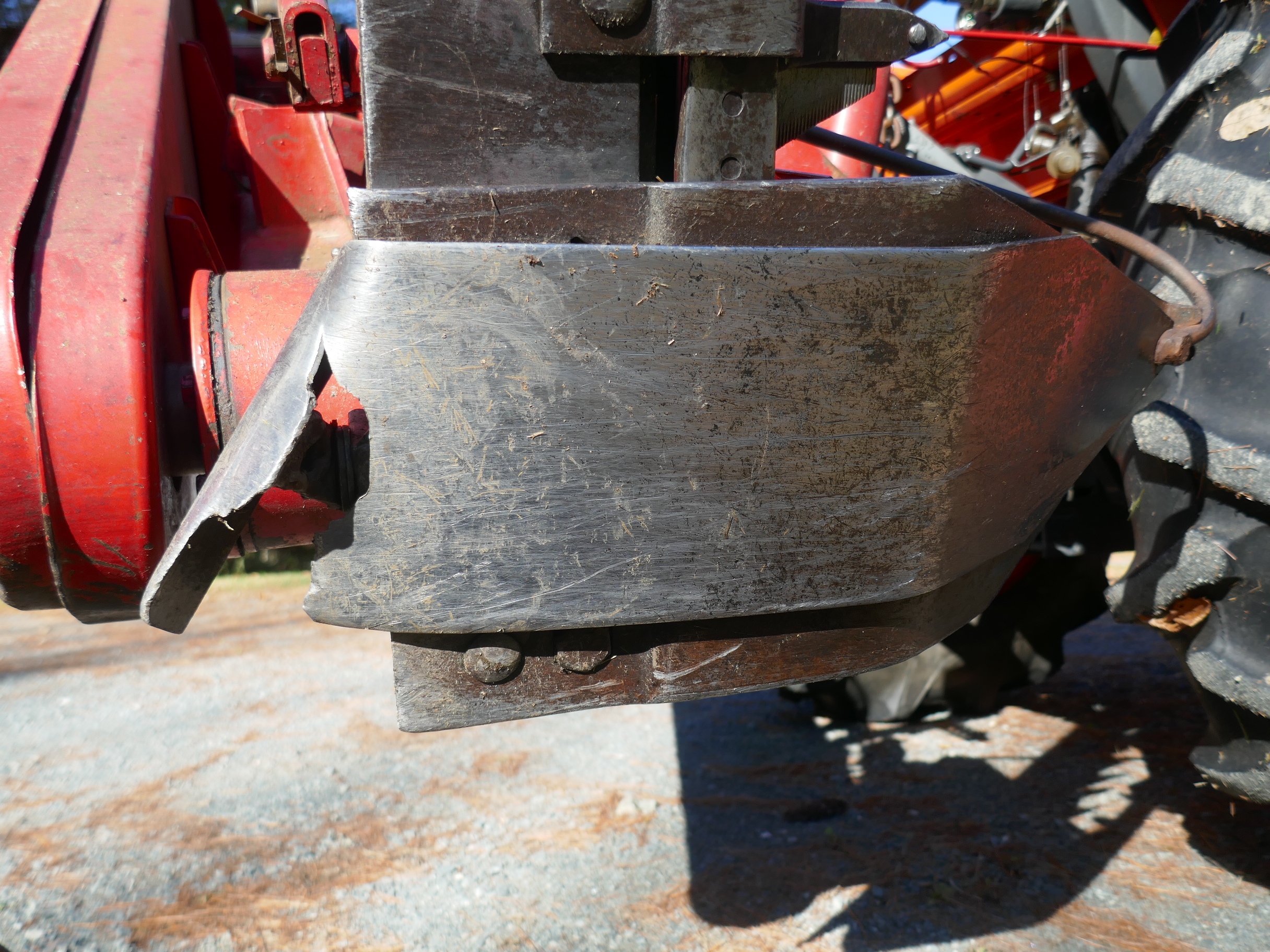

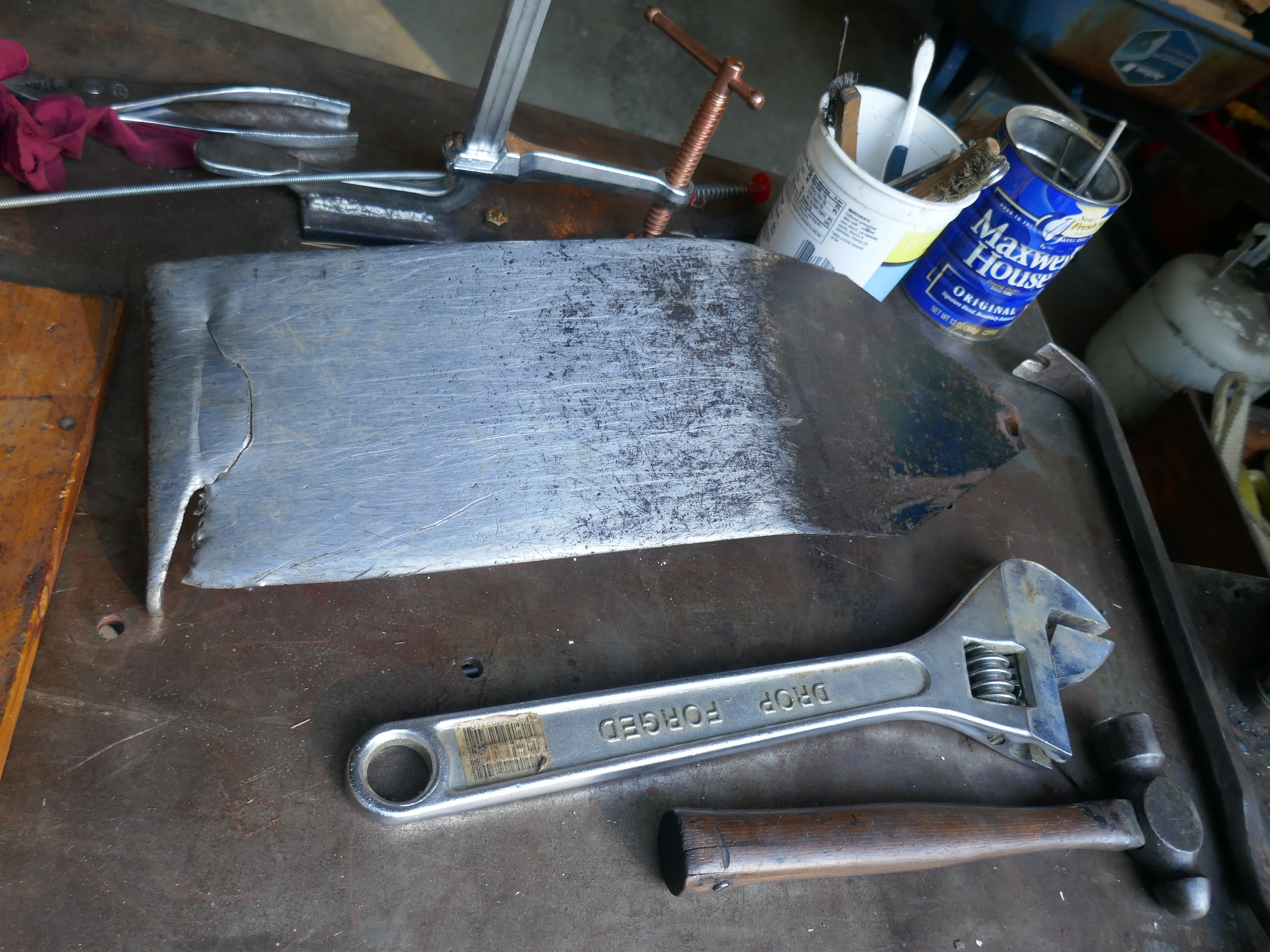

This week I have been finishing up my fall mowing with the sickle bar. Yesterday I upturned a flat rock then started leaving a furrow behind me. The mower is 24 years old and apparently I had worn a hole in the skid shoe. The rock hit the hole just right and tore the back corner of the shoe out.
I levered and beat it back to reasonable shape.

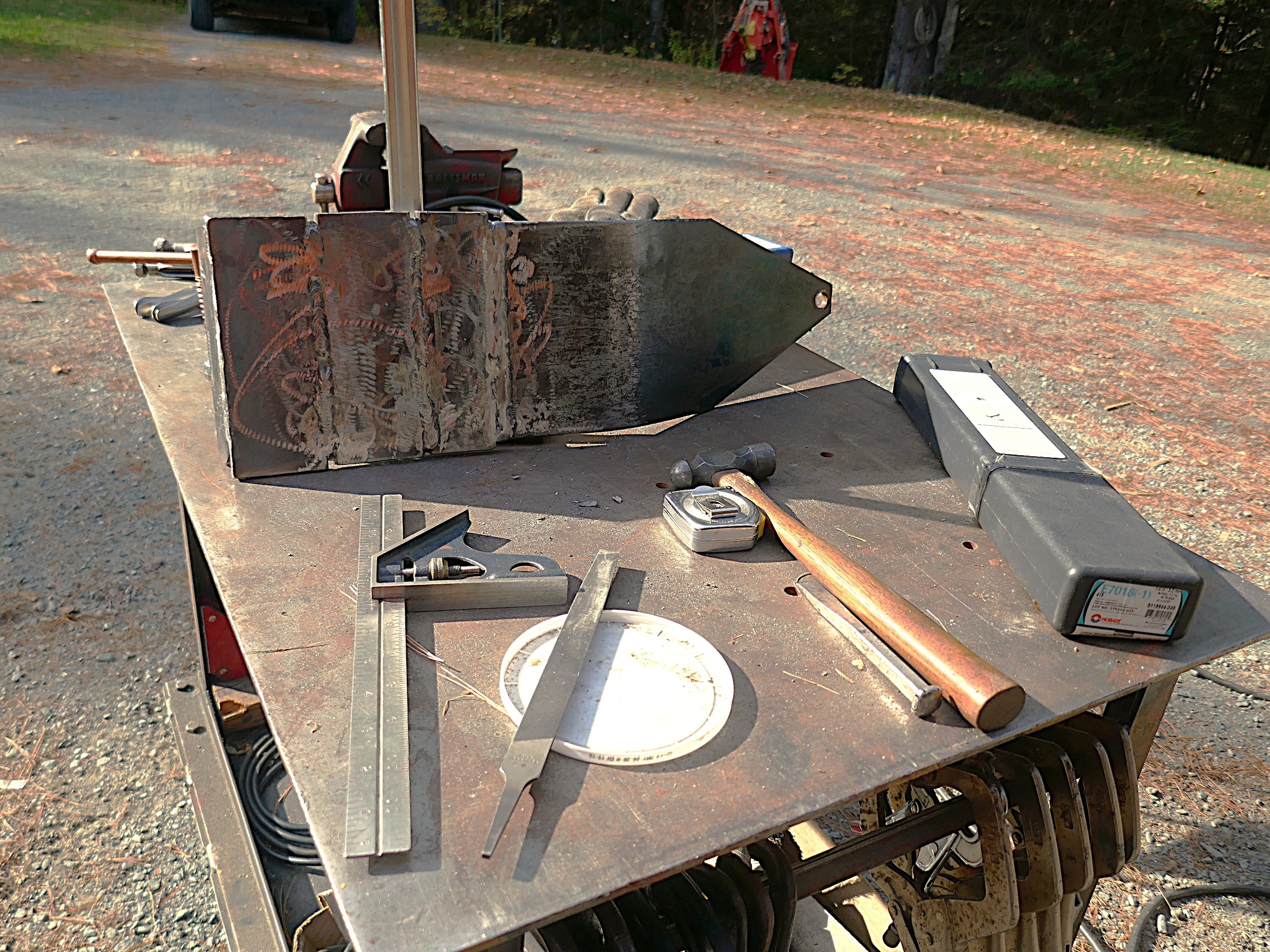

Then scabbed some pieces of flat bar over the thin section. Not pretty back good enough to finish up.
