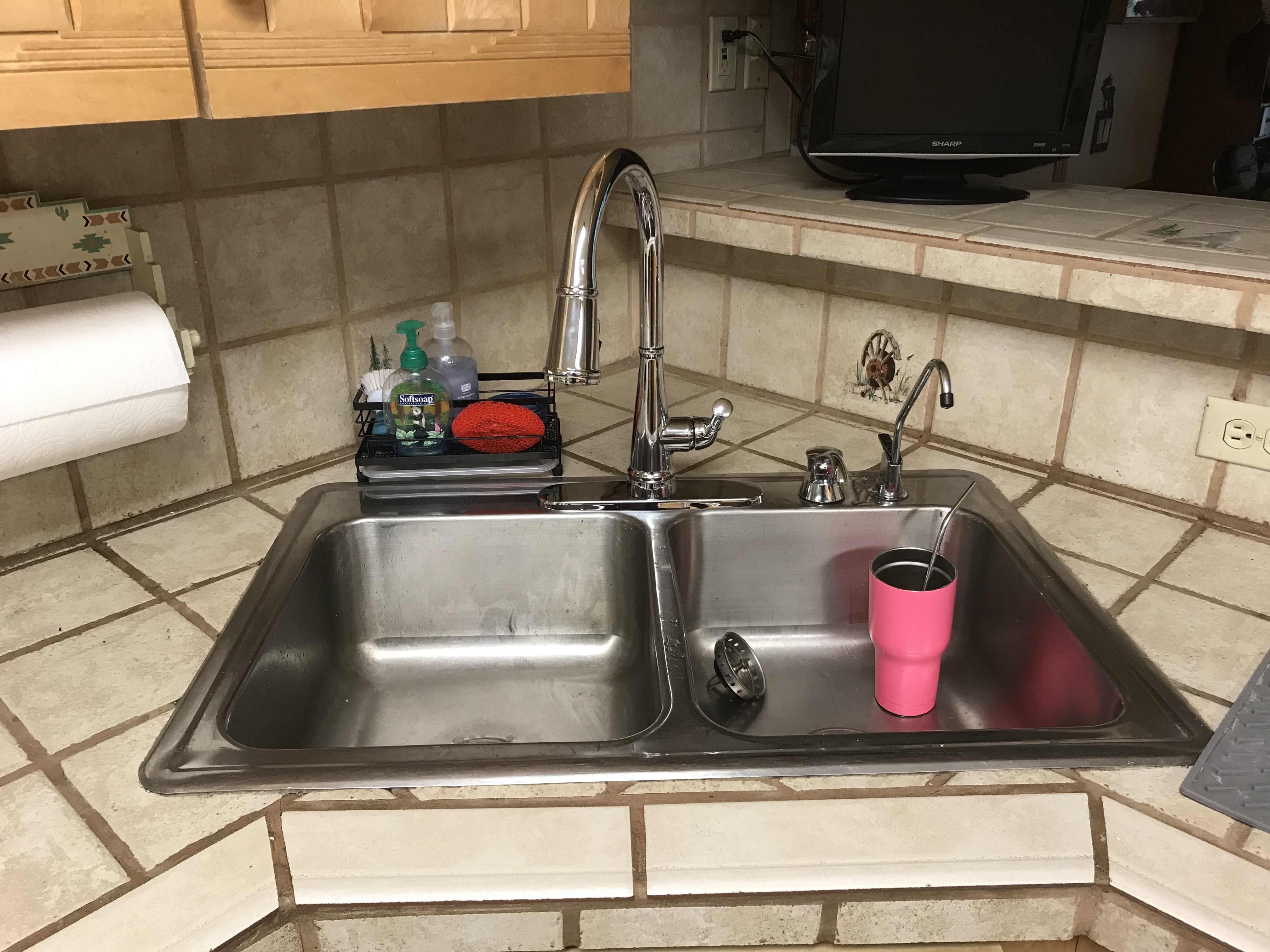

The kitchen sink spray nozzle gave up the ghost. I bought a new kitchen faucet and will be replacing it tomorrow. The better half wants one of those nozzles that pull out of the head instead of what i have. My back is not looking forward to this. Im actually contemplating pulling entire double sink to replace it and not have to crawl upside down into cabinet. And its a corner sink to boot with a single door…… my back hurts thinking about it

Oh Man, I feel you there Grsgreat!! I absolutely hate it whenever I need to work under the sink! Everything hurts and it's such a tight fitment space there is never enough room to turn a wrench completely! Get stuck with baby turns that take twice as long to get anywhere. If pulling the entire sink works better - please advise us!

Im going to yank disposal and all drains then see if i can fit under it. If not….sink gets yanked.

Is that sink caulked to the countertop? I’ve damaged a couple trying to pry them loose.

I replaced the faucet on a deep utility room type sink a few years ago. I somehow got the old one out and realized it was just easier to pull the sink to out the new one in. I’d pull the sink if I were you.

Oh well, i was able to replace faucet without pulling sink. I guess im not as fat as i thought. When we were shopping for faucet i asked the wife if she wanted a new sink basin….she said no. She liked the sink.
Now thats its all done, she wonders why i didnt replace the sink.
I need a drink.

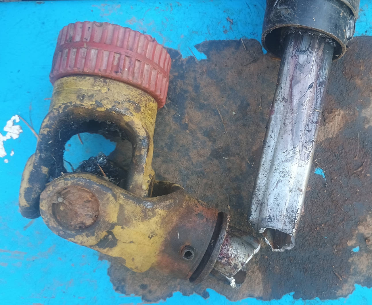

You must have found something solid !
gg
   / What did you BREAK this week? #113
Im surprised there wasnt a shear pin somewheres
   / What did you BREAK this week? #114
A shear SHAFT?
The weak link in the system, at least I thought, is a belt drive on the flail mower which has always caused me problems. And I have had the belt smoking from time to time.
Mowing hard with a really old flail mower. I did hit a couple of pieces of woven wire, but that was quite a bit before the shaft sheared.
It isn't shown in the photo, but the shaft is also twisted. That could have also impacted the break. When the implement is down the shaft is longer (and likely when it twisted). Then when it is raised it shortens, and likely got bound up.
That is a second hand PTO shaft that I bought, and when I initially installed it, I discovered the first few inches were twisted, which I cut off and reassembled. But I now know it was a bad sign from the start.
I'll have to experiment with it a bit more, but that appears to be a rather cheap mild steel. I also have a feeling it was designed for lower HP. My Landini is tiny, but it packs 50 to 60 HP.

Good job Grs, and isn't that just the way it always goes? Wifey says no it's fine and then why didn't you change it?!! Ha Ha I can relate to that perfectly!!
