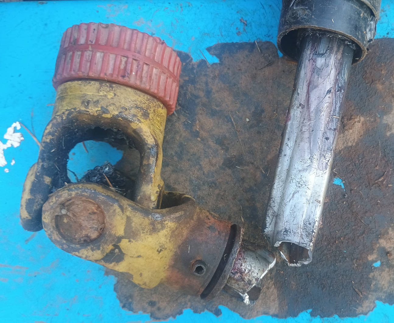

A shear SHAFT?
The weak link in the system, at least I thought, is a belt drive on the flail mower which has always caused me problems. And I have had the belt smoking from time to time.
Mowing hard with a really old flail mower. I did hit a couple of pieces of woven wire, but that was quite a bit before the shaft sheared.
It isn't shown in the photo, but the shaft is also twisted. That could have also impacted the break. When the implement is down the shaft is longer (and likely when it twisted). Then when it is raised it shortens, and likely got bound up.
That is a second hand PTO shaft that I bought, and when I initially installed it, I discovered the first few inches were twisted, which I cut off and reassembled. But I now know it was a bad sign from the start.
I'll have to experiment with it a bit more, but that appears to be a rather cheap mild steel. I also have a feeling it was designed for lower HP. My Landini is tiny, but it packs 50 to 60 HP.

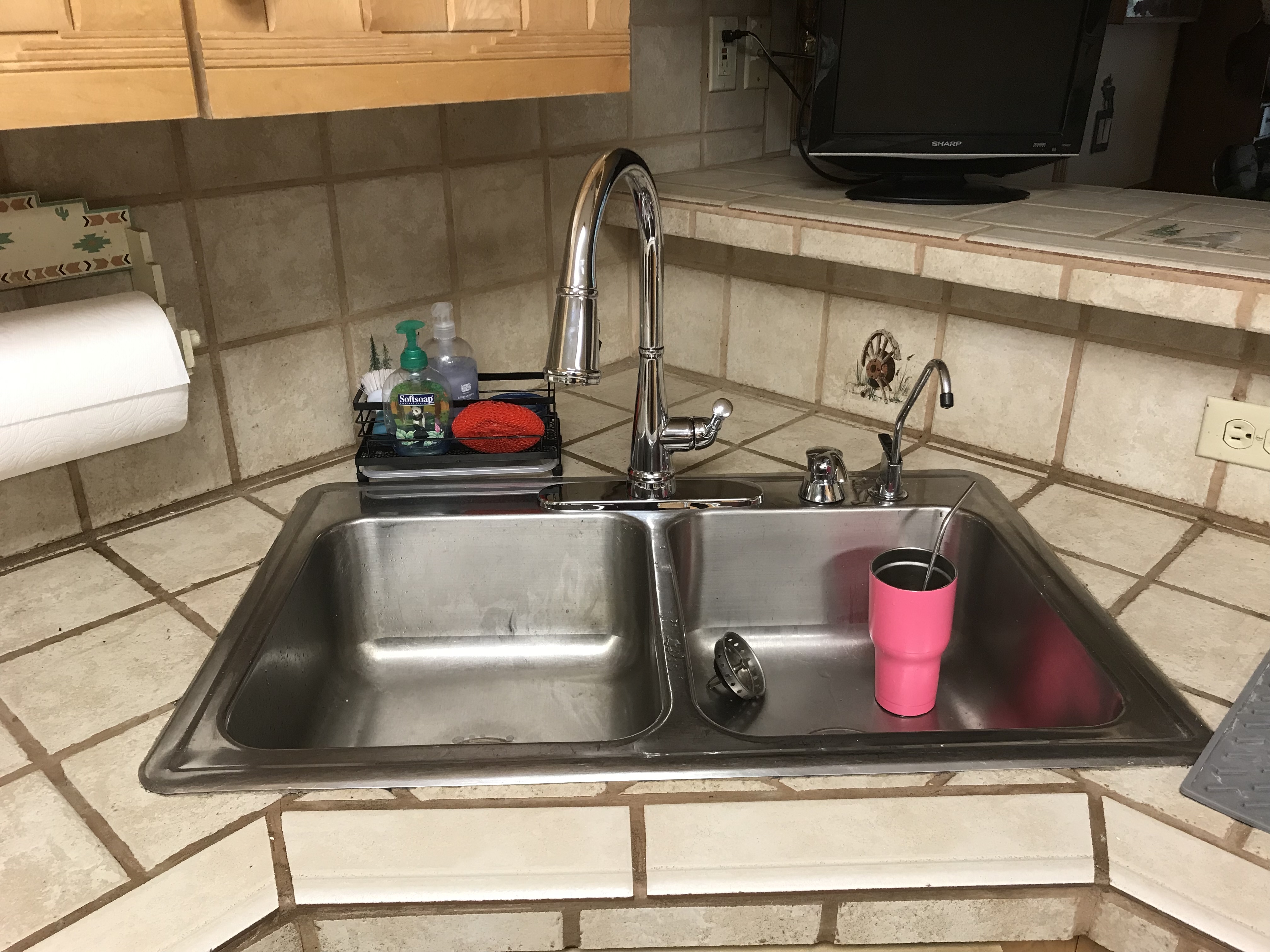

Oh well, i was able to replace faucet without pulling sink. I guess im not as fat as i thought. When we were shopping for faucet i asked the wife if she wanted a new sink basin….she said no. She liked the sink.
Now thats its all done, she wonders why i didnt replace the sink.
I need a drink.
Good job Grs, and isn't that just the way it always goes? Wifey says no it's fine and then why didn't you change it?!! Ha Ha I can relate to that perfectly!!
